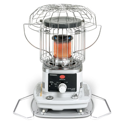

I have one of these Kerosun heaters that I fire up. Then I put it up by the radiator. After that I drape some plywood and an old piece of carpet above the heater and over the hood of the tractor. That collects most of the heat around the engine which makes it a lot easier to start for me.
