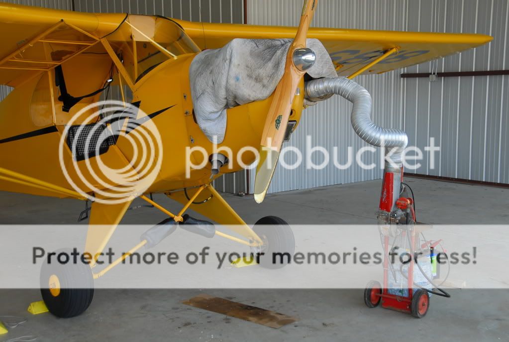

Would not a propane weed killer firing into a length of stove pipe with a 90 pointing up to the block act like a 'field salamander'? Similar, more expensive units, are used to pre-heat aircraft.

We have had a set up called the life line. Its a generator, battery charger and slamander all in a cart. Pull it towards the "patient", place components accordingly, let it run for an hour, and come back to start up. Started all of the snow equipment for over 20 years like this. Usually it was me doing the start up while my father and his guys came in to work.
