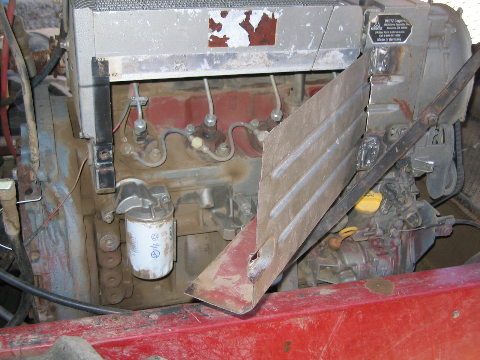

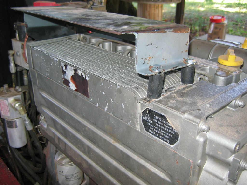

I do not feel that removing the deflector is a good idea, but I do feel that you can raise it and loose 10 degrees (that is what I feel mine did).
I carefully removed the 4 oil cooler bolts (Do not bump the cooler or you are going to get an oil leak). I got longer bolts and then cut some pipe to create riser sleeves. I think they are 2" max height and I made the ones in to the inside of the engine shorter than the outside. On the one side (not in the pictures) I just drilled a new hole and applies only one bolt through the shield.
A bit of air goes around this rig, but most is still pushed out the side of the tractor. For me it has kept the engine much cooler.
Heck with it, here are some pictures.

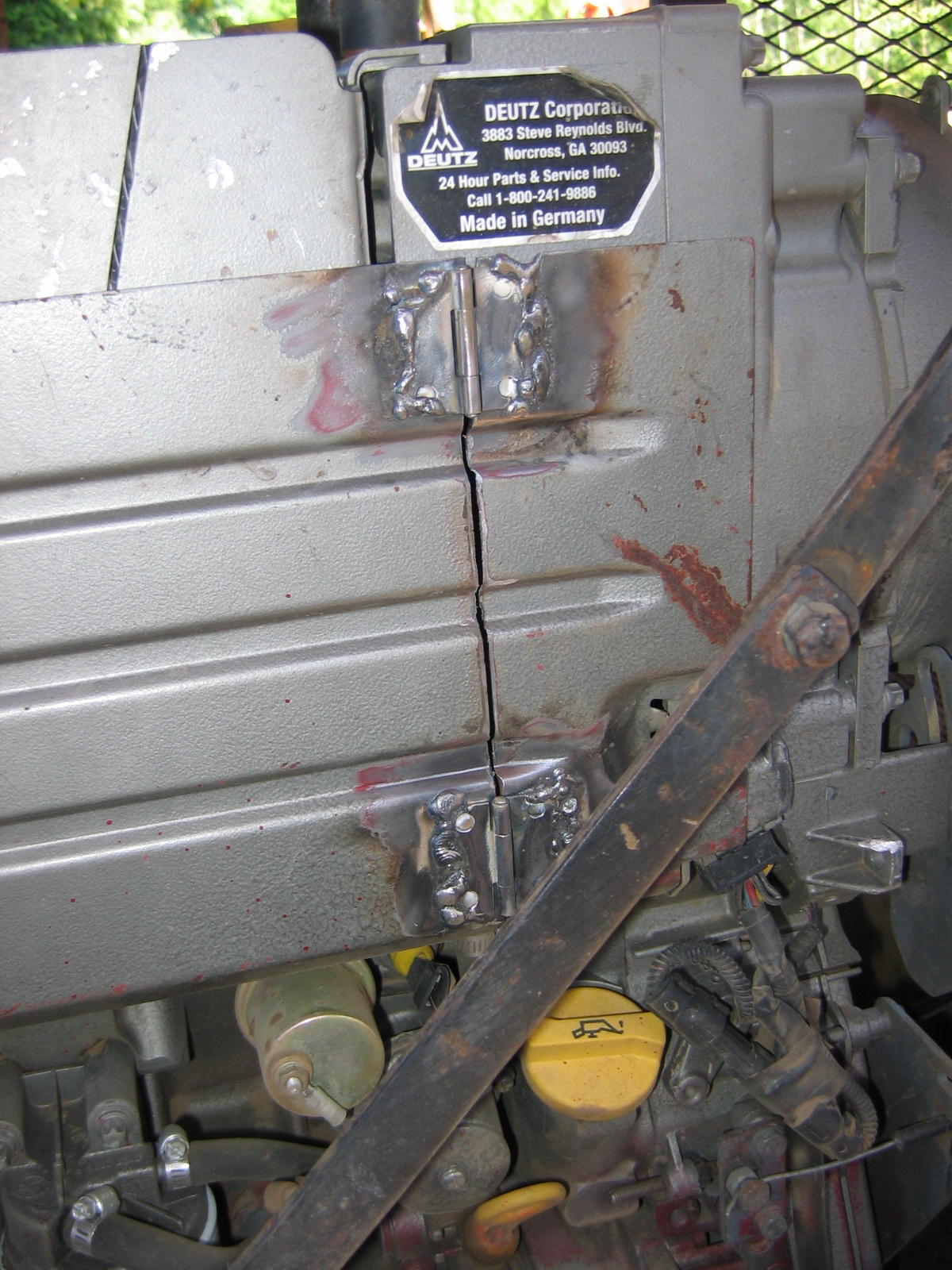

your temps all seem right on and having run this for a few years I don't feel that there is need for additional cooling unless you are in super dusty conditions and need to run for a long time. There is a huge need for an oil level meter that sounds a warning for the hydro tank. That for me is the big weak link is it is hard to detect a hydraulic oil leak when operating and only becomes apparent when the tractor stops and smoke comes out from under the hood. There is no alarm or guage and that is a big failure point for my and my PT.
Also, cut your side panel and weld hinges on, makes the cleaning process much easier but don't do a bad job like me. (watch for your lid holder, it cause me problems on this mod, some people moved theres to the other side which would be smart)
Side panel idea is really good. My PT is a little tighter, and I don't even have the ability to raise the deflector 2", as it would hit the oil cooler. The deflector is probably about 1 1/2" away, so it restricts the flow of both oil coolers, lol. I may try to remove it and see what happens.

Yeah I realized that the deflector is a PT part, not a Deutz part. The only drawback I see is that taking it off may affect the hydraulic oil temp. It will definitely help the engine temp, as it is restricive. Although it directs the heat toward the side, it doesn't exhaust it all the way. I'll bet that most of that heat is getting sucked through the top anyway.

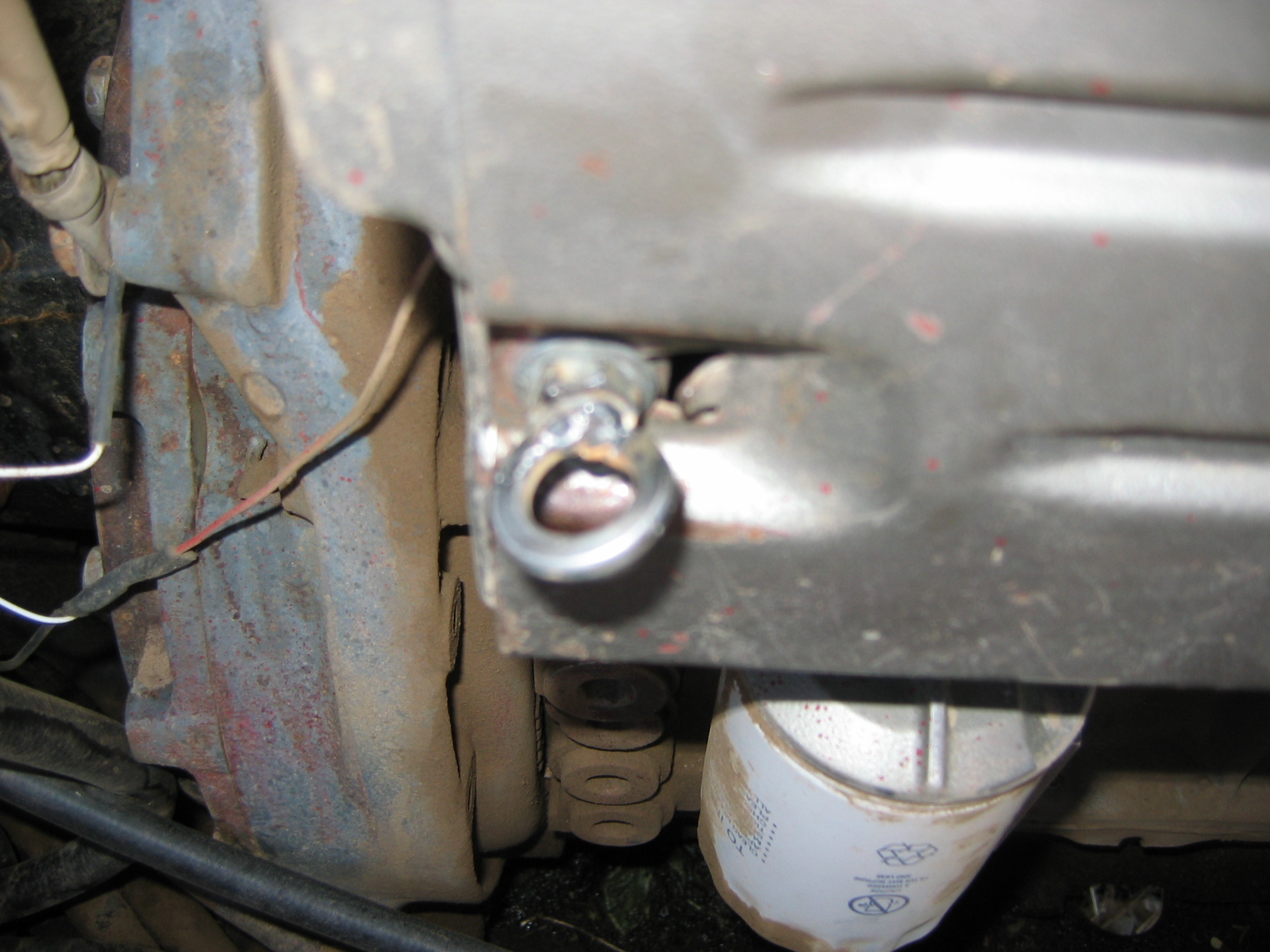

The lower cover comes off so fast, that I don't see myself adding hinges. Just two bolts and a 13 mm wrench - maybe takes a minute.

There is a ton of real-estate in that top cooler and I don't think that adding the engine heat will be much of a change, other than it WILL increase the general heat under the hood. Again i don't think by a significant amount.
But for sure that deflector that PT has is very restrictive. And probably the whole Deutz series by PT suffers from the restrictive nature of that deflector.
As for the side door, I didn't like taking off both bolts. I found myself less likely to properly blow out the engine when I had to remove both of the bolts.

Instead of putting hinges on the motor, I would rather fabricate some sort of toolbox on the PT somewhere. I could then keep my 13 mm wrench on board, as well as some other handy tools, including a chainsaw scrench, and some rags. I also like to keep PT Blaster, to blow out the dirt out of the hydraulic fittings before connecting them. A pair of gloves on board would be nice as well.
