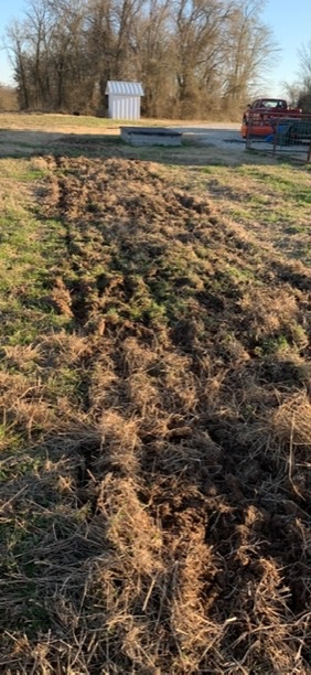

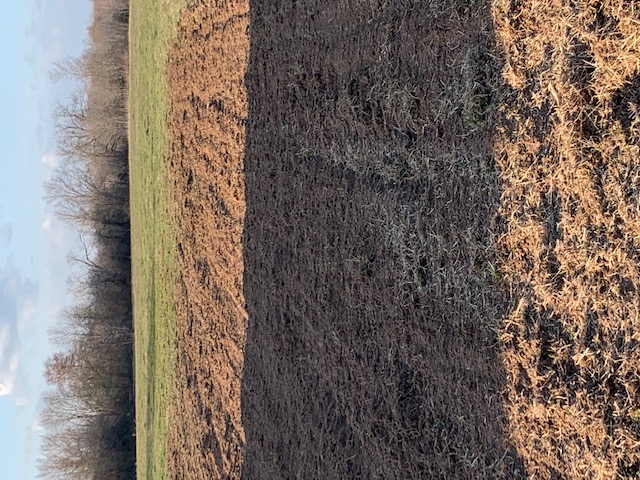

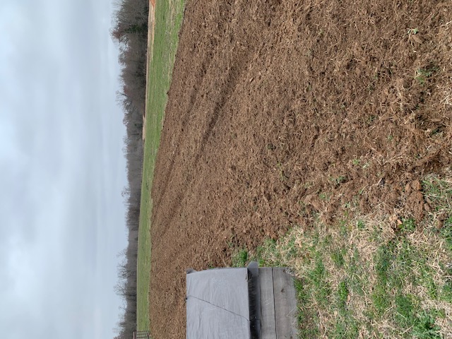

Okey Doke. . .:cool2::cool2::cool2: I got to it today. Lots to say, so I will number them.
1) I made a lot of passes and WOW it did Very Well, as you can see in the pics. So, I think I am good to go with this DH. With my sandy-loam soil, I don't believe I need to plow.
2) I was under the assumption (Stupid me to "assume") that the 3pt would force the DH down into the ground. After making numerous passes, I saw how the DH began going in deeper.
3) When I start discing the all my pastures and my neighbor's pastures, I will want the first pass to take more of a bite which means adding weight to the top of the DH. Which brings me to one of my questions. . . I need to know what, and especially how to attach some weight to my DH. I have read 3 or 4 responses that talk about y'all putting weight in one form or another. I know what is heavy, I just don't know how to attach it. I am a visual guy, so pictures really work for me.
4) I am planning on discing my pastures and my neighbor's pastures around the last week of February. Prior to that, hopefully in the next week or two, I am planning on getting the weeds sprayed. I had it done in Sept. of 2019, and WOW that made a difference. So, spraying, discing then in late March we will have them sprigged with Bermuda. I would have liked to get it sprayed earlier so I could get the weeds out of the garden, but it is what it is. I plan for the first year, at least, using some landscaping fabric to keep the weeds at bay.
5) I think that's it. My main thing is preparing for the big discing project of 14 acres. I need to know how to put weight on top of the DH to make that first pass worthwhile.

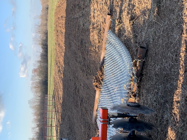

6) The pics below. .. The second being my garden disced with some furrows from the outer discs. The first pic is a close up after a drug the chain harrow over it. The third is a brief shot of my chain harrow behind the DH.
Thanks a bunch. . .

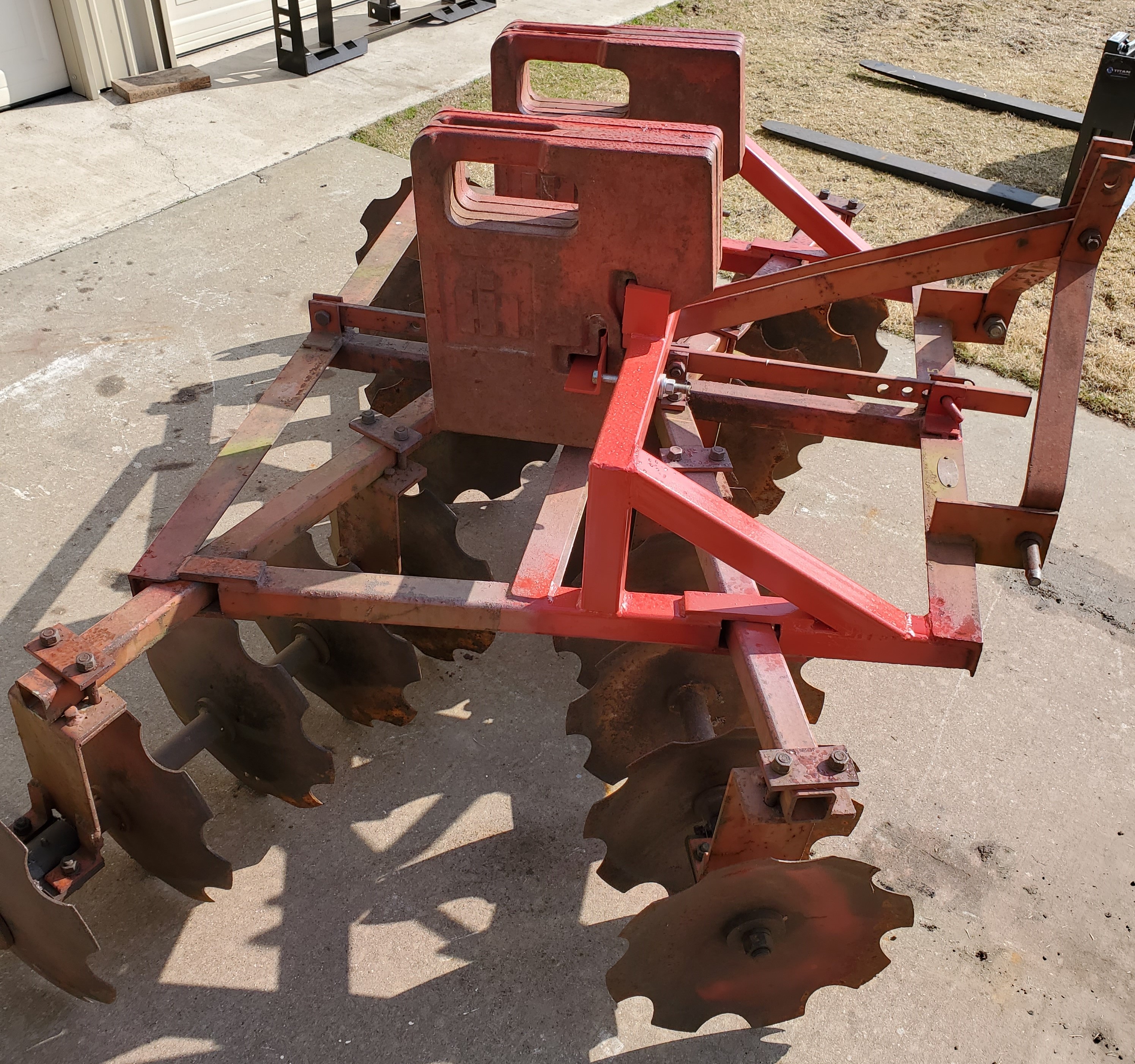

I recently bought this old disk for food plots near term and our future large garden. I then bought some old weights and made a weight bracket out of scraps for them. I tried it out in the backyard this weekend but it was too muddy to really judge. The disk weighs 515lbs plus each weight is about 107lbs.
That looks like the same 3-point disk I have. It did not work for squat until I added some weights to it. I used threaded rod to bolt (2) 100 pound plates with my larger tractor and it cuts real good with those on it. Not quite as good with just 1 plate on it but that is all my smaller older tractor will lift.
That little, weighted 3-point disk is handy on spots under a couple acres, but I much prefer pull-type disks for larger areas. The disk is one of the few implements that works better without a 3 point hitch.
