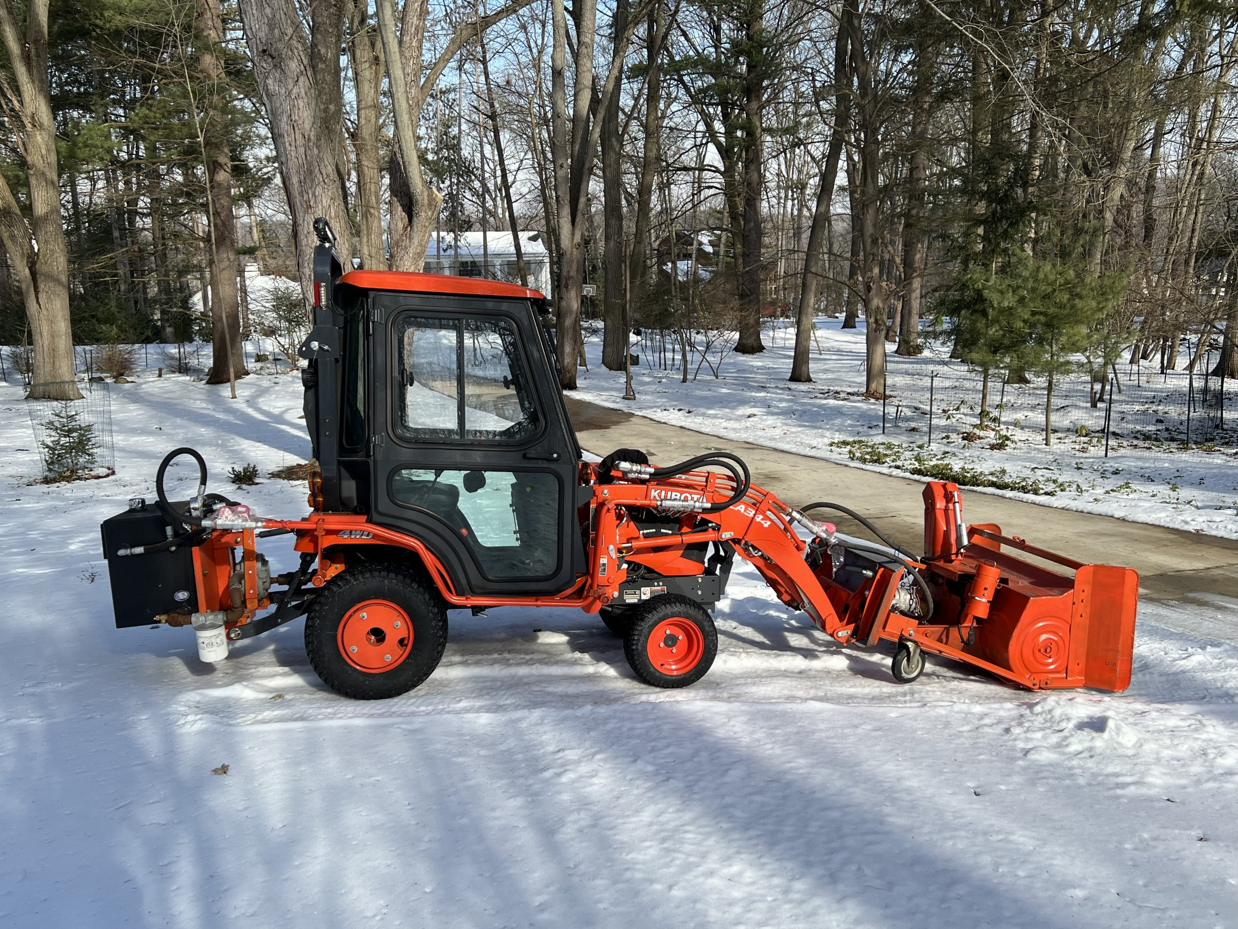

   / How far and high can I throw snow? #26
Customized a rebuild to be hydraulic powered from rear unit. Commercial units for skidsteers are available. Key to throwing long distance is tip velocity of impeller and impeller spacing( slip space) Set my system up to be able to spin fast. I have an up to 20 gal / min pump. I lined my blower impeller and chute with slipper plastic ( UHMWPE) https://en.wikipedia.org/wiki/Ultra-high-molecular-weight_polyethylene. Nearly 50 feet for wet-heavy-but-not-slush snow.
( loved visiting AK except for swimming)
