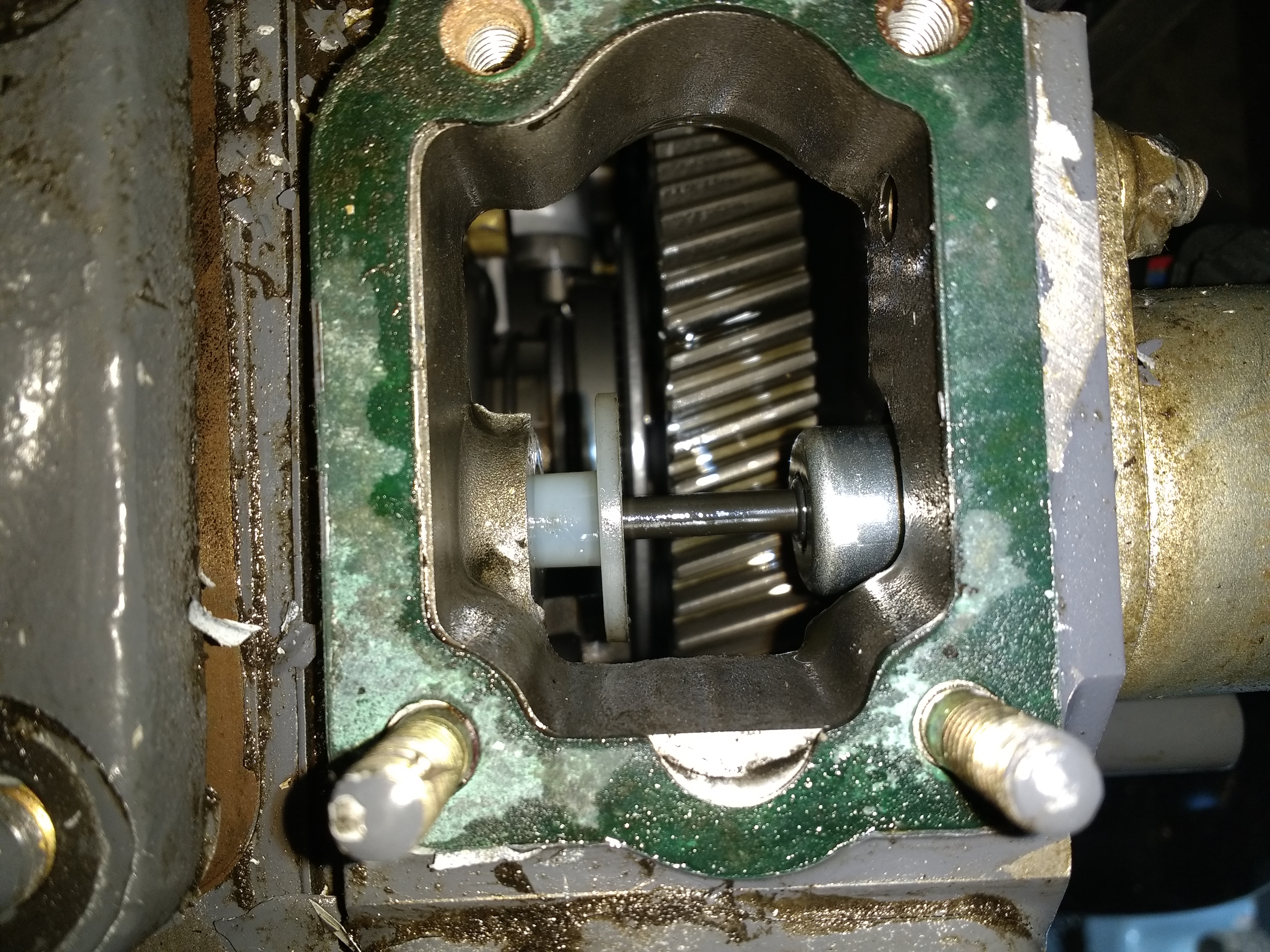

This photo shows the view into the engine with the stop lever plate removed. The white plastic thing is the guide. The SS is on the right and the SS plunger pokes into the guide. The guide is pushed out (as seen here) by the injection pump rack as it moves forward (more fuel injected) providing the SS plunger is retracted.

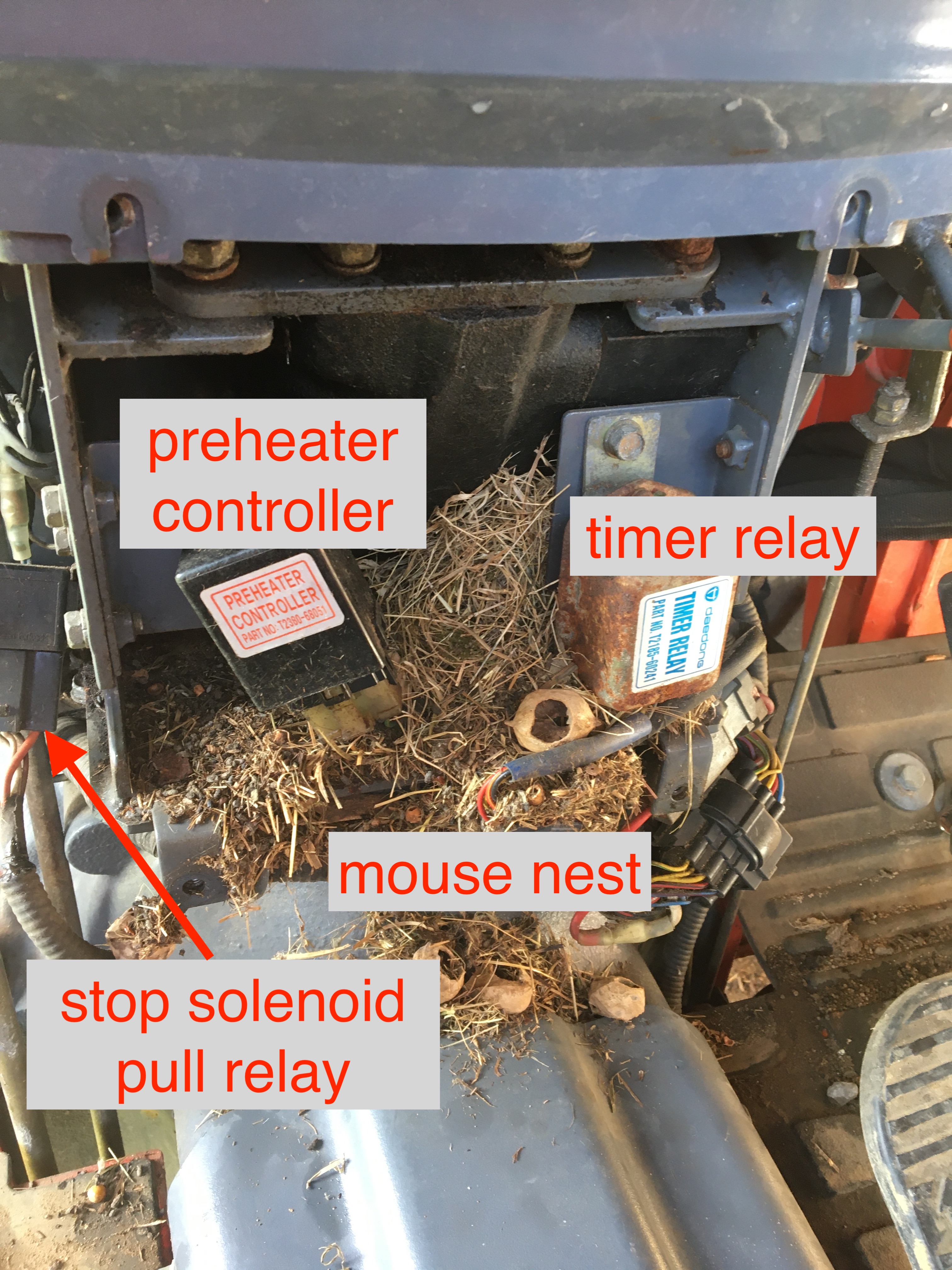

Here's what I'm looking at:

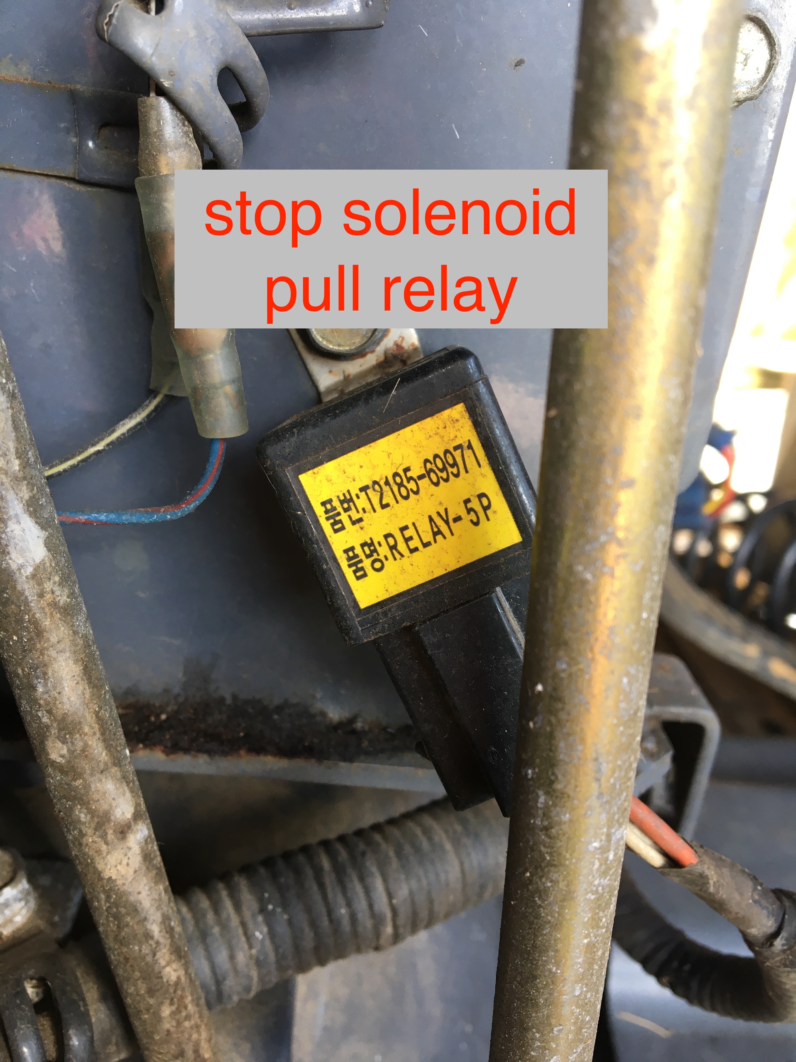

This is the stop solenoid "pull" relay I think:
(There are more relays along the top; not shown in the pics.)

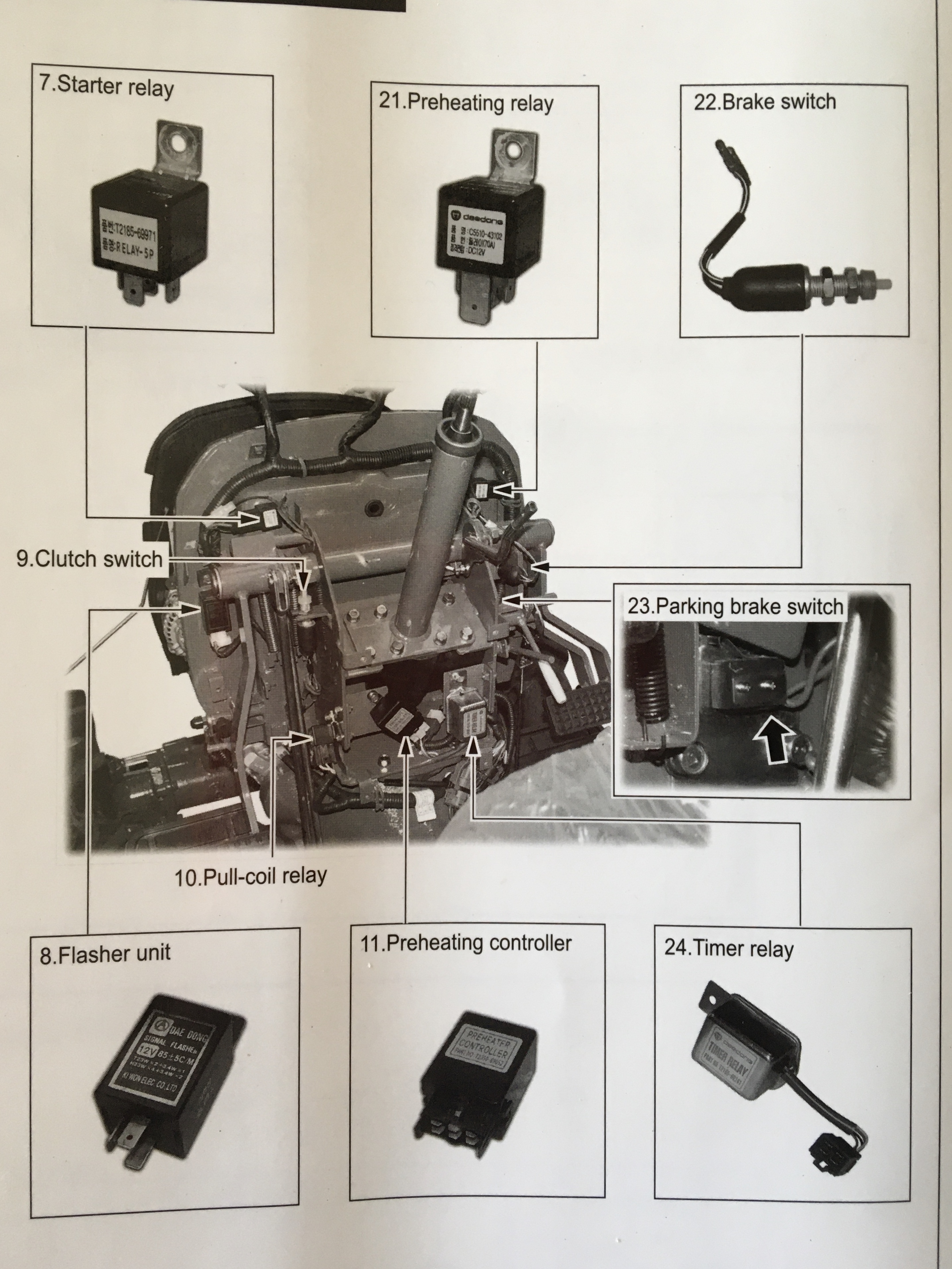

And here's a diagram for a ck20s workshop manual:
I'm going go look for a part compatible with T2185-69971 now.

I suspect the only available CK20S service manuals show the previous version. That's the situation with my DK45s. But (in my case) the EX45 manual does show my engine, although nothing else in the EX manual applies to my tractor.
Often, the online parts manuals (which tend to be updated) are better information sources. This one may appears to show the correct parts locations for your machine.

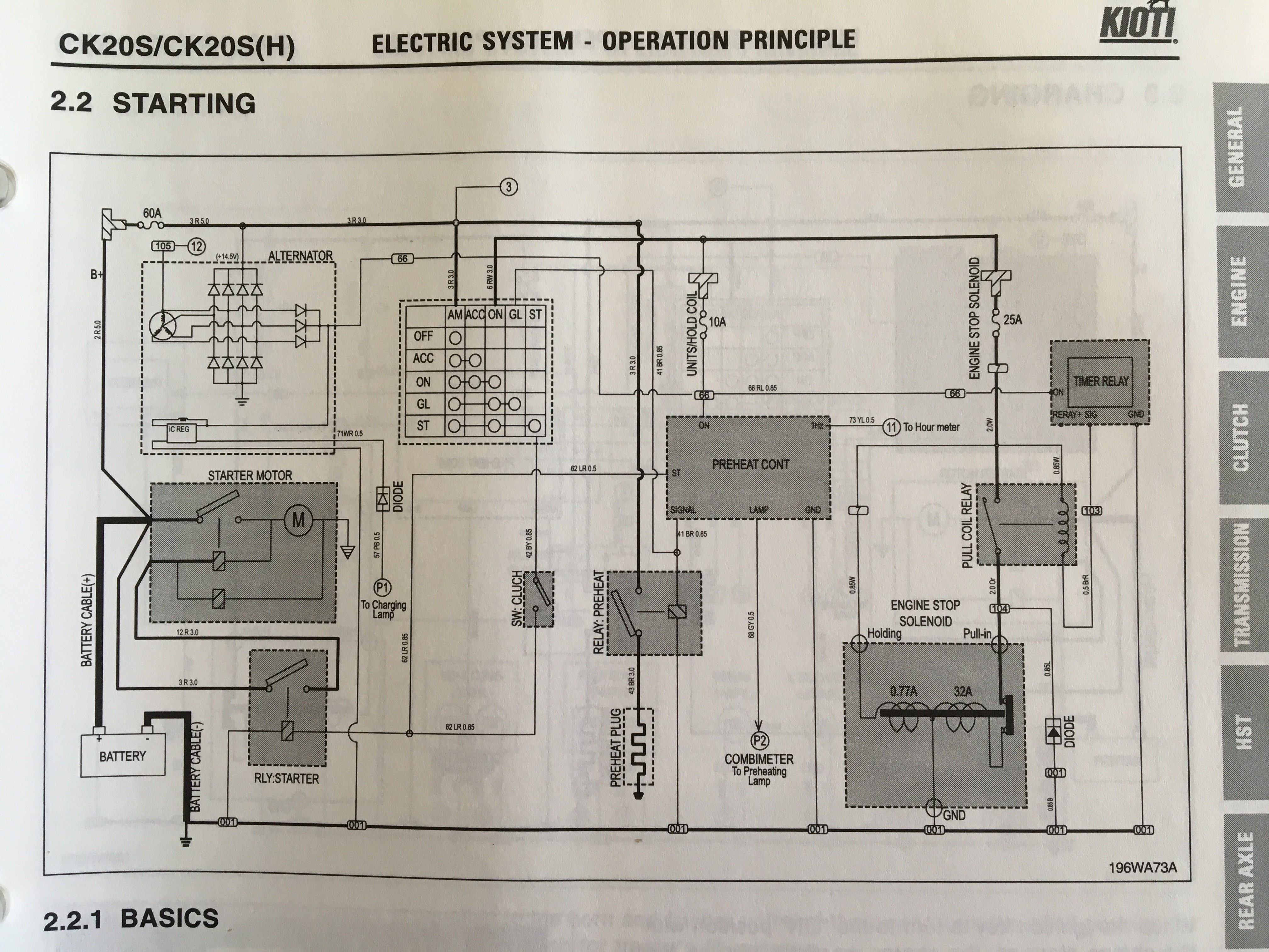

I think either #16 or #20 relay (in parts diagram) is the SS pull relay and the other is the starter relay. I also suspect the timer relay generates the 1 sec 12v pulse to activate the SS relay. I don't have a schematic so I can't be sure.
First, verify you have found the SS relay. Pull off the connector and make sure the 12v pulse you observed is gone but the engine still cranks. Then substitute another relay, either a new relay or the start relay.

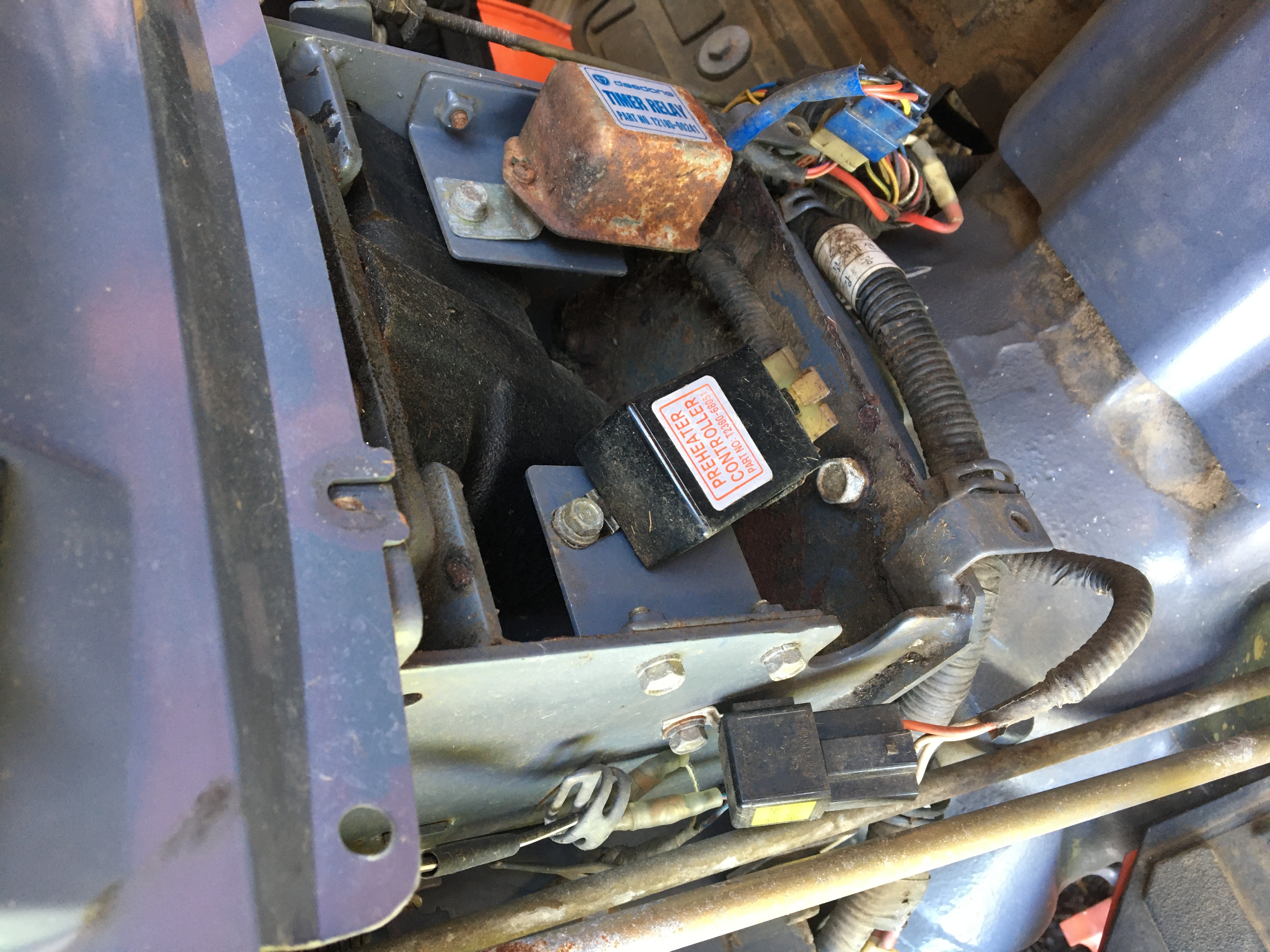

The engine diagram is from a CK20S(H) workshop manual and does seem to match what's on my firewall. Here's another pic after a bit of rodent cleanup:
I pulled off the connector on the T2185-69971 "pull" relay (the black one on the far left in the above pic). No longer seeing a 1s pulse between R&B at the SS. Still seeing 12v constant with key on between W&B as expected I think.
Here's a schematic of the electrical starting system from the same workshop manual:
Absent any recommendations for relays compatible with T2185-69971 from auto parts stores, I'll order one (or two) from MIE.

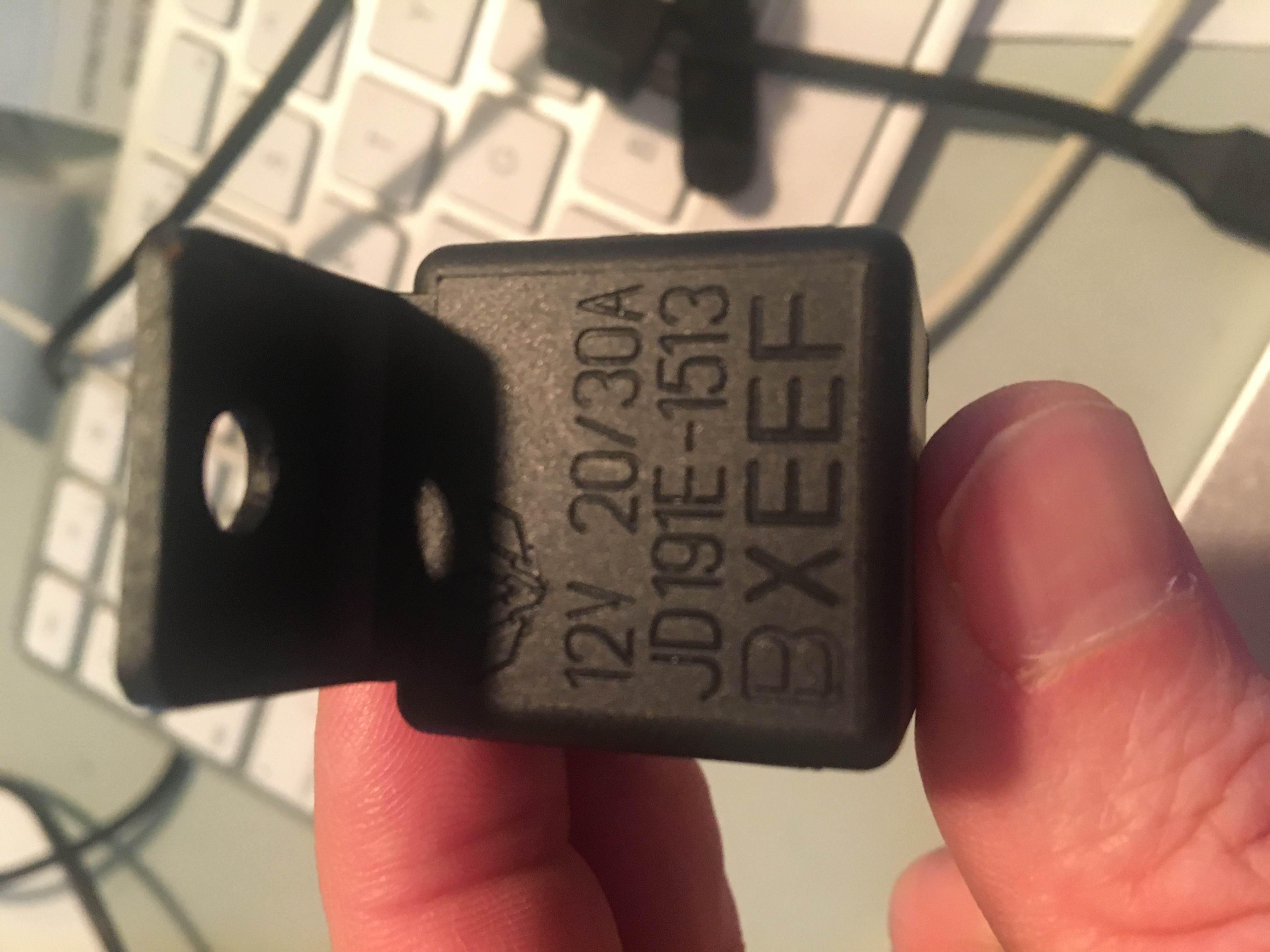

I did this and got a replacement which has all the pins labelled the same and is 30A:
However, with that new relay, there's no pulse at all! (Recall, the old relay showed a pulse but the suspicion was that its contacts are bad and not able to carry enough current to set the SS.)

I think I'd start by making sure the new relay was OK. Unplug the connector from the starter relay and plug the new relay into that lose connector. Then check if the starter cranks. If not, you got a bad relay.
You can also unbolt the known-good starter relay and plug it into the SS relay connector to verify the problem is not the SS relay
If the new relay checks out OK, and the starter relay doesn't "pull" the SS, I'd go back to the beginning. Do you have a volt meter? If so, use the schematic you included in post #17 and start by ensuring the SS fuse is really good. Verify 12v power gets to the "hot" input contact of the SS relay whenever the key is ON. The contacts should have the bigger wires and you should be able to slide a meter probe into the back of the connector to take measurements. You'll need a helper to turn the key as you use the meter to verify power gets to the output SS relay contact briefly after the key is turned on. See if you can feel or hear the relay activate and deactivate when the key is turned to ON (easiest if relay not mounted. In short, just follow each "link" in the electrical chain to see where the problem is.
