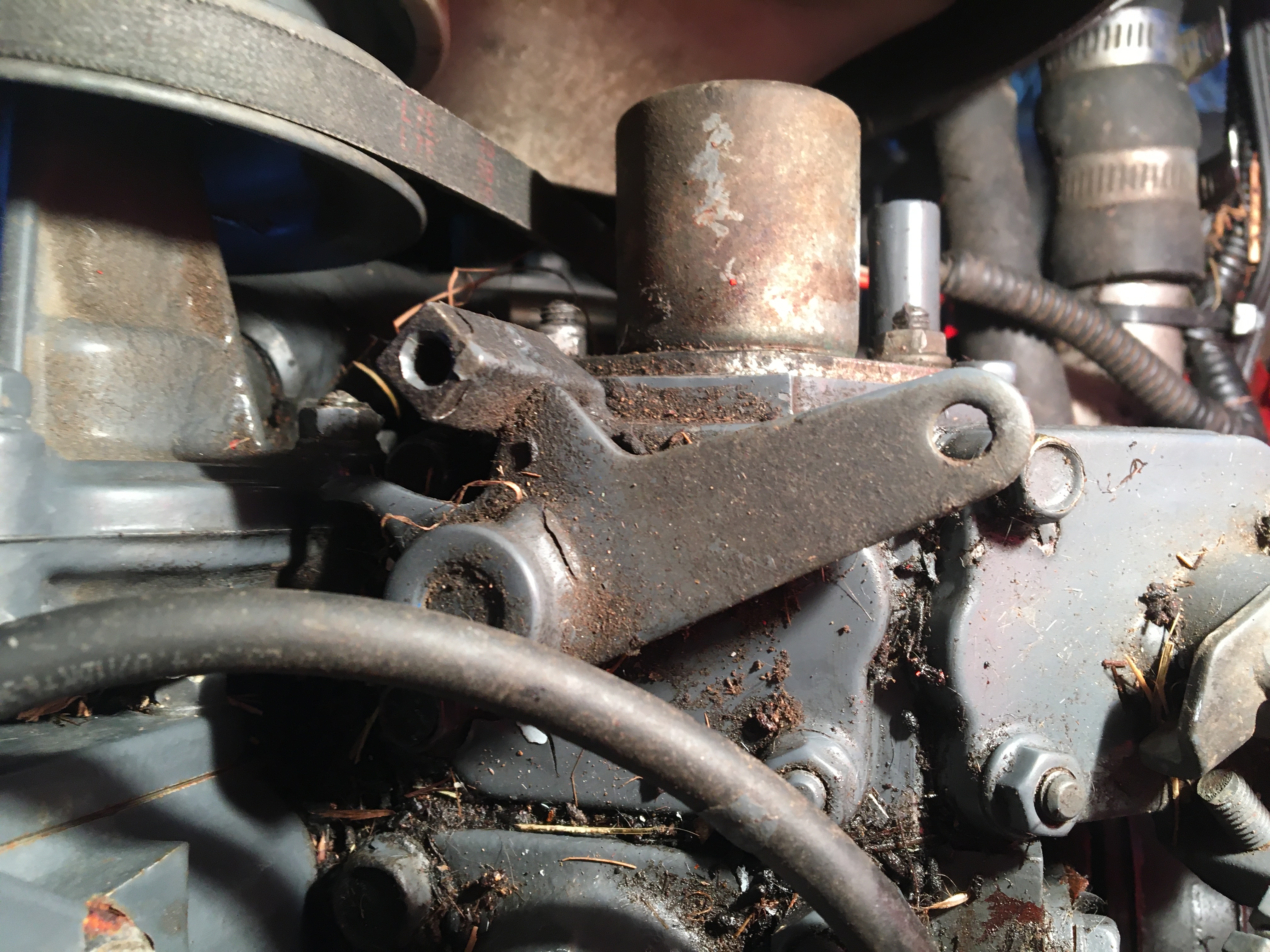

Thanks, but I don't think I have a solenoid cable! There's never been a cable there, but I bought the thing 2nd hand five years ago. There is a linkage right above it, next to the fuel injector, but it's not connected to anything and it moves freely. I'll send a pic in the morning.

I think you have the second version where the stop solenoid (SS) bolts to the front of the engine with no external linkages. In this version, the SS plunger is spring-loaded to the extend position which pushes the injection pump rack to the full-off (zero fuel) position. The SS must be retracted before the injection pump can deliver fuel for the engine to start or run.
The SS has two coils: the high current "pull" coil that gets a short pulse to retract the plunger against spring force and the low-current "hold" coil keeps the plunger retracted as long as the key is ON. The pull coil is powered through the stop relay. The hold coil is powered directly from the key switch.
Can you hear the "clack" of the SS retracting when the key is switched from off to on? If not, the solenoid is not retracting. That could be electrical (fuse or stop relay) or the actual SS.
If the SS clacks when you turn the key on, see if it clacks again when you turn the key off. If not, the "hold" isn't working and the SS doesn't stay retracted. If the SS retracts but doesn't stay retracted the most likely cause is the key switch. The contacts in the switch often become unreliable because of corrosion, dirt, and dry grease. Squirt WD-40 in the key hole and cycle the switch several times. This is good annual maintenance regardless.
   / how does the injector solenoid work on a CK20S?
Yes, I have a linkage arm that moves freely, but no cable. Pic attached.
The SS is energized (see first post) correctly I think. There's no clack though. Gonna pull it this morning and test.
