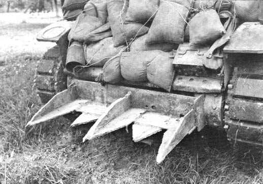

American boys in Normandy had to deal with the same problem; here is your inspiration:)
