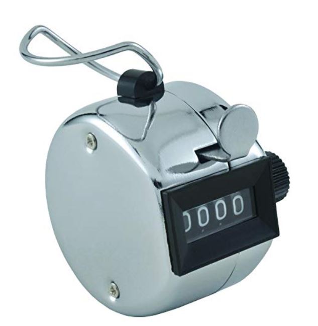

I lift the deck, turn the mower on high and use one of those handheld counters like this.
Man that thing is fast.
Thought you meant clocking the speed of the blades. :)
   / How Does Everyone Clock Their Blades? Does It Matter? #9
LOL. Your post got me to re read what I wrote, and my word selection was poor. I meant that the ZD mower blades are not timed with a cogged belt, but Kubota still recommends repositioning them on occasion.
