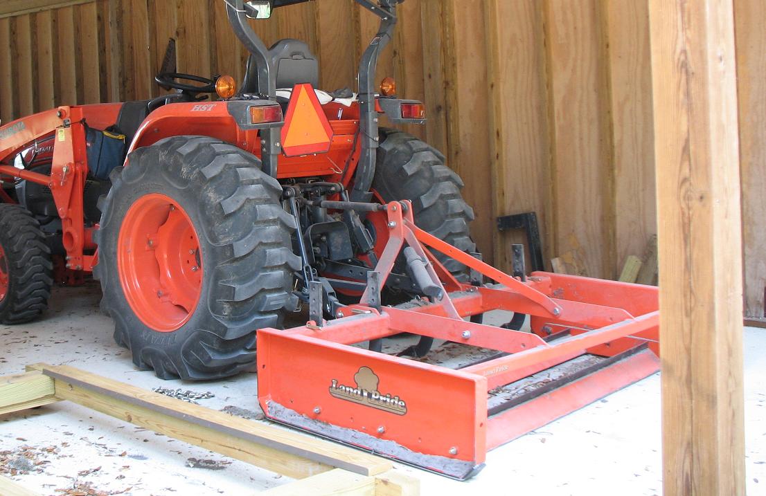

How does that work with a more packed road surface? My road is made up of very packed crusher run. It is hard as a rock. The only way I have found that works at all is to rip it up with the teeth of the box scraper and then smooth it out.

Grading scrapers are similar enough to box blades that if your box blade won't penetrate the material, a grading scraper probably won't either. However, my Land Pride GS1572 grading scraper also has teeth just like a box blade :thumbsup:

SO then what will a grading blade do that a regular box blade can not?

Grader blades are just like box blades and rear blades, the heavier they are the better they work. There is no way that a 6' wide blade of any kind that weighs 500lbs is going to work as well as one that weighs 1000lbs.
A grader blade will remove washboard far better than a box blade, along with cutting high spots down and filling in low areas. Sometimes you should wait for some rain to dampen things down before any grading is even attempted
