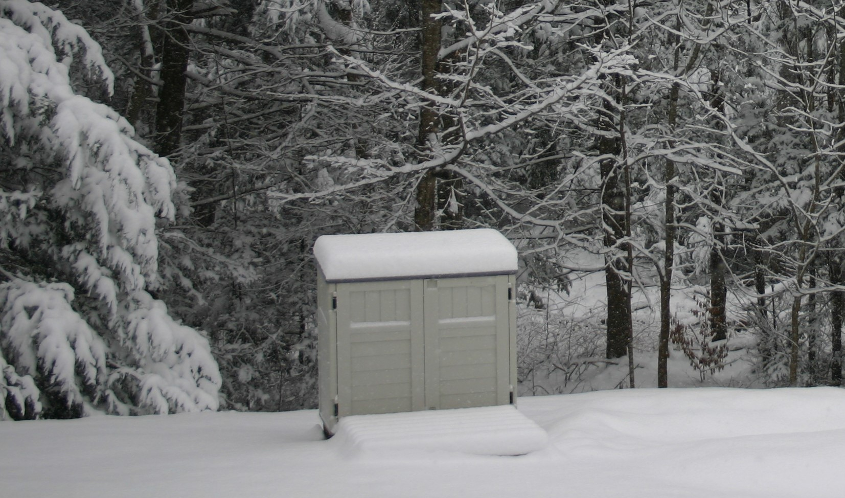

   / How do you store your outside generator? #10
When I had a portable generator I stored it in a small plastic deck box. The top opened, as well as double doors on the front.
