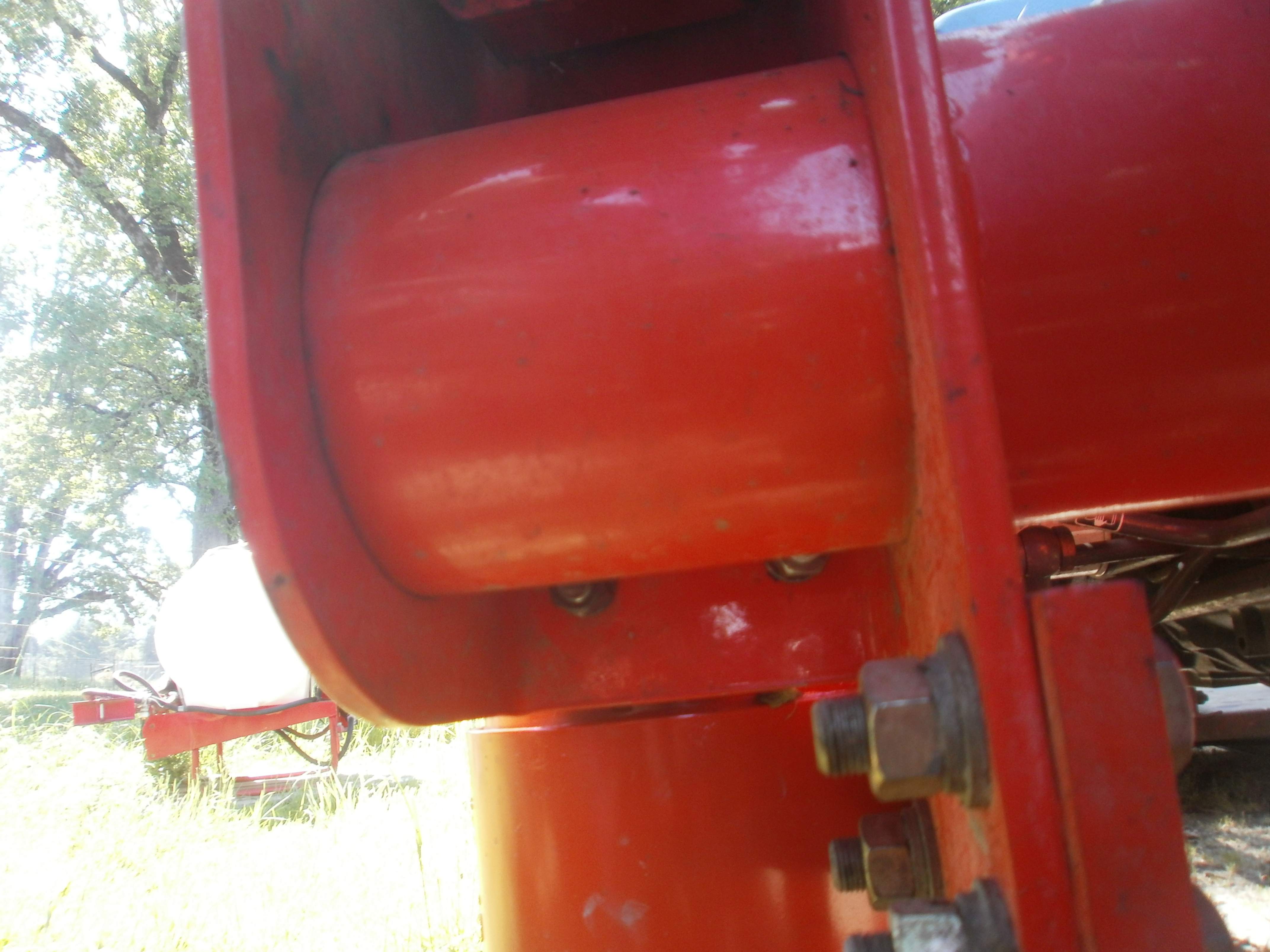

<img src="http://www.tractorbynet.com/forums/attachment.php?attachmentid=304585"/><img src="http://www.tractorbynet.com/forums/attachment.php?attachmentid=304586"/>
I also learned this trick here on TBN. Four inch dia. PVC bolted to the loader arm supports. I have chain in the left one and rope in the right one. Drain holes in the bottom.
I want to see if I can make this work on my B3300SU with 504FEL. I bought materials today.

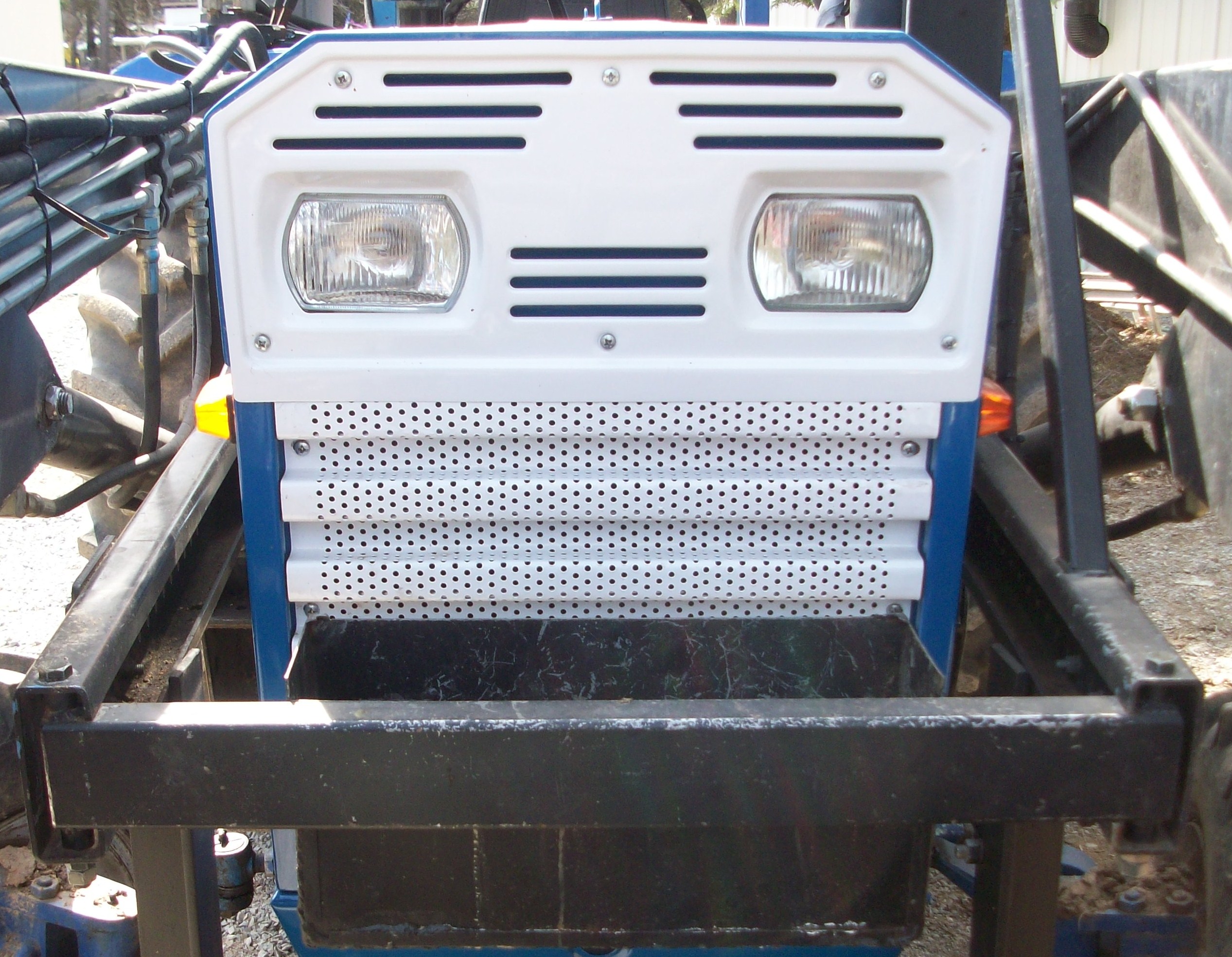

not sure- but are you describing rhino-chain storage 001.JPG something like this?
This tractor was missing the cross brace when I got it so when I fabbed up a cross support, cut the box in half (to fit). then drilled and tapped some mounting holes in the cross brace and bolted it all together, works well for chains, and I even leave them in there when mowing with the brush hog :)

Because of this forum I came up with my version of some one else's great idea. The upright for the loader assembly has holes in it at the bottom. I used six inch PVC thick wall pipe with a slip end cap, glued on of course. The cap has a drain hole in the bottom I drilled. Two large bolts go through the loader frame into two holes I drilled in the six inch pipe. At the top I fabricated a brace bracket out of flat stock. I am really pleased with it.
