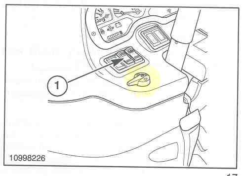

I am trying to remove the turn signal switch on my TC33D from the black plastic panel and need to know how the switch comes off. I assume that the switch handle (for lack of a better name) just pops off and a retaining nut is under it. But it doesn't seem to want to pop off? /forums/images/graemlins/confused.gif
Can anyone tell me how this comes off?

Brandon, I think your switch is very likely similar to the Class III switch, so I'll tell you how it is assembled. On top of the switch, there is a decal with a large left-right (<-- -->) arrow. That decal extends over the center of the switch. If you lift the decal at the center of the switch, there is a phillips head screw holding the handle onto the switch shaft. It's very much like the bail on a hose bib. You remove the center screw and the handle can be lifted off the shaft. On my tractor, the decal covers the hole, but I can see the round impression where the screw is located. I hope your part is similar and this helps.

Thanks Jinman,
Yes, this is the same switch on all of the Boomers.

Ok, so where are these turn signals I've never seen?
)</font>
   / How do you remove turn signal switch on Boomers? #9
Re: Need help from someone with Class II Assembly Man.
</font><font color="blue" class="small">( Ok, so where are these turn signals I've never seen? )</font>
Right there... in the attachment.
