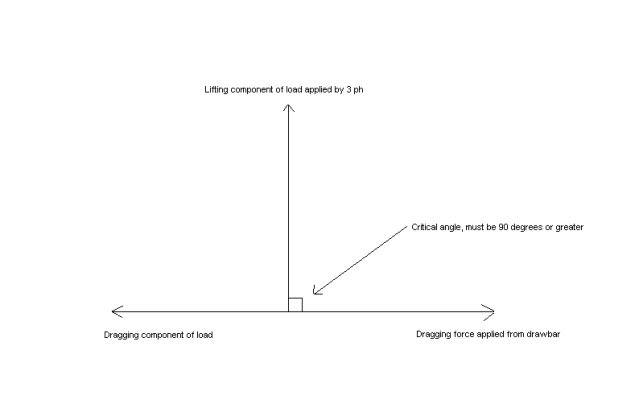

I think this is where a lot of the confusion comes from.
There are safe and not so safe ways to pull with the 3pt hitch.
When the applied load is high on the hitch, the top link is loaded in tension and applies a torque to the frame that tends to lift the front end.
When the applied load is low on the hitch, the bottom links are loaded in tension and apply a torque to the frame that tends to push the front end into the soil.
Most logging winches have a slotted rack that's mounted low on the back for attaching the choke chains so the applied load durring skidding is low on the hitch. This greatly reduces the tendency of the front to lift. This was what (as someone already pointed out) is exactly how the 3pt hitch was intended to be used. Of course, there's always someone who will find a way to make this arrangement dangerous, either through bullheadedness or pure stupidity.

Really good post Jim, it puts the spotlight on the elephant in the room. Logging IS dangerous, it's why they have sort-of-reality shows on TV illustrating how dangerous it can be. I've never seen a TV show dedicated to plowing fields or bush hogging.
Part of the issue is that we have two forces at work in this situation. The force required to lift the logs ALWAYS wants to pivot the tractor around the rear axle, there's no way to avoid that. If the tractor lifts the front wheels clear of the ground as soon as you lift the logs, either the 3ph has too much hydraulic pressure, or the front needs ballast. When you add the force required to drag them (which should be relatively minimal if only the tips are dragging) then the height that dragging force is applied at becomes critical. If it's above the axle, it adds to the forces already trying to rotate the tractor upwards around the rear axle. If it's applied below the axle, it subtracts from the "flip" side of the equation.
I think the politically incorrect way is to say "You can't fix stupid :)" I'll add to that time-worn adage and say "You can't fix stupid, careless, or just don't give a ****". What we can fix is inexperience.
In my opinion, which is just that, you need to keep the log butt well clear of the ground, ideally "shielded" behind a commercial log winch or a frame like I use. That accomplishes two things. It can't hook into or under something as you're dragging it, and it reduces the amount of friction (and mud on the log!) between the log and the ground.
One thing we haven't touched on, is the possibility of a log being dragged full length along the ground and having it hook or "submarine" the front end under a root, etc. If you're choked a little further back than you should be, what can happen is that the back end will lift off the ground, pivot around the choker, and slam down on top of the tractor or whatever is pulling the log. The reason I mention it is that it's actually happened to me, I was lucky in that it missed me and the ATV I was using by about a foot. Only a 9 foot fence stake about 6 inches in diameter, but enough to drive my sorry a** firmly into the ground...:eek: It was after that I built the log arch to tow behind.
I will say that Island Tractor and Spyderlk are right in theory. You SHOULD lift from the 3 point, then pull from the drawbar. I honestly doubt that anyone does that, I know the pros don't. They understand the risks of how they work, and manage them.
I've attached a rough diagram (really rough :)) of the way I would haul IF I was using tongs and had no way to shield the log butt. The chain going to the drawbar MUST keep the critical angle at 90 degrees or more, or you start to translate the pulling force into rotational pressure, which we all agree is a bad thing. Personally, I'd skip the tongs and use a chain choker. Attach an anchor shackle to the vertical choker once the butt was lifted then chain it to the drawbar. The downside is you're still dragging the log close to the ground. Not so good for larger trees.
My setup is a compromise, it does tend to lift the front of the tractor due to the fact that the top link is in tension. The butts are raised to reduce drag, and shielded from hooking. The operator needs to understand that the "drag" portion of the load adds to the rotational tendency induced by lifting from the 3ph.
One more thing, the closer the lift point is to the rear axle the less leverage the loads have on the front of the tractor due to the shorter moment arm. Using a quick hitch or boom pole that extends the load further from the back of the tractor, and NOT hauling from the drawbar (single point of attachment) is asking for trouble, again in my opinion.
