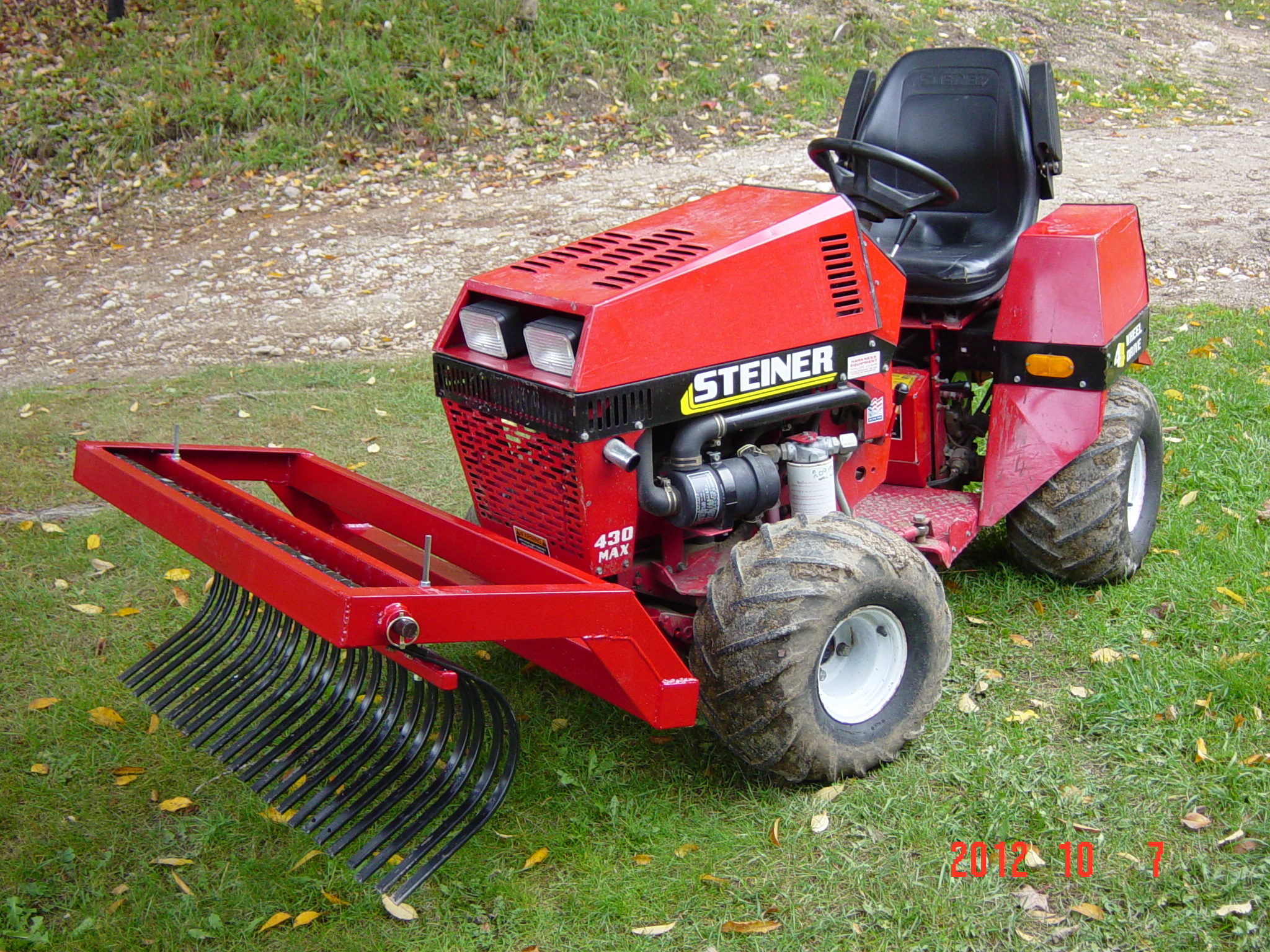

Not to sure what you mean. Once in the JD bucket, they can be dumped where ever. I have grapples, for big rocks, but this arrangement is for picking up stones and debris collected by the harley. Grapples arn't much good when you have a mish-mash of material to pick up. And a bucket is no good without back up.
   / How Do You Guys Coax Big Rocks Into Your Bucket???? #42
I actually designed and built this to gather up the debris on a lawn after felling a tree, but it gets more use for the above described purpose. The tines can float (on a rod) or be arrested.
   / How Do You Guys Coax Big Rocks Into Your Bucket???? #43
Hey Industrial Toys did you by the rack part separate? looking for something like that for a different project but can't find smaller ones that aren't on a 3pt frame already..
