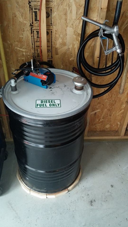

I just set up my "Diesel" Fuel Storage tank.
The oil company gave me a free virtually new 55gal Steel / Epoxy coated drum.
I installed a vented cap on the 2" bung and a length of 3/4" Black iron pipe with a screen filter at the bottom on the 3/4" bung. I had that pipe threaded so the threads were not tapered and screwed it up through the lid and then installed a coupling on top which both, locked it in place and allowed me to put an elbow on to connect it to the transfer pump.
I added a Diesel Fuel Only sticker which threw the Oil Deliver guy. I had to explain that I just needed to make sure no one thinks its gas or tries to put gas in that tank.
So here it is

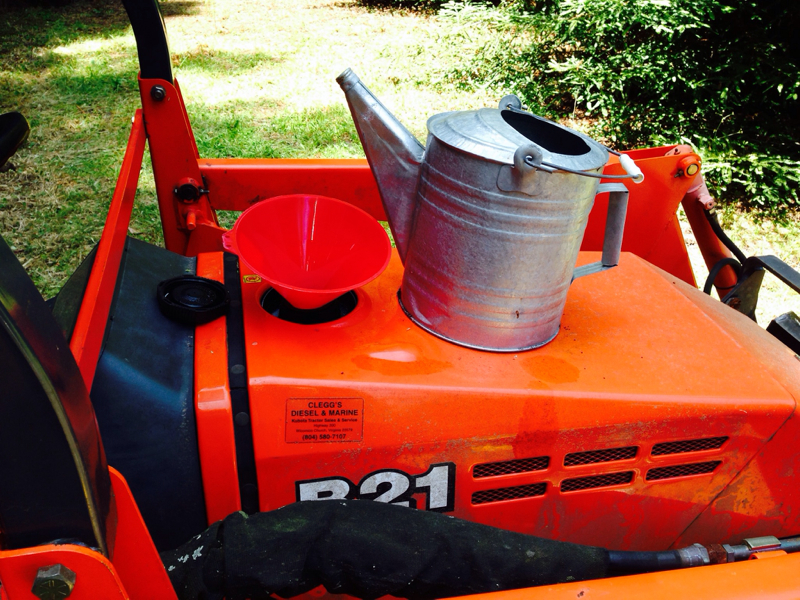

Finally got tired of climbing onto the tractor with a 5 gal can of diesel. Looked around for something to make the job easier. This works real good.
