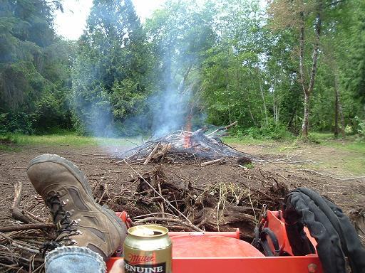

Diesel does not work all by itself unless the piles are very dry. The first photo is my last diesel attempt. I only use it now if the fire needs a little extra kick since the diesel seems safe to apply to a burning fire. I now use a propane weed burner with excellent success. The propane is cheaper, doesn't pollute the ground, cleaner on your feet and the flame can be aimed at your kindling.

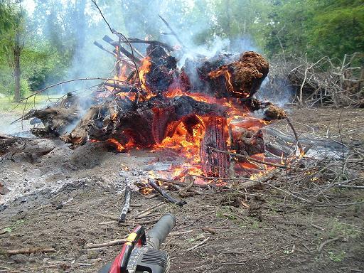

The second picture shows the weed burner principle. The wood is consumed very quickly with the blower and the smoke goes away making for a clean and quick burn.

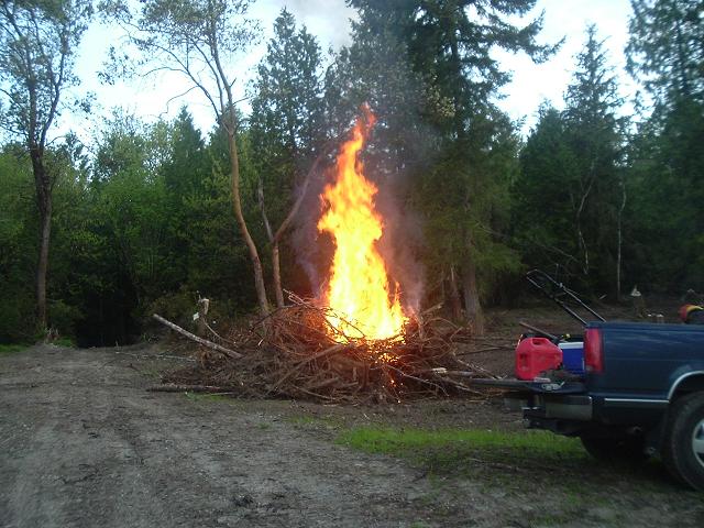

Third picture is reloading the fire with the tractor on top of coals. I sit and watch the fire a lot with my machine ready to put out any rogue fires.
I tend to prefer either several small burn piles or one small fire which I reload as it burns down. Bad things can happen when you light an extremely large pile of slash on fire all at once. Even the pros that I have hired will have a fire and then feed it from the slash pile.

Don't worry about the little chunks and sticks. Weeks later after the fire has died you can go through with the box blade to rake out any chunks and level the ash pile. Then brush mow the area which will take care of the leftovers that are too small to be collected, repiled, and burned. I've gotten permits for big fires and burned lots and lots of the pictured piles without permits. Be prepared with shovels, chainsaws, and your tractor to take care of little getaways. I've even "gasp" spit beer on a spot fire to put it out.
Notice on that third picture in the upper right that there is a tree with brown leaves. Well even high heat can kill those trees, no flame contact needed.
