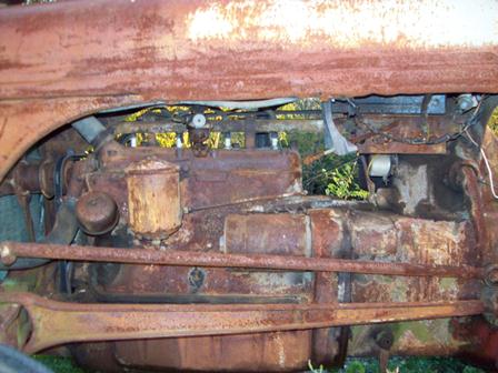

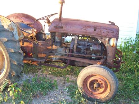

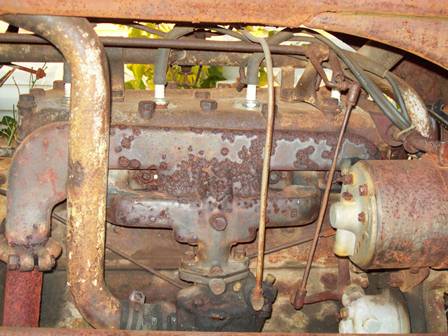

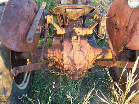

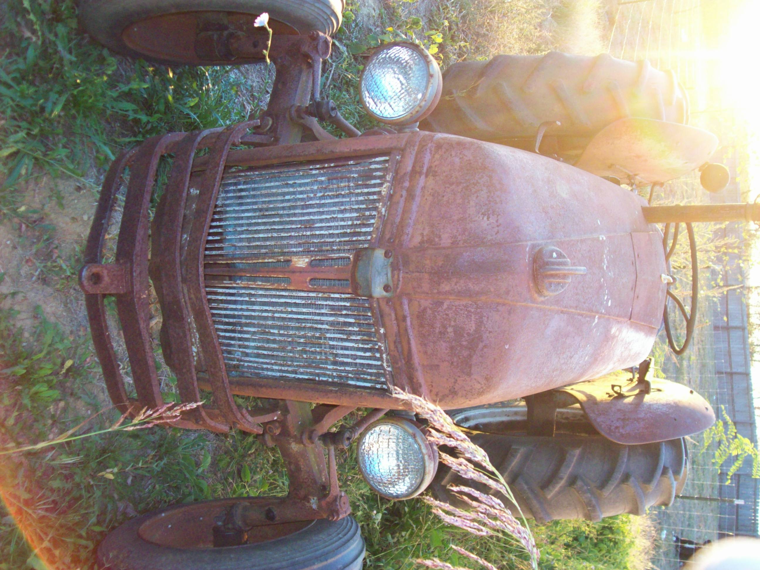

I just brough my new baby home, the guy I bought her from thought it was a 1947 8N. It has a 3 speed tranny, the 3-point lever is on the right, and the pto lever on the left. I think I have a 9N, or maybe early 2N. But I admit I don't know that much about tractors, in general. As soon as I figure out how, I'll post pictures.:thumbsup:

it is a 9n and somebody has changed the front hubs on it and changed the front wheels and tires

I finally found the serial number. *9N26791* The chart I found says this is a 1940 9N. For a 70 tear old tractor, she runs great! Fires right up (as long as I remember to open the fuel cutoff), shifts into all three gears, three-point goes up and down just fine. The guy I bought her from had a two-bottom moldboard plow on her, and we stood two big countryt boys on the plow, the three-point picked it right up. PTO still has the screw-on cover, and I don't see any wear on the splines. Only problem is the brakes, and I ordered a brake parts set and pads ftom YTM last night. Does anyone know if there is a decent ROPS available for the old girl?
