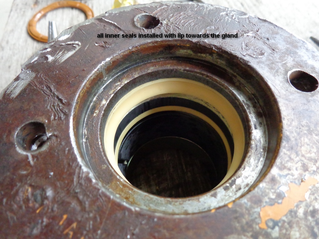

The "c-clip" is removed and then you need to tap the cap/guide back into the cylinder about an inch. You should expose a groove on the inside bore of the barrell. The rebuild kit should have an orange split ring in it. This orange ring fits into the exposed groove. Be sure it fits flush down in the groove and then coat it with grease. You should then be able to pull the rod and guide assembly from the barrell.

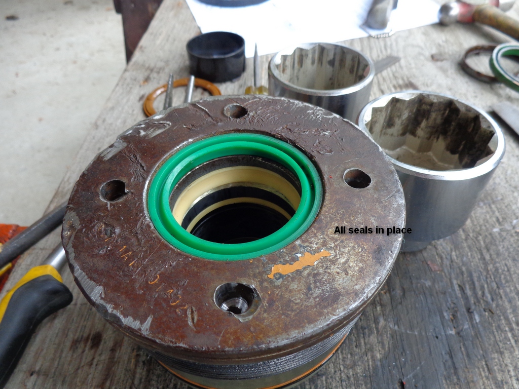

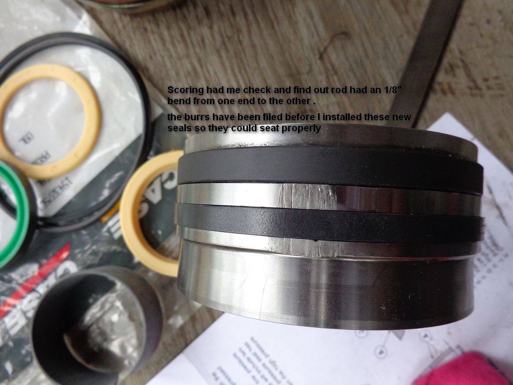

Does anyone have picture of where you insert the split ring?
   / How do I take my 460 loader lift cylinders apart to replace the seals? #17
This one?
   / How do I take my 460 loader lift cylinders apart to replace the seals? #20
Still not sure which one you mean to only split ones I have seen are the black ones but here's a couple more pics.
