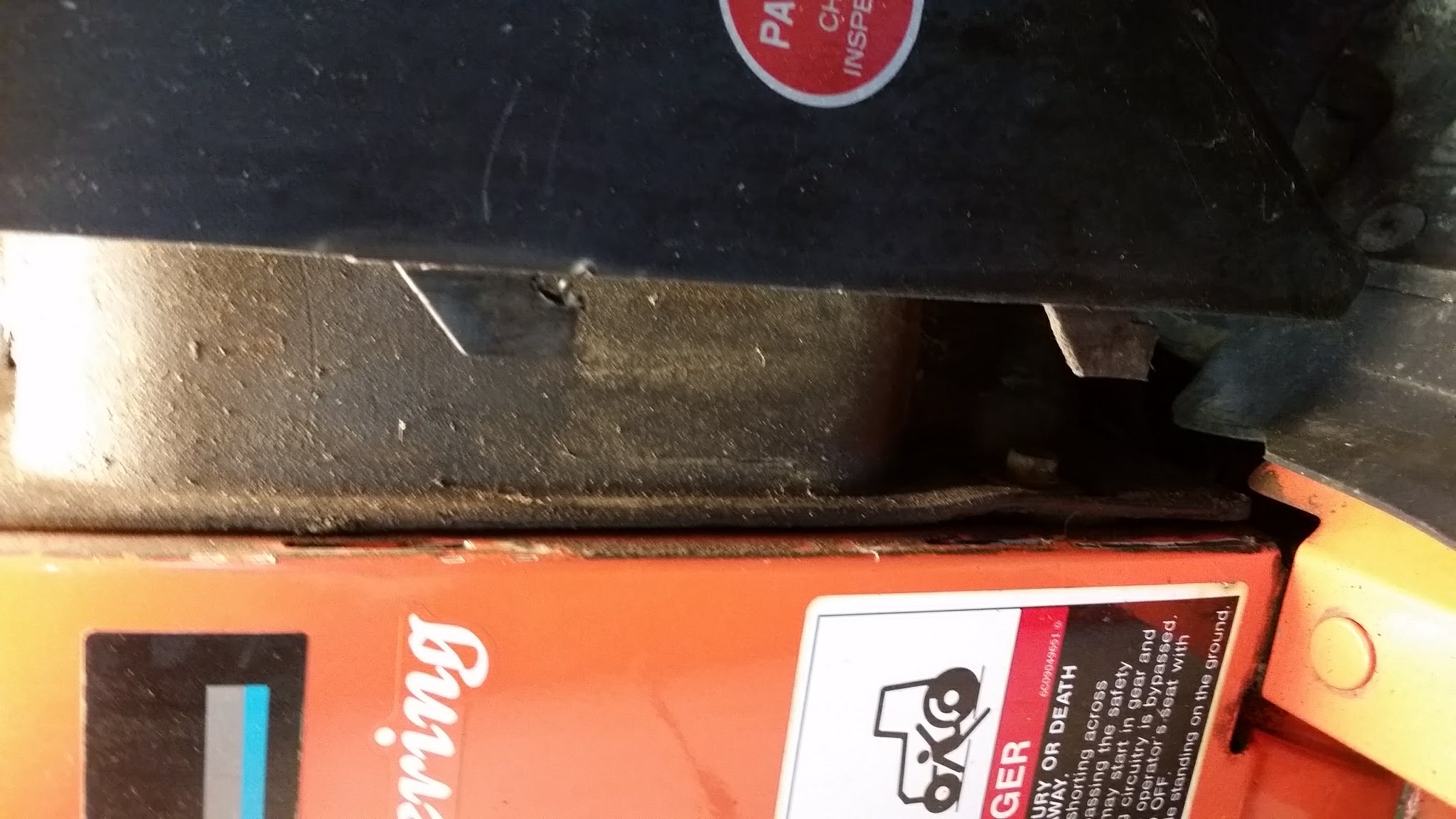

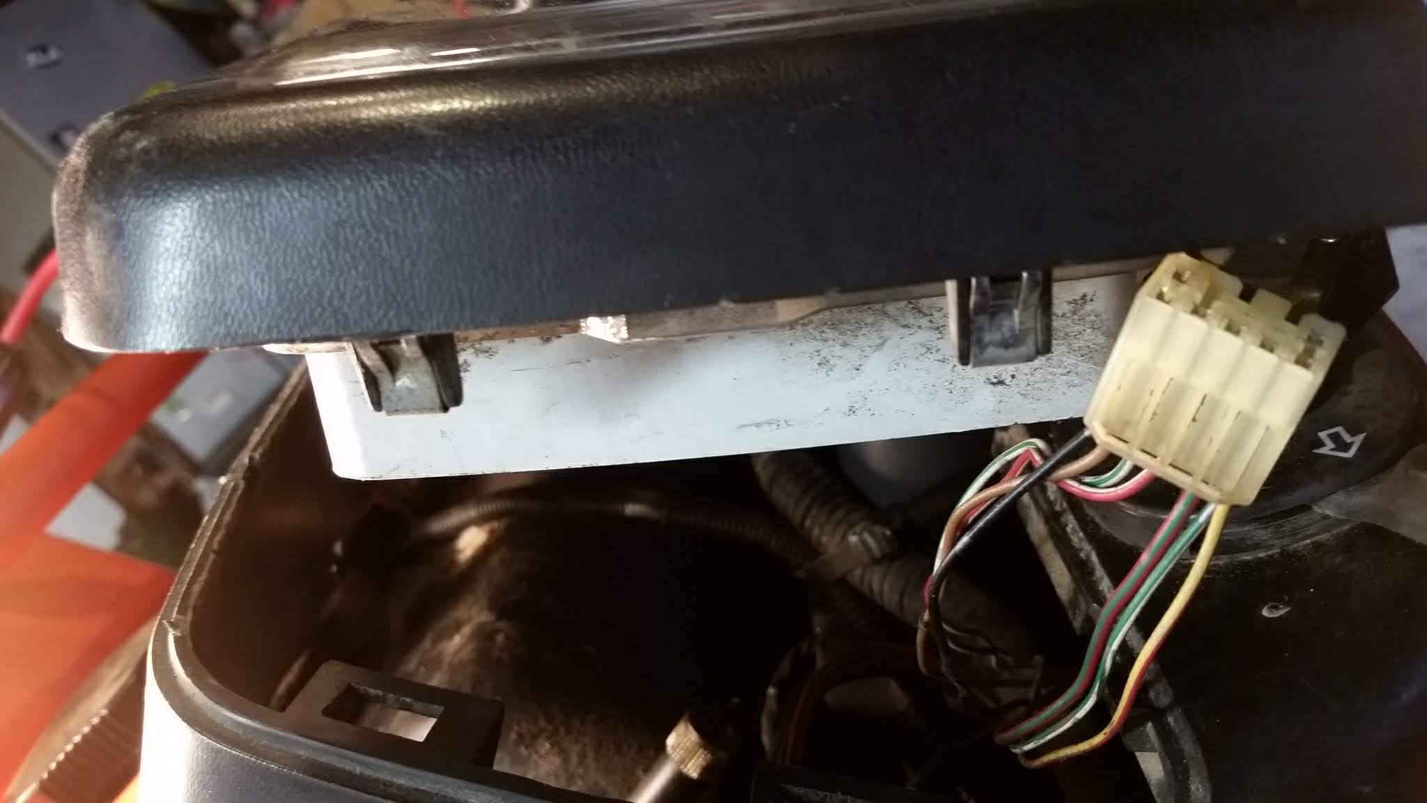

I got the cowl and instrument cluster apart. Here are some tips if anyone searches for this info again.
Remove the screw on top of cowl. The instrument cluster pops out with a screwdriver; there are 2 slots on the top of it.
There are 2 hooked tabs on each side of the cowl and you need to lift the cowl to pull them out of the slot.

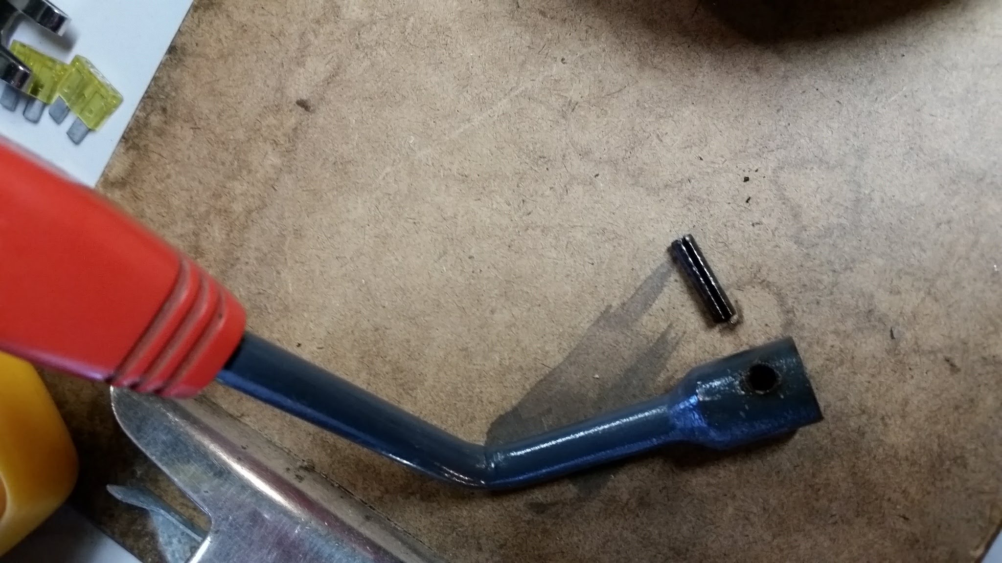

However, the throttle is in the way so you have to remove the slotted spring pin at the base of the throttle to remove it; I tapped it out with a punch.

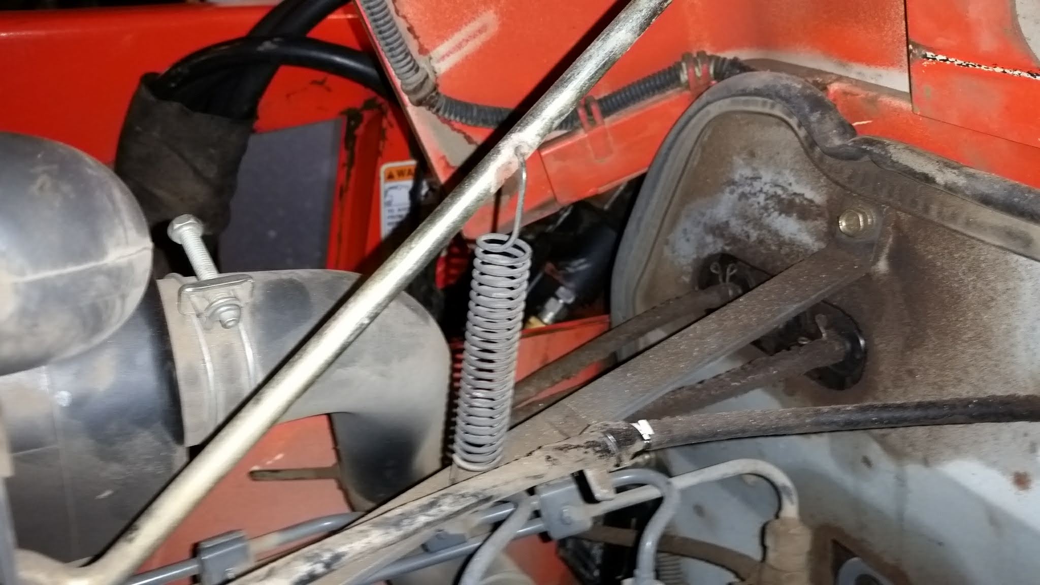

You need to unscrew the tach cable from the cluster to be able to get in there. I struggled with it because there is no room. Later I realized that the tach cable runs through the firewall, over the engine where there is a tie you can loosen to give you a bit more play in the cable. You can see the clip holding it just to the right of the bottom of the spring in the pict.
