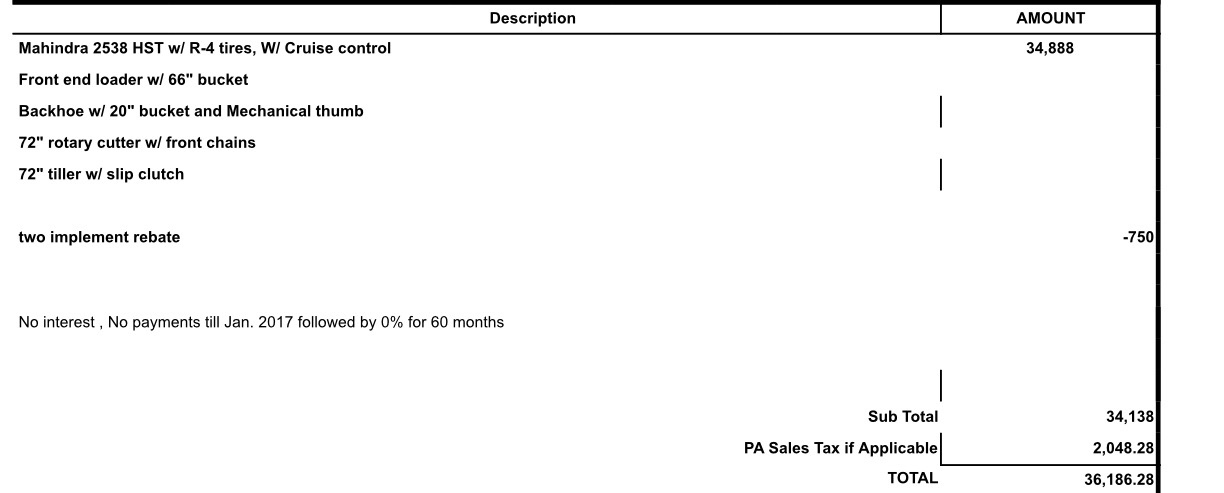

I plan on talking to them more in depth on the hydraulics before I write the check. I don't think I've seen anything in the list for added hydraulics for the front so I may have to do that on my own should I need it for a grapple or something someday. He was also saying to hold off on the top and tilt for the rear as I may never need it. The BH will be back there most of the time anyway.
/ How do I option this thing? #56
As far as the loader 3rd function, DO NOT get the Mahindra system, stupid expensive. You can get an after market kit for less than half of what Mahindra wants and a better system in my opinion.
As far as top & tilt, only if you are doing a fair amount of grading, other wise just get by with a hydraulic top link for a box blade. Need to keep in mind that Mahindra only offers a single rear remote for the 1500 series. If you want-need more than that, it will be an after market system.

Yeah I think I'll just get the one remote valve for now and hold off till later if and when I need more. The only thing I'm adding to the quote I have is the mechanical thumb. That I think I have a use for right away. I'm sitting at about 34K including tax etc. The dealer says he always adds a hook and D ring to the front bucket and fills the tires.
