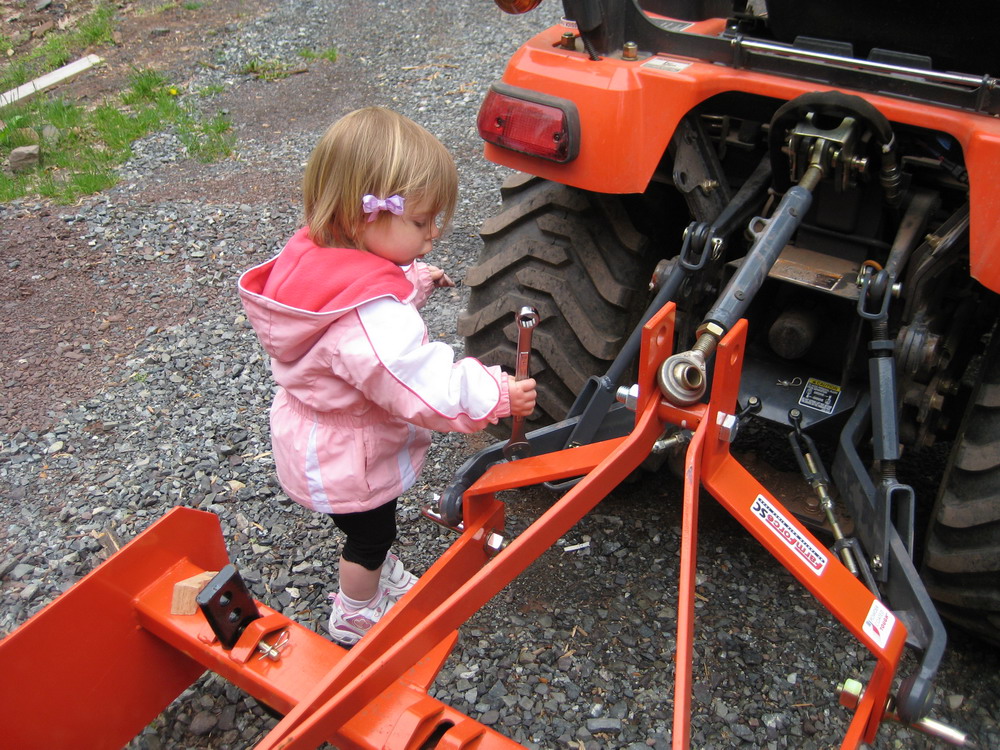

The only 3pt implement I used before was a cat0 grader on an old Wheel Horse. It wasn't too hard to mount it, since I could move it around pretty easily. But now I'm mounting a box blade that's a bit hard to move with my hands, and I know that there must be a method of mounting 3pt implements, especially since some weigh 500+ pounds I'm sure.
I'm just trying to back in with the 3pt arms over the pins and then spread them out enough to get over the pins. Is there anything more to it than that?
Thanks
/ How do I mount a 3pt implement? #3
I agree with the milkman, I know when I mounted my bush hog the first time I thought I was going to have to get help to attach it. I bought Pat's and it makes it very easy to change implements. Best money you'll ever spend!!!!
I actually found the trick. It was to bring my 2 year old daughter out to "help" and explain each step that I was taking and why. This caused me to slow, deliberate, methodical, and patient. We got it on in next to no time. :D

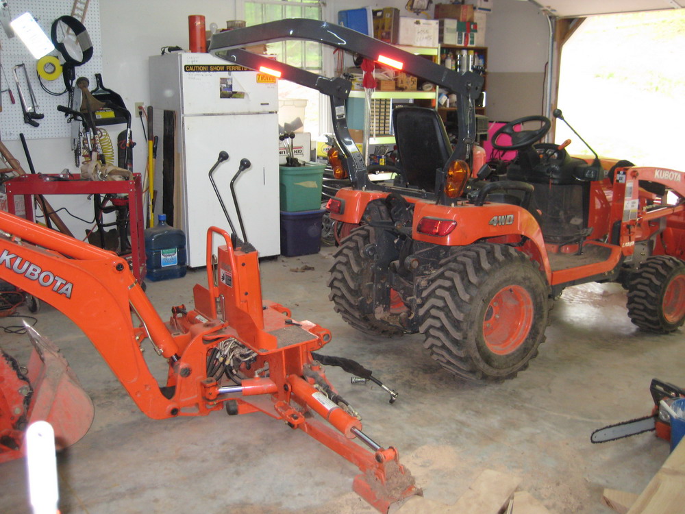

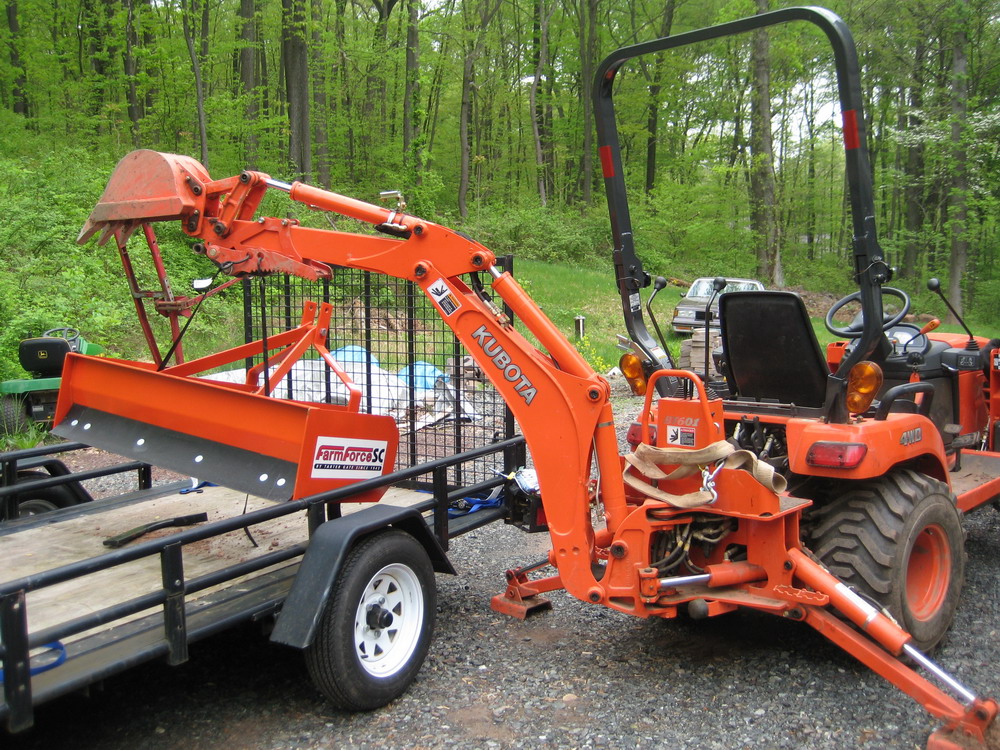

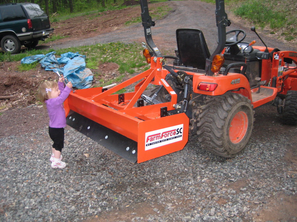

I think that instead of getting dollies, I'll have to get another tractor. :D I'll get one that is dedicated to 3pt work and then I can leave my backhoe on and use that to suspend the implements above the ground.
Here are some pictures for the heck of it. Looking forward to trying out the blade tomorrow.

3PT implements can be a pain to get on and off. You will get better at it.
Also, I 'm not trying to be a wiseguy but you might want to keep the little one away from the boxblade when it is suspended like that. You never know if that could drop unexpectedly from hydraulic or mechanical failure.
Certainly not a wiseguy with that comment. When I saw her near the blade with the hitch up, I did run over to remove her, but I couldn't help myself from taking one quick picture first. :eek:
