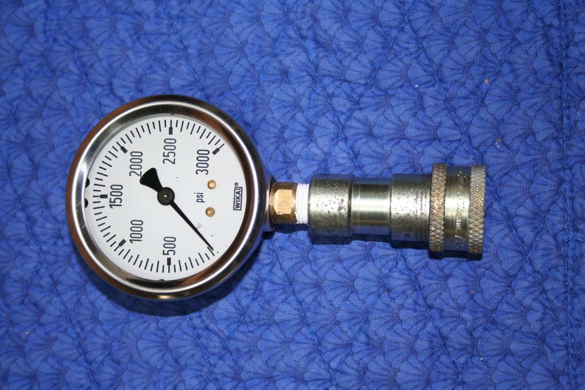

If you put a hyd gage in the system, you can see the pressures generated.

   / How do I get rid of the flop in a cx200 fel??? #10
Tractors don't usually come with hyd pressure gages.
You add them for maintenance and trouble shooting.
