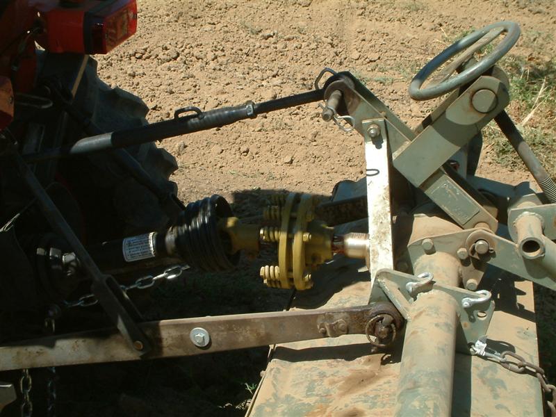

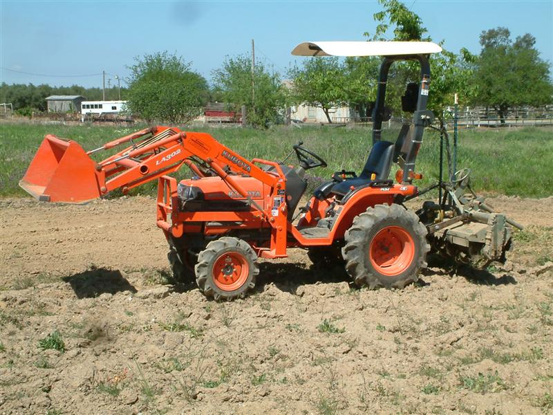

Here's the pto shaft/slip clutch/shaft extension I use for my 48"-wide Yanmar RS-1200 rototill and my Kubota B7510HST.
The shaft is the shortest one I found at Tractor Suppy Co. (TSC). Around $80. I had to cut it to fit.
Bought the Weasler slip clutch from agpartz.com for $65. That website is no longer functioning. You can get slip clutches at TSC and at Agri-Supply.com.
I needed a $15 shaft extension on the rototiller gear box to position the slip clutch so it wouldn't rub on the tiller sheet metal. Bought it from Agri-Supply.
Also had to remove the short 26" long Kubota lower 3pt arms and replace them with the 35" arms from my MF-135 to make enough room for all these parts.
