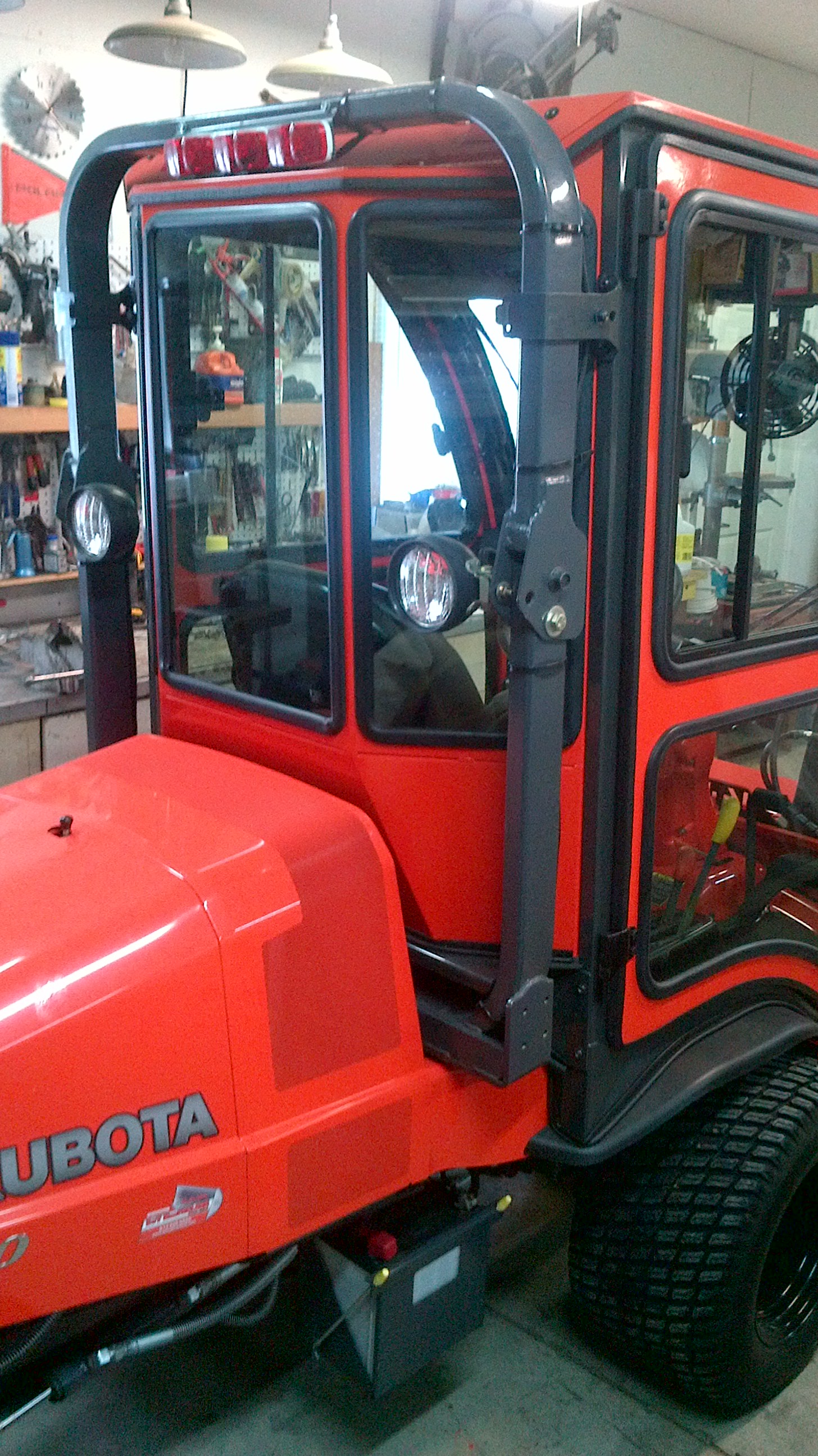

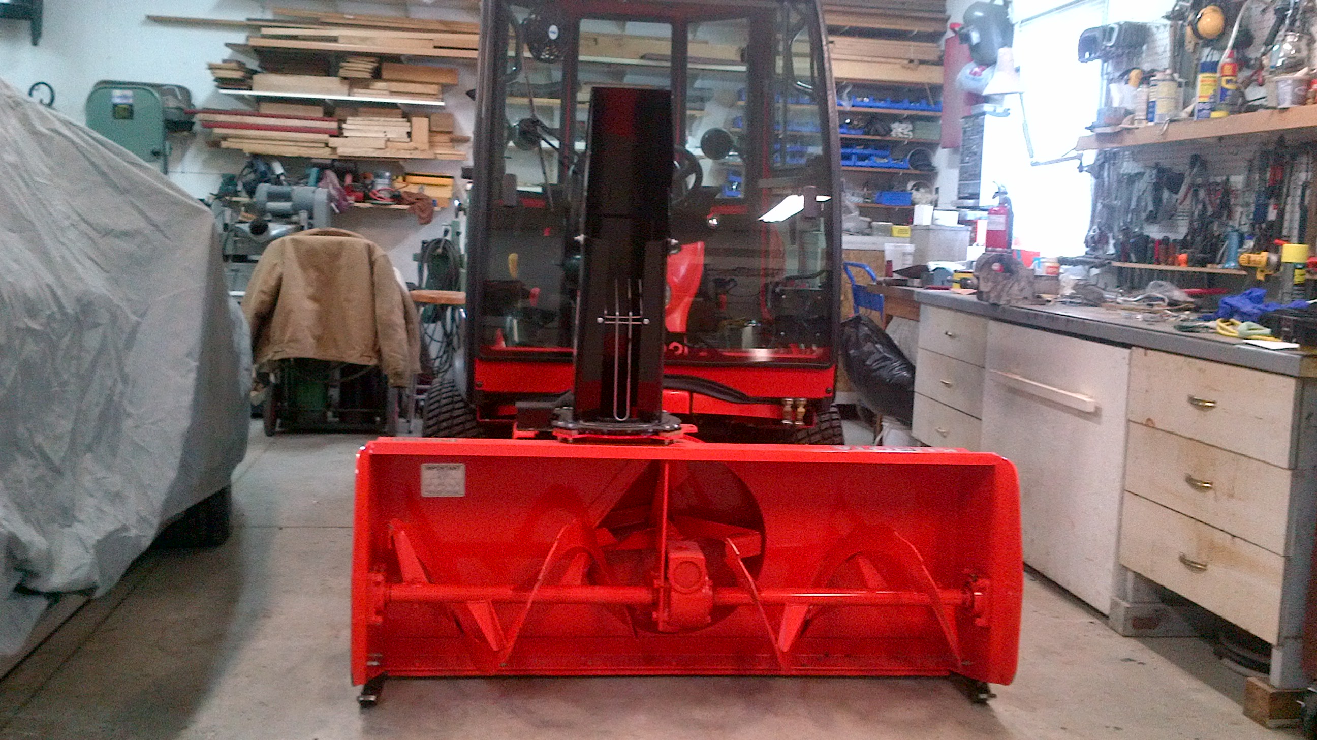

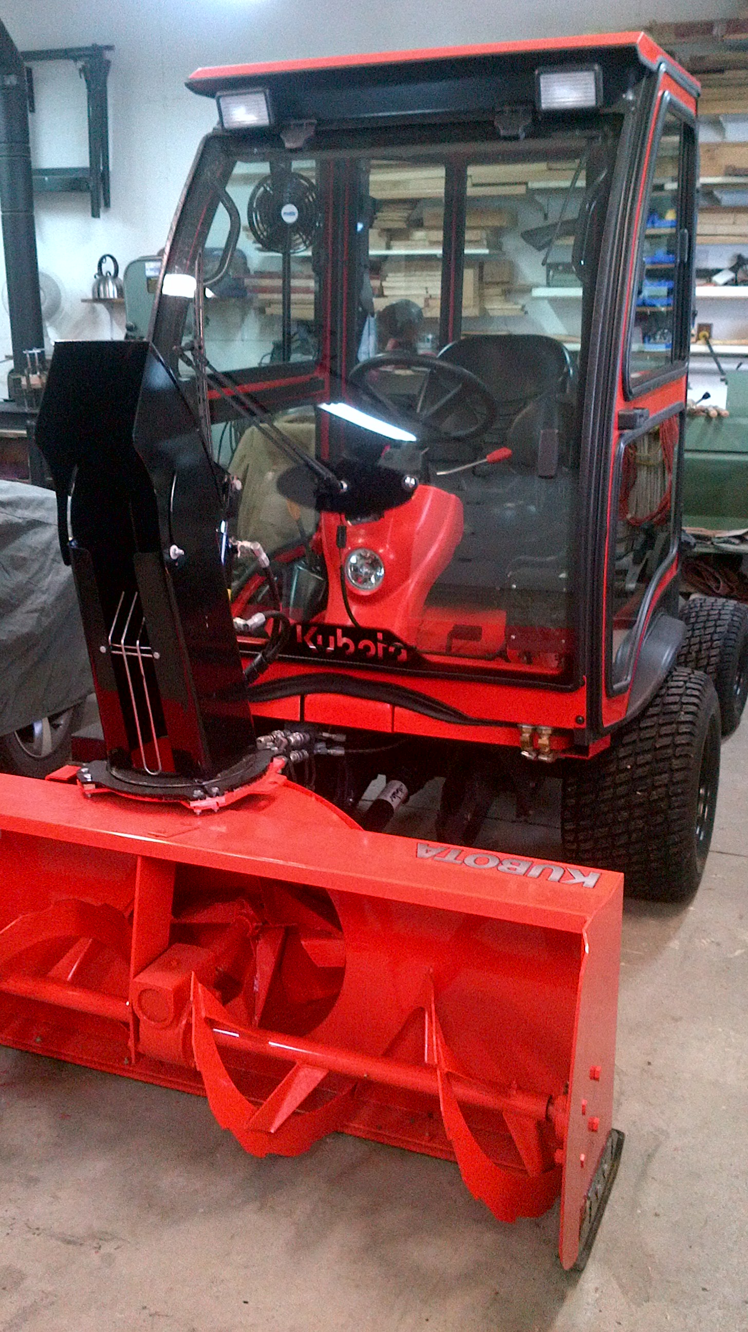

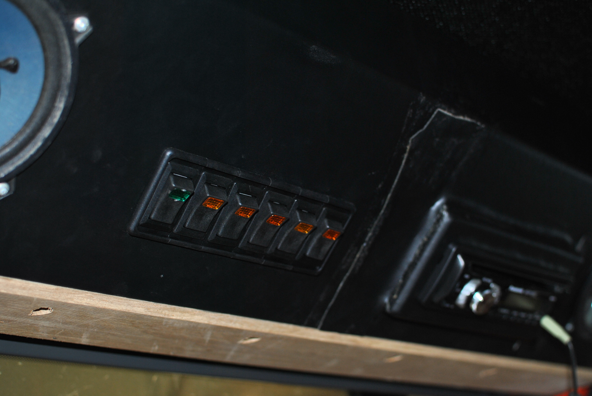

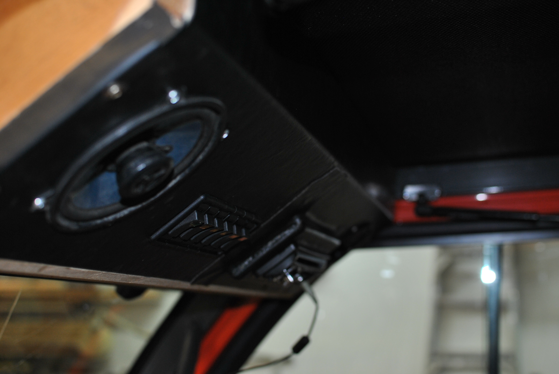

Thanks for the comment regarding the second counterweight. You're right about the ease of installation. I flipped second one over and placed it on top on the factory one, bolted it to the existing weight and then filled the casting cavities with body filler. As for the rear frame mounting plate, I wanted to make a more substantial lower support shelf at the bottom to support the added 106 Lbs and I had the 1/4" material on hand anyway. As for the springs, I didn't touch them. The lift arms work well as is.... I probably should compare the weight of the mower deck vs the 57" snowblower, they might be about the same weight.
The travel stops are a must in order to prevent the discharge housing from hitting the console when lifting the blower, or in my case, prevent it from smashing the cab windshield.
As for overall weight, my cab weighs in at about 500 Lbs. My property is relatively flat so I really don't need added traction. My overall weight is about 2700, plus driver and fuel. I don't slide too much on ice and snow.

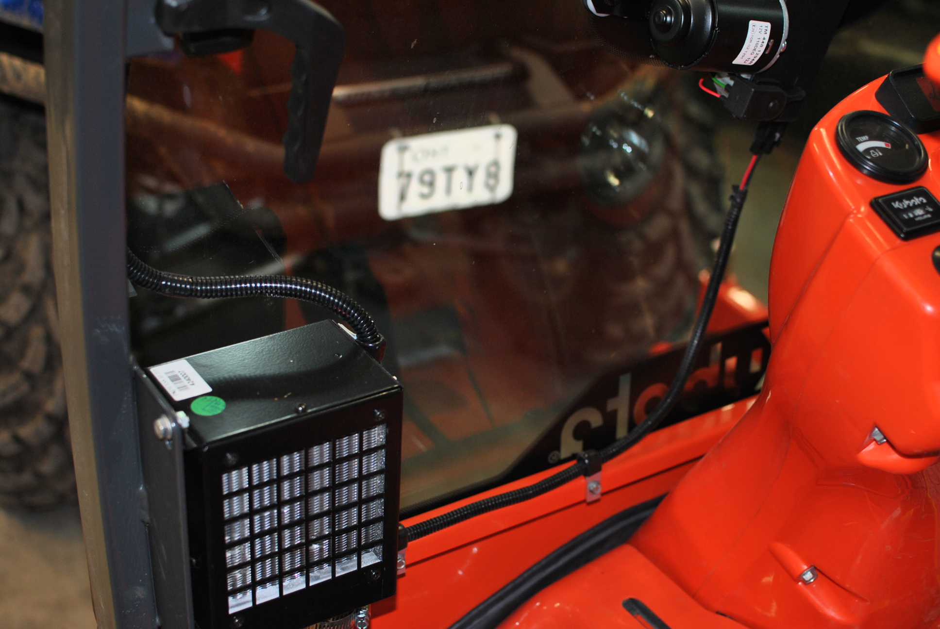

Included a few shots of the blower installed, have good heat, great music (fabricated an overhead console too), installed lots of lights, so lots of fun. I don't consider blowing snow a chore...

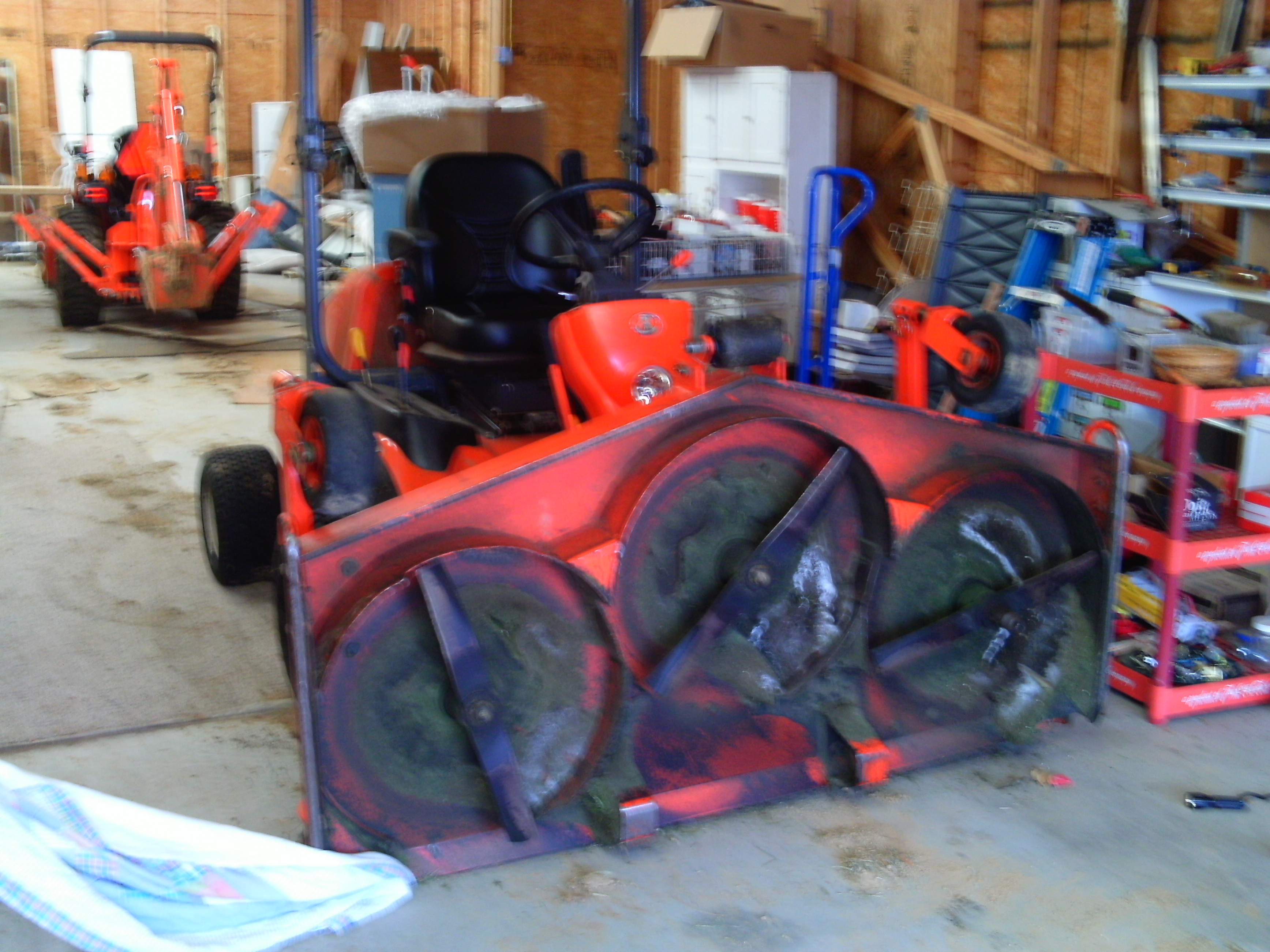

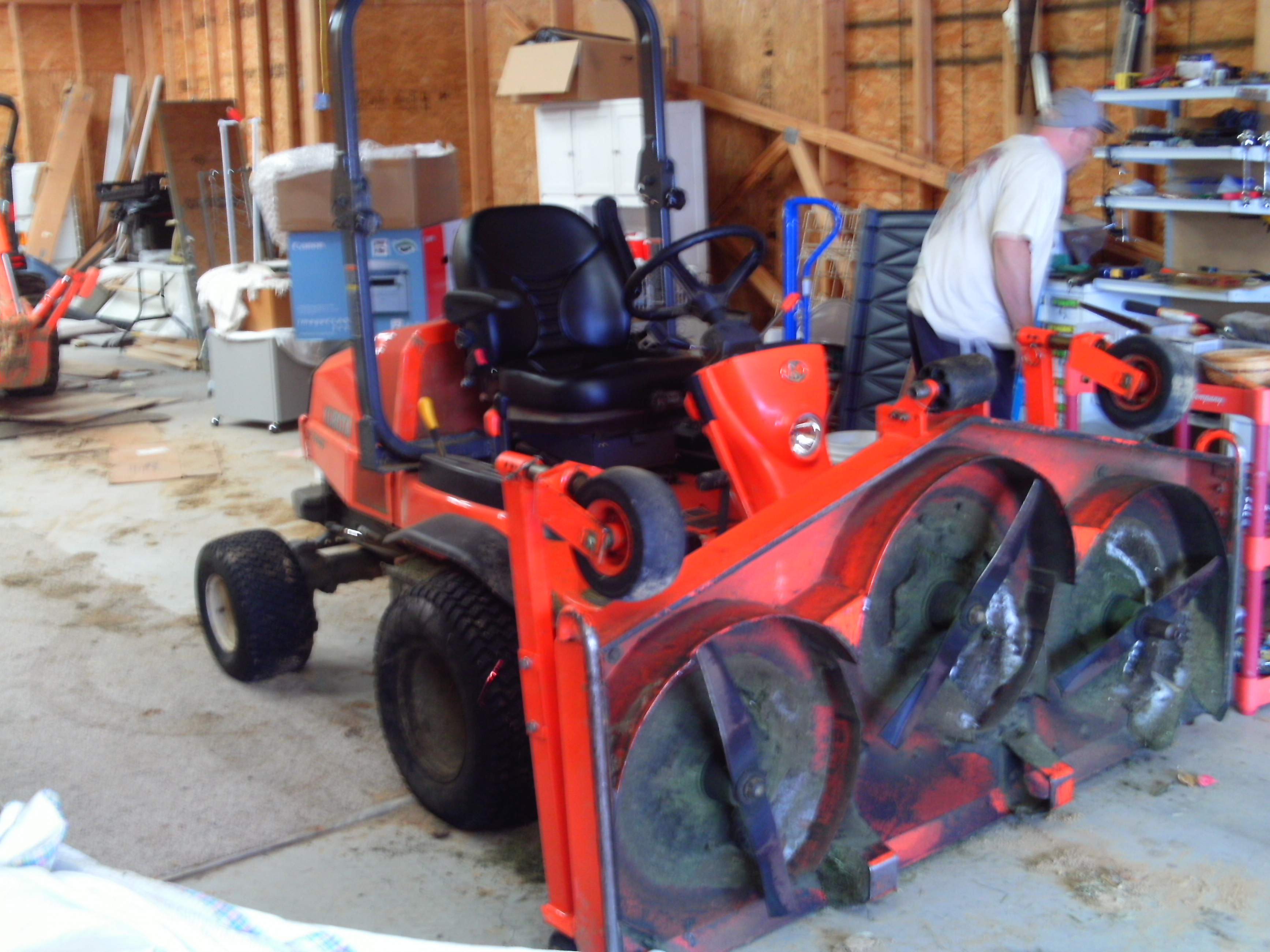

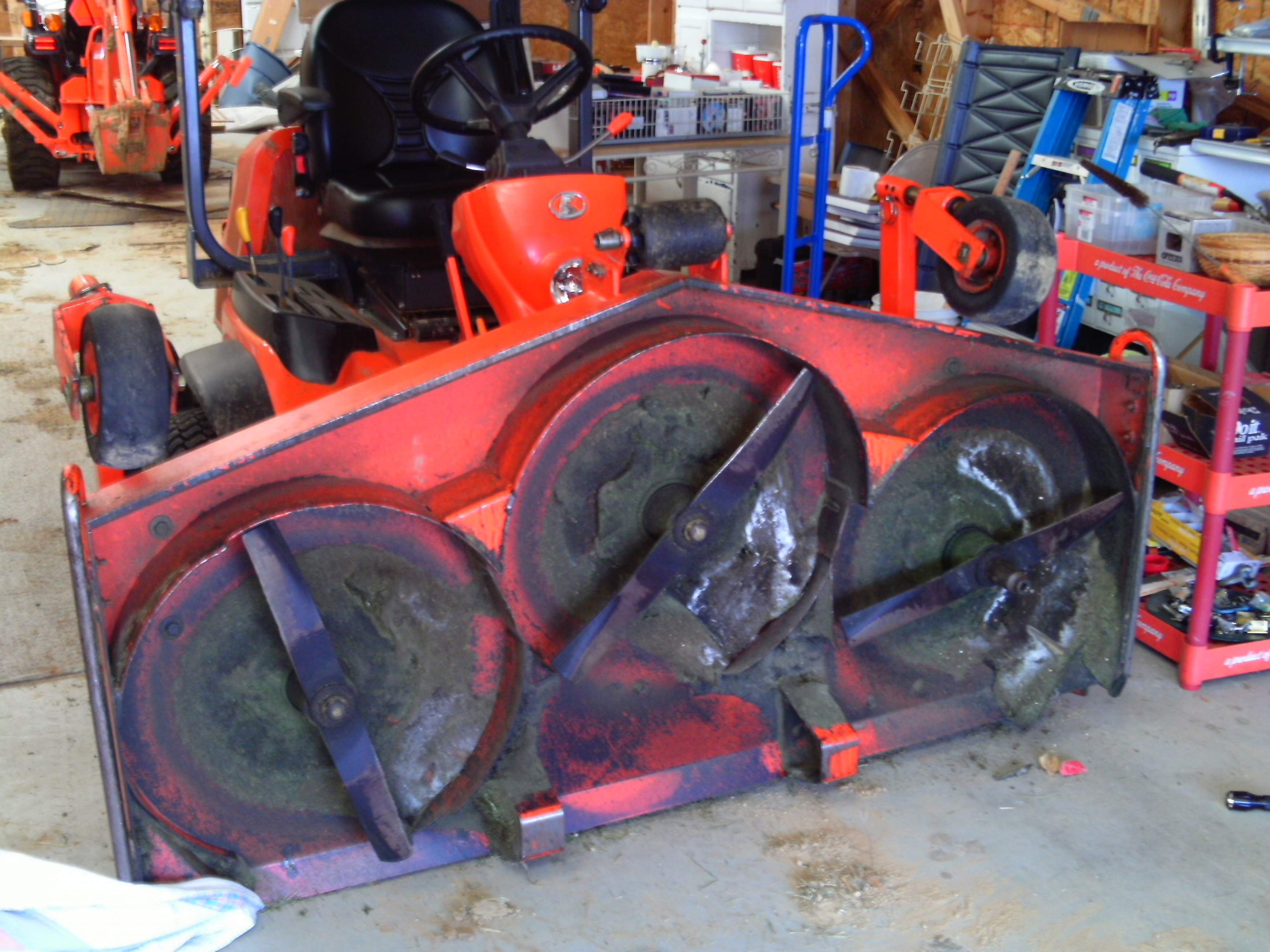

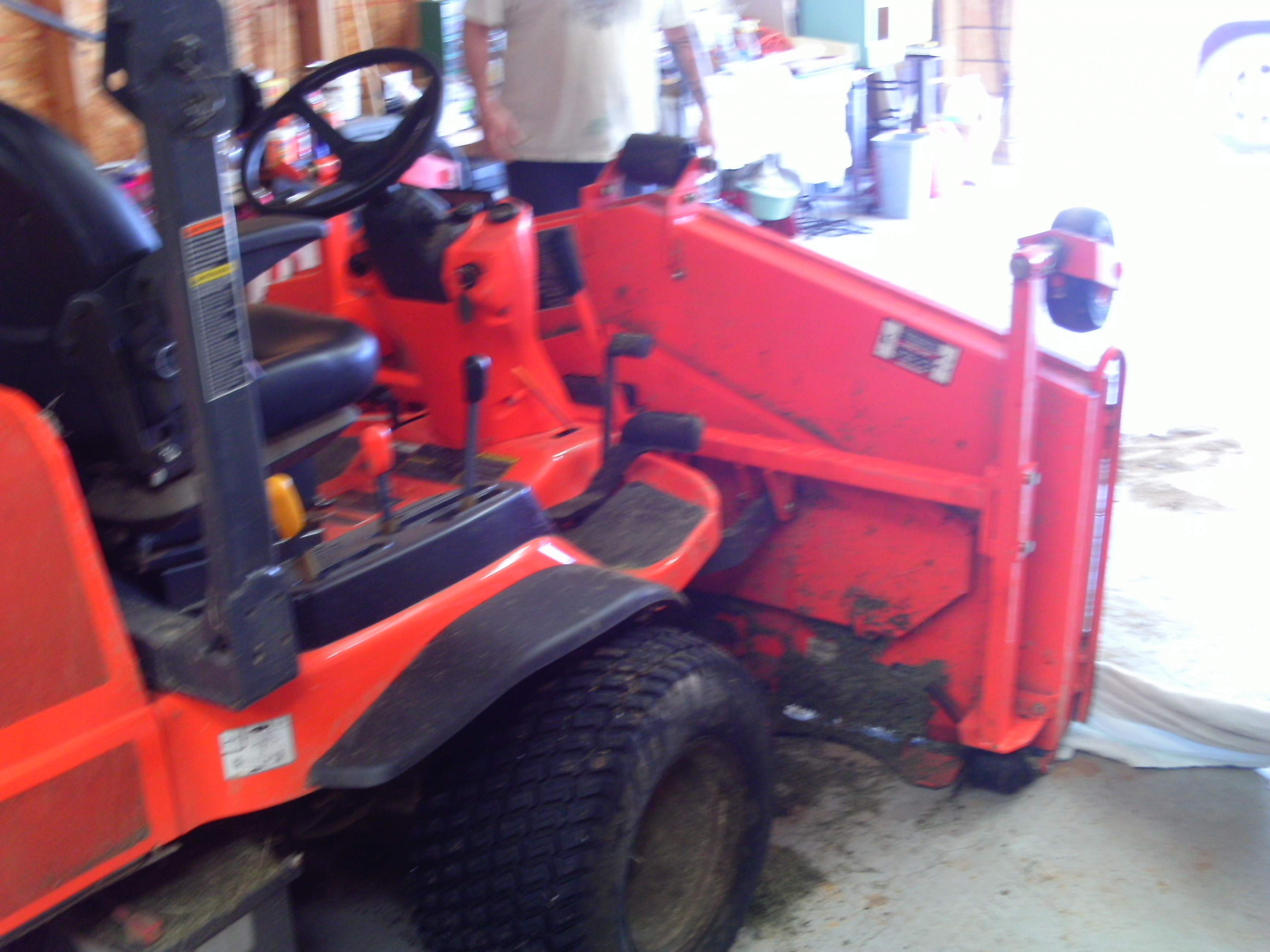

One of my blades is not turning, again. So, needed to look at my post about raising deck and will do so to tighten blade down and sharpen blades.
   / How difficult to sharpen or replace the blades on a Kubota F model?? See for yourself #38
Have you sharpened the blades and cleaned the deck underside since that original post back in June of 2013?
I typically sharpen three times per season, clean fairly often. I agree that the impact wrench is sweet for loosening the blade nuts, my 84" rear discharge deck has 6 blades (3 CCW and 3 CW). Like Murphy, I purchased a Ventrac 4500 with a Kubota engine. I considered the Front mount Kubota, but my land is sooo steep. The mower is a front mount and hydraulics lift the deck up high, then there is a thumb latch to unlock the deck to let it rotate straight up and lock for cleaning and sharpening. No fluted drive washers to break since it is a belt drive affair. The actual sharpening of the blades is easy on a large belt sander with 60 grade belt.
Work safely, these decks are heavy enough to crush you!
