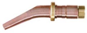

Anyway my plasma cutter with the Trafimet torch won't get real close to something like the OP described.
I do have a tip for my Smith torch like the pic below that will cut flush, got it new off eBay for cheap-

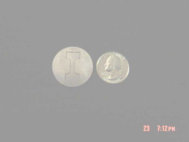

No use for Plasma in the Metal Fab World? Plasma " Should " cut as well as a saw with more accuracy than a cut off wheel. You can turn it up or down. Man..What Brand are you using??
/ How close to flush will a plasma cut? #16
i have a hypertherm 1000 and i cut aluminum checkerplate all the time. does a great job and no distortion.
MInd you mines on a cnc table moving at a fast clip. maybe your moving too slow.
I get very nice percision in metal fab work. This is in some 3/16 and 1/4" stock

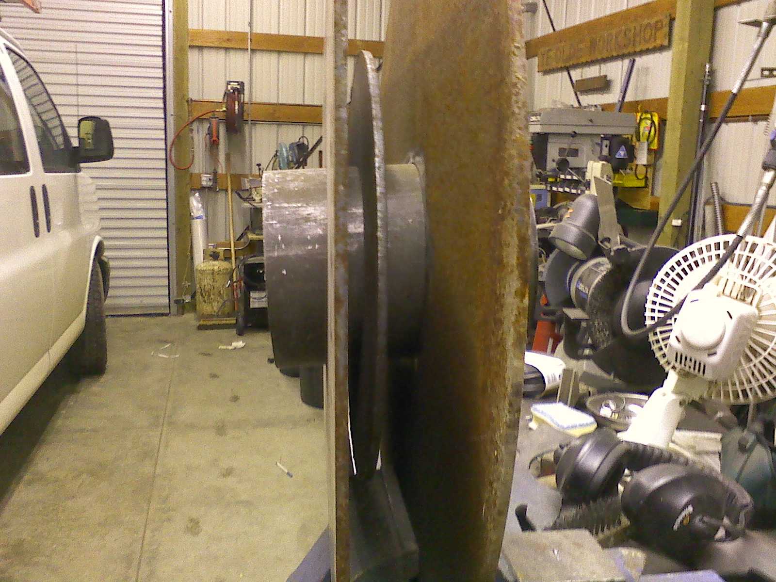

Here's some nifty cutting my brother-n-law did.
