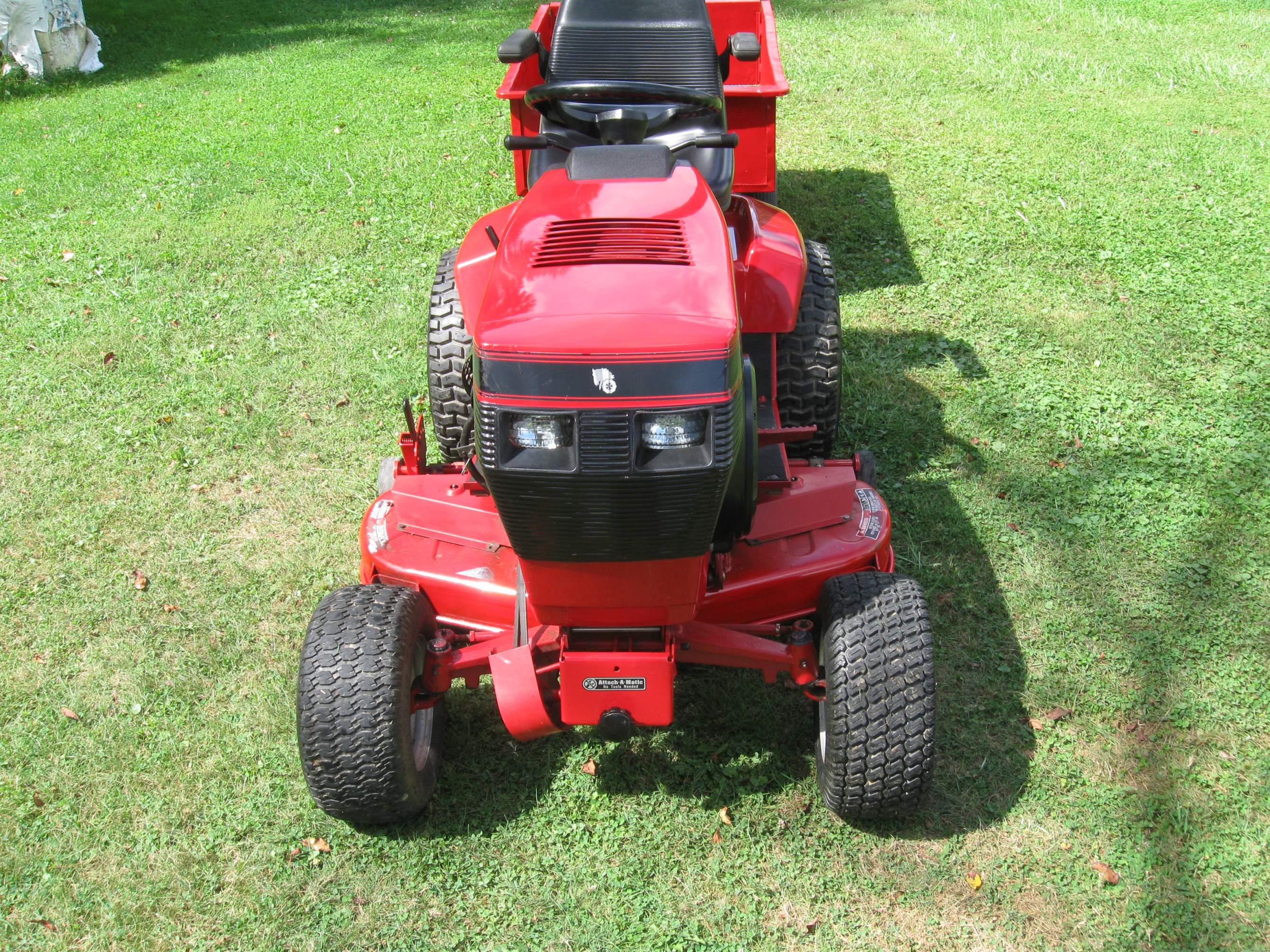

Is this option indicated in the tractors model number, or is it by the front wheel size or front axle?
What do I look for? My front axle assembly:confused3: 008.jpg looks very wide and the steering wheel is very easy to turn.

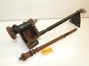

520's had both. Look at the base of the steering column and it should be clear if you have the reduction. Without it there's just a 'fan' gear. If you can post a picture I could tell you for sure.:)
   / How can I tell if my 520 H has gear reduction front steering?
Thanks!
Mine has a fan gear at the bottom of the steering shaft so it must not have the steering reduction. :)

Yupper dupper. Non reduction. Here's a picture of a reduction unit.
