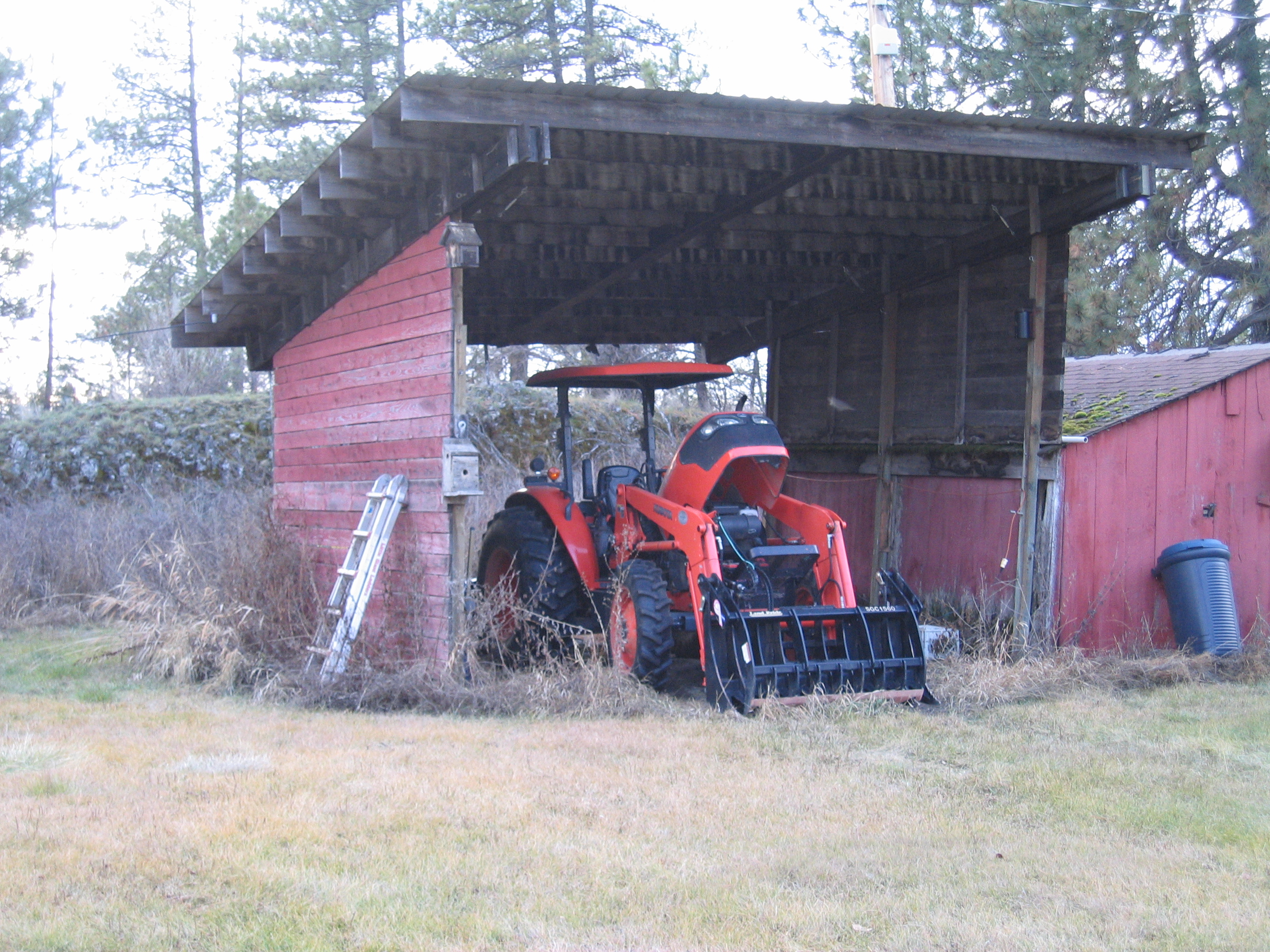

I have an open carport. I get off the tractor, get out of the carport - let it warm up, all by itself. Even in this open carport the exhaust can get pretty rough. IMG_0001.jpeg
