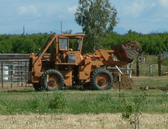

Howdy Folks;
I am in the Market for a bigger tractor. I've been buying Round Bales by the Semi load and I need a tractor big enough to unload them. My David Brown 885 is not tall enough nor is the front end loader string enough to unload the top row from a semi.
I will be looking in the used market and not afraid of an older tractor.
Does anyone have any suggestions?
Thanks in advance.
Texvet45
Seguin, TX
Before dropping a bundle on a bigger tractor, I'd check out a used wheel loader like the Allis Chalmers 545 that my neighbor has
You can find these in the $5-10K range.
Get a SSQA fitted on the loader arms so you can change from the bucket to your bale handling implement.
