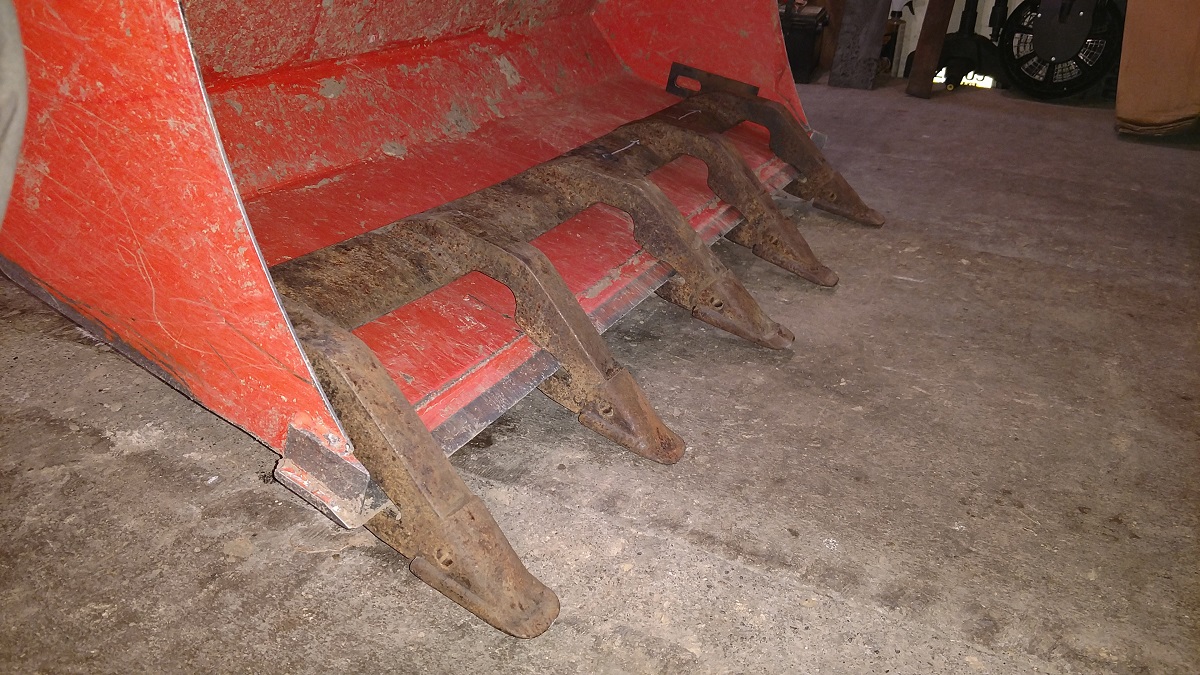

Do you have a Tooth Bar bolted on the BX25 FEL bucket? Piranha is the Tooth Bar brand most favorably reviewed for light tractors here on T-B-N. Tooth Bar will improve FEL digging capability around 30%.

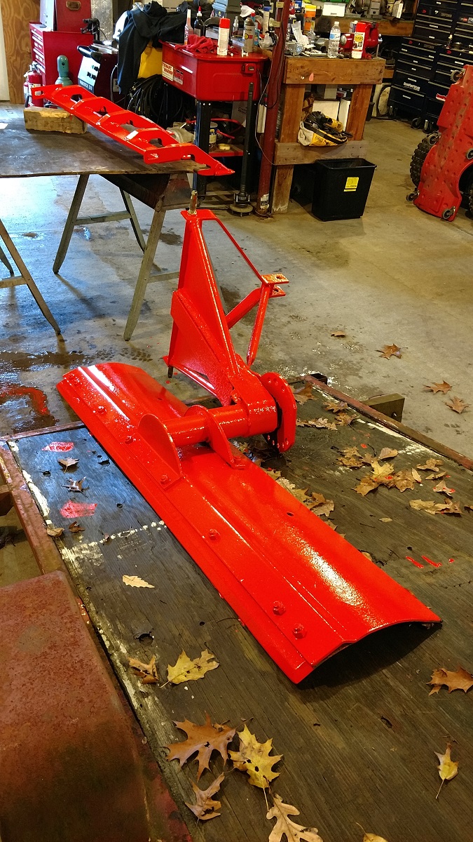

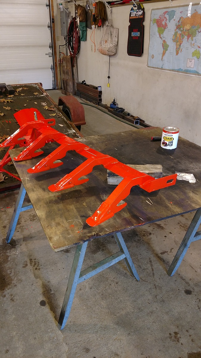

I actually just made a tooth bar last weekend for the BX from a throw away skid steer bar my buddy had laying out in the mud at his saw mill. I cut it to width and plasma cut new brackets to fit my little bucket.
I also got a 72" back blade gifted to me from my father in law, no clue what make or vintage other than OLD! But it's pretty heavy, I would say 250 lbs. I can not pick it up and move with it easily, I have to stand it on end and kind of bear hug it and waddle with it. This is my hold over until I can source a used/cheap or better yet broken/free box blade.
I'm a big fan of used, cheap and better yet... free. I can usually fix things that others don't want to or can't.
