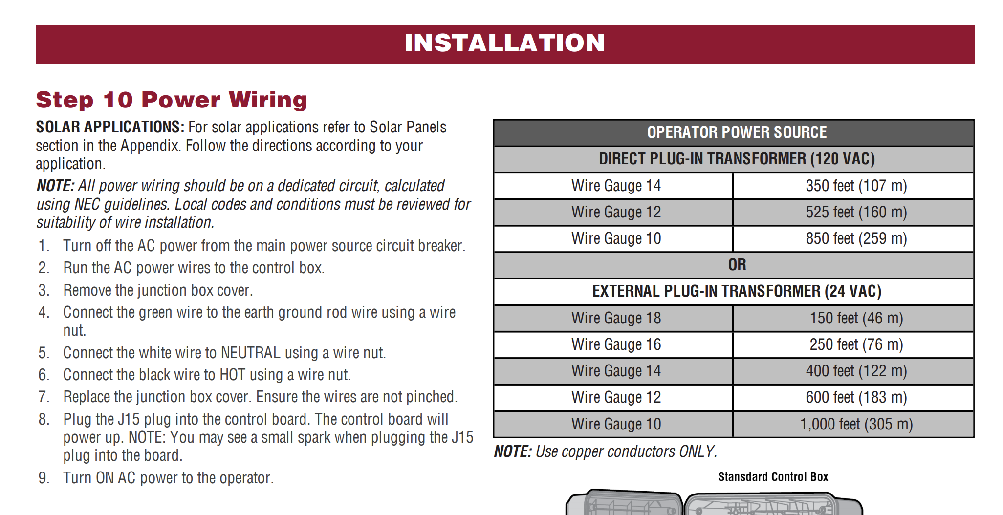

Lifted from the LA400UL Owner's Manual: Screen Shot 2020-09-05 at 8.03.04 PM.png
Quit guessing. Get the opener's manual.

I致e got a customer wanting me to run a wire underground for a gate opener. They don稚 have the opener yet to look at the amperage but I don稚 think theyæ±*e very many. Electric charts suggest like 6 gauge but I壇 have a hard time believing 12 gauge and 10 for good measure wouldn稚 work. I haven稚 measured the distance but itç—´ like 150 feet.
Funny how many guys jump in and argue about wire gauge you should use when you havent even defined the basics of DISTANCE, VOLTAGE and AMPS. Stop pulling numbers out of your arses, theres usually something called an electrical safety code which tells you the required wire gauges, no guesswork required.
Probably a good safe starting point would be 240VAC 20A. Now measure the distance from the drop to the electrical panel.
