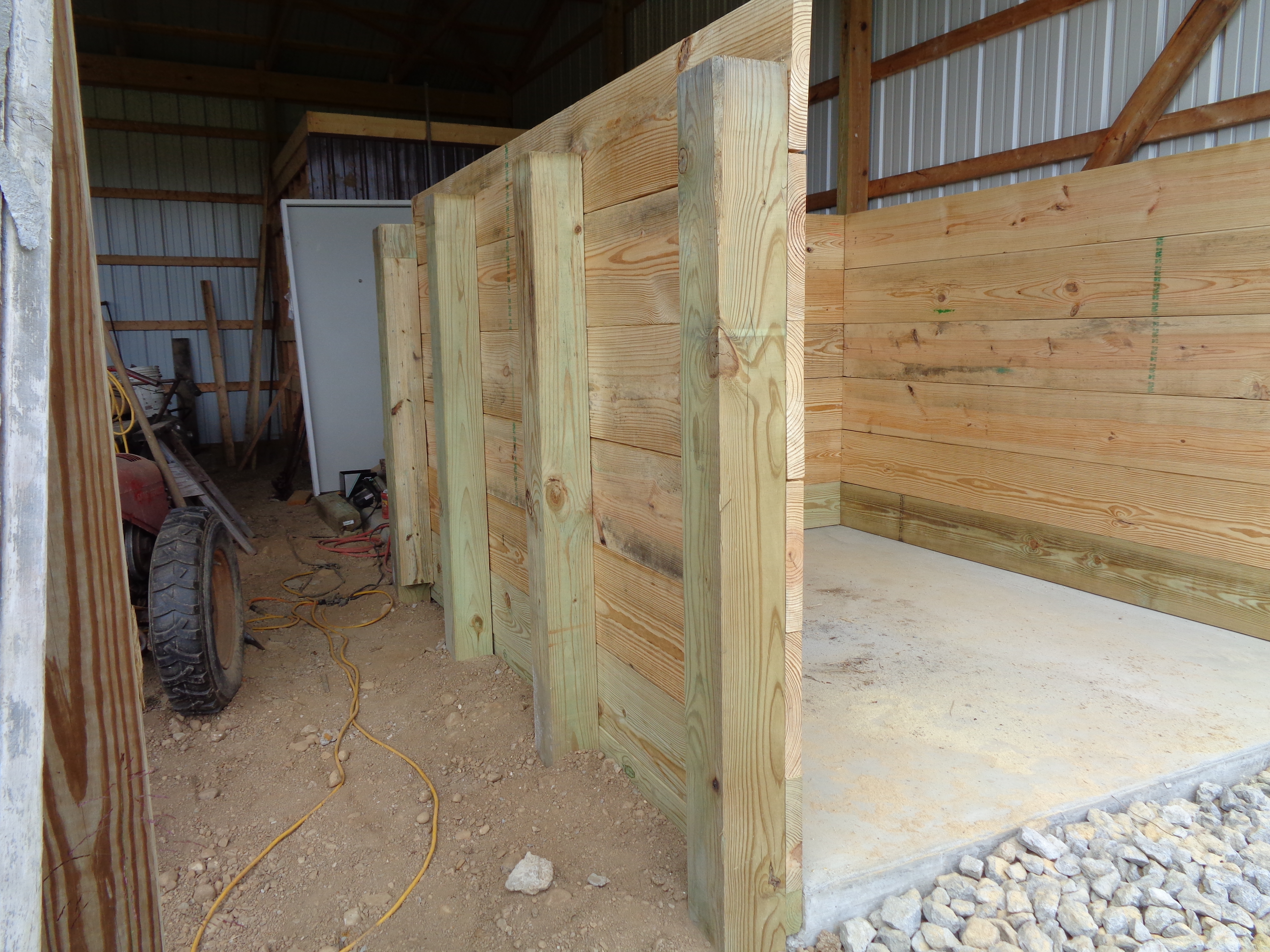

Interesting topic. I dont have much experiece doing a large pour. But last year did a 10 x20 with ready mix. It was around the back of house and I hired 2 guys with a small pump trailer. My buddy and I did the final screed and bull float. The pump guys were well worth it. They even helped out more than just pumping the concrete. Was about 500 bucks.
   / How big of a slab could I do by myself? #20
I poured and finished the floor of my 18 x 24 pole barn by myself in 6, 6 x 12 pours. Used 1 cu yd concrete buggies from rental yard, floated and finished with trowel. Due to the proximity of the rental yard, the timing worked out so I could place the concrete, float, then clean out and return the buggy. By the time I got back from returning the buggy (half hour or so) the concrete was ready to trowel.
Just did one pour per day, strip forms, set up again, repeat process every other day until it was done. Took a while, but worked out good. Paid a few bucks extra for the 4,000 psi mix and so far (after 8 years) no cracks.
I was 58 at the time and I had to hustle to get each section done, but it was not too bad.
