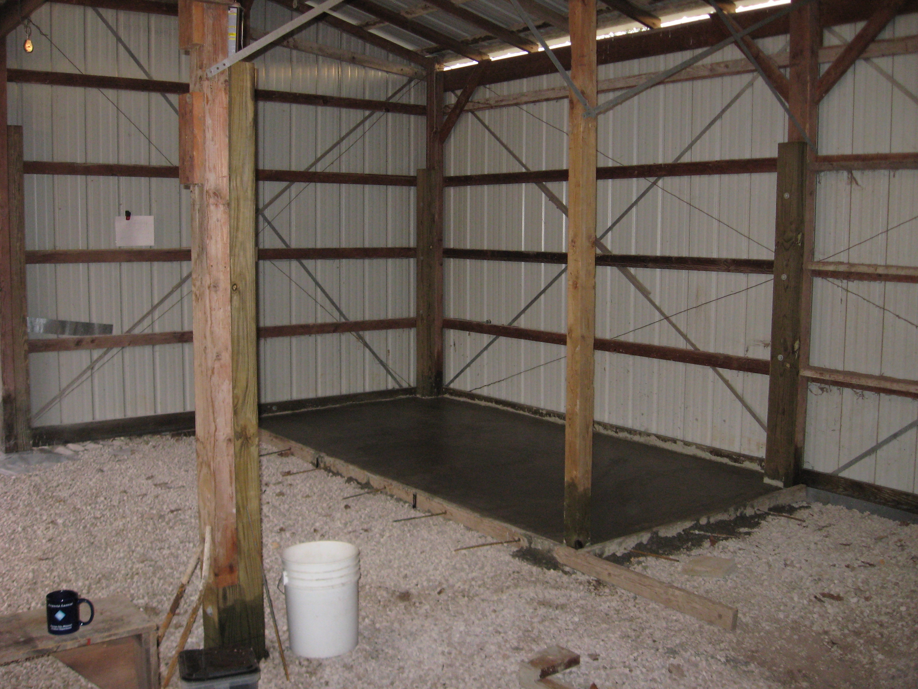

When I did my pole barn floor, I left about a foot sticking out beyond the forms to tie the slabs together. That was 9 years ago and it seems to have worked out OK.

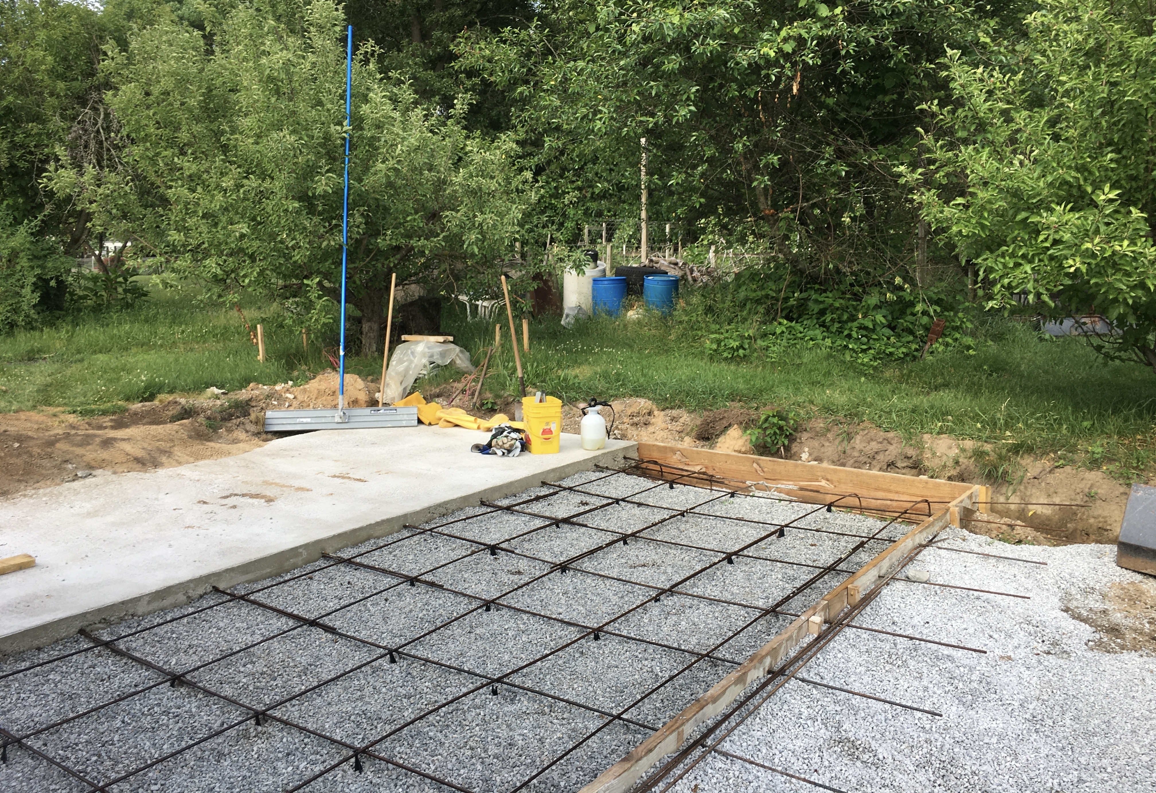

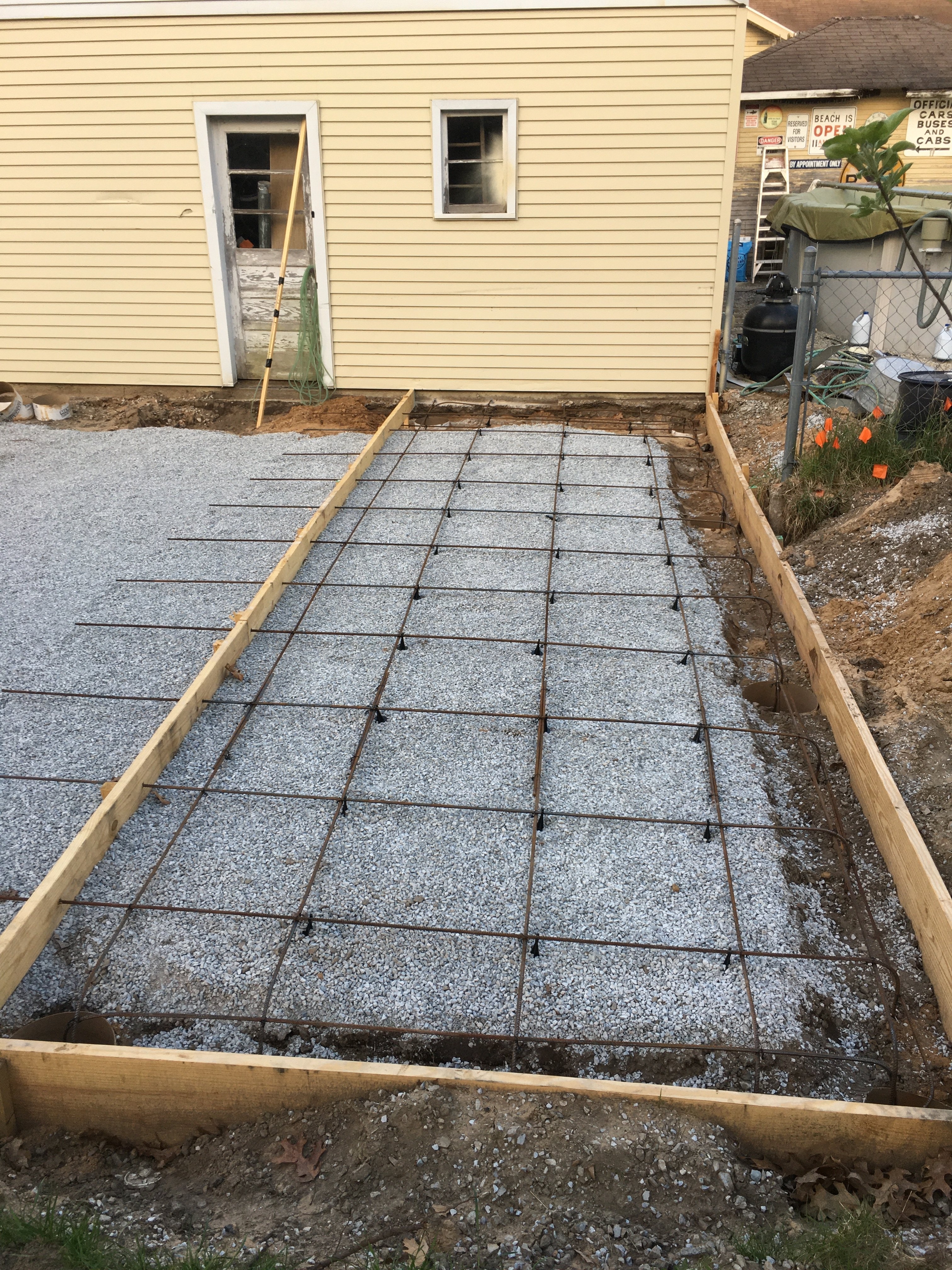

First slab ready to pour...
(click to enlarge)
Second slab ready to pour...
(click to enlarge)
You can see the rebar for the 1st slab tied to the 2nd slab.
I used 2x6 so the concrete is about 5-5.5" thick.

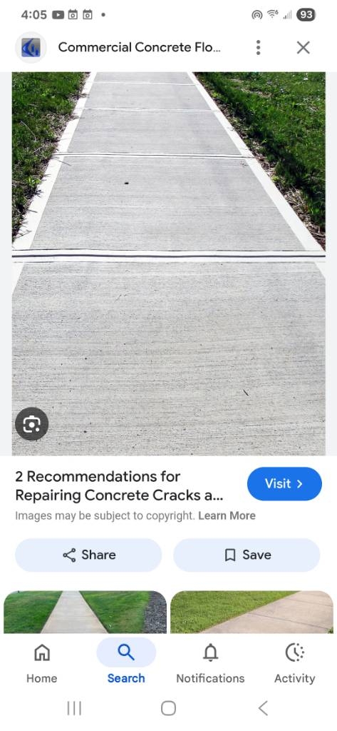

There are two opposite opinions; 1) tie them together with rebar dowels, maybe bonding agent, or a "key way" joint.(structural slabs are like this)
Option 2), dont bond them at all, actually put expansion joint between them, and allow them all to float separately (sidewalk and driveways are normally like this)
For me, I have kinda gone back and forth on to tie or not; but I have settled on my slabs, im going to do an expansion joint between them, and then run a poly bulalyne(sp?) caulk sealer over the expansion joint.
   / How big of a slab could I do by myself? #154
So, as a rough guideline, with exceptions, if it has a footer, you really should avoid cold joints, and have a way to bond the slabs together, rebar, epoxy dowels, key ways, ect
Generic, no footer, not taking point loads, expansion joint and no structural connection (sidewalks, driveways, pool barn floors, ect)

Generally sidewalk, driveways, and non load bearing slabs are kinda treated as non structural, and they typically use an expansion joint between pours.
(click to enlarge)
(click to enlarge)
If you look at picture one above, I had to drill and epoxy pins into the existing garage foundation so the new slab(s) would be tied to the old slab and wouldn't move around. I tied the pins to the rebar in the new slab(s).
