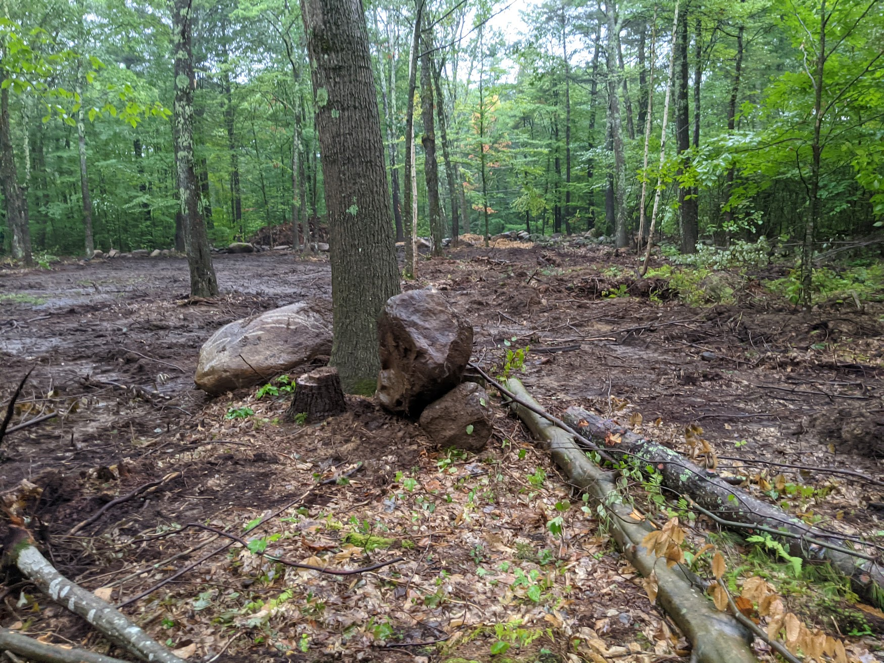

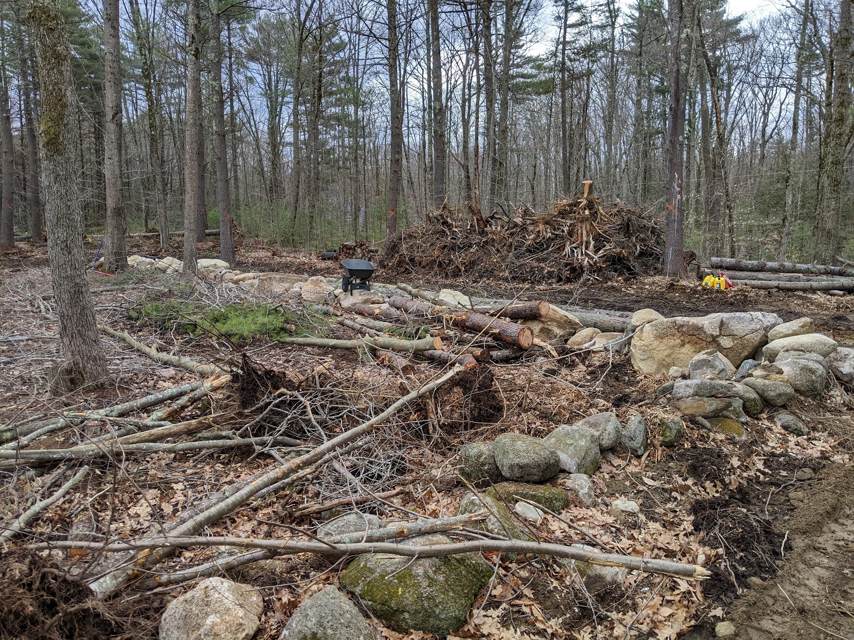

#17
Pics are a poster's best friend. :)
This will give you an idea of what I mostly deal with size-wise. The second picture is of those on the larger end. Of course I hit some outliers that are bigger but not often.

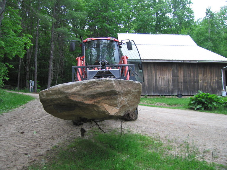

This is with my grapple and 60hp. The approximate LxWxD is 52 in x38 in x 13 in.
This would be about 2400# or about at max for the 1153 loader
