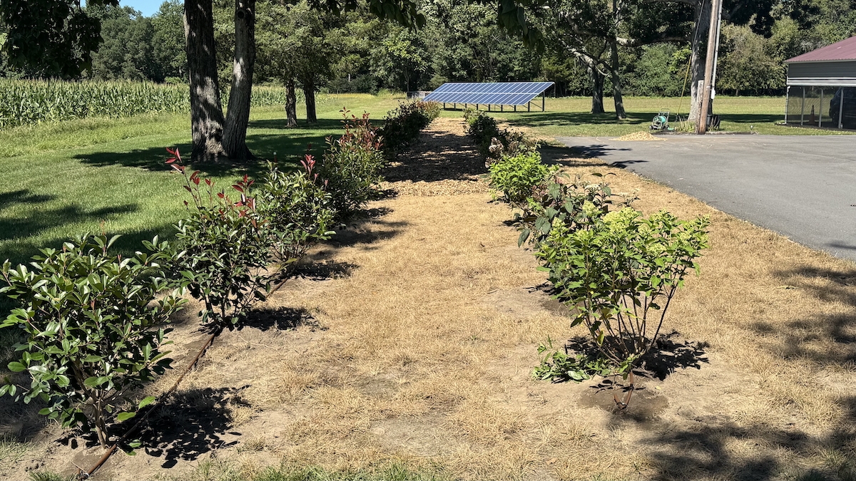

Well we got it done yesterday. Everything went far better than expected. Partly because there were no issues with the PHD, and I had twice as many peolpe show than expected to help (and most of them had experience planting). We had all 61 trees planted within 2 hours.
I had been concerned we might run into some roots from some large trees not too far from where we were planting. My biggest concern with that was that the auger might get tangled/caught up in them, and with no reverse it could be a big hassle getting it out. Well we did run into some, but it just slowly chewed through them.
Got the drip line installed and one load of wood chips spread, all done in time for an early lunch. I was hoping to just get the trees planted by the end of the day...

Back (left) row are all Photinia. Front row is a combination of Viburnum, Limelight Hydrangea and White/Pink Crepe Myrtle (dwarfs).
