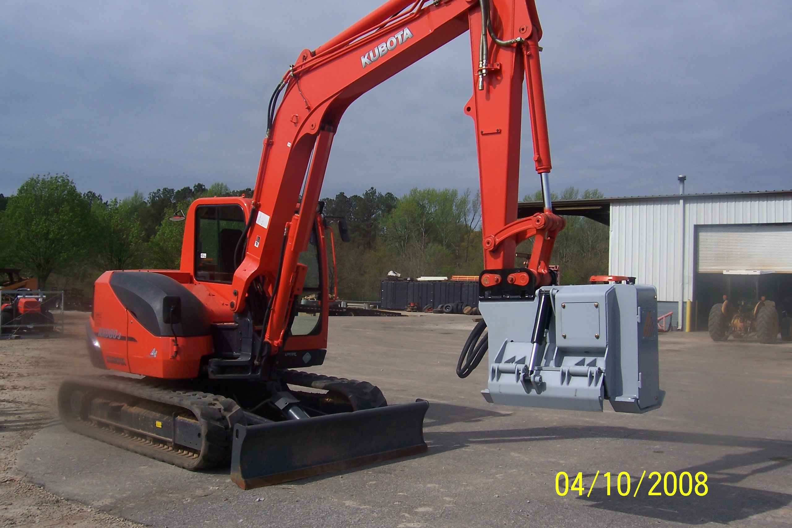

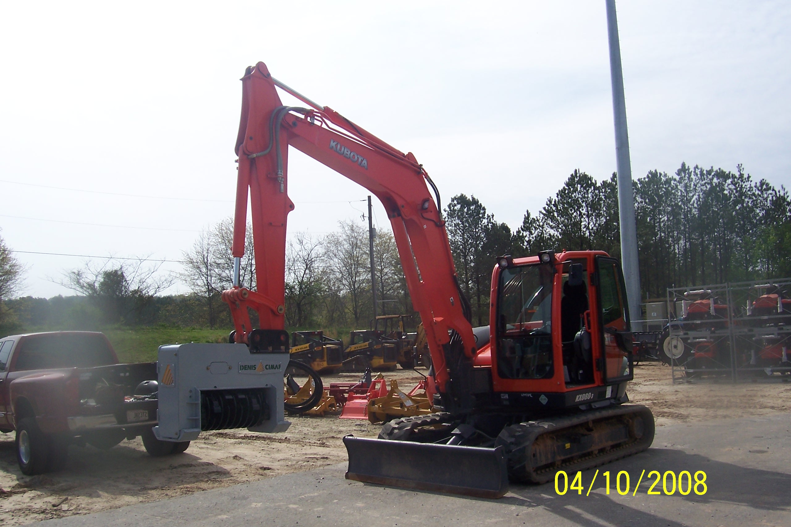

The 080 sized machine is in a sweet spot. Alot of tractor for it's size, good H.P. and flow, and is still trailerable with truck/trailer most of us run. There isn't much above it without going into the next class. Your CAT 320 series and equals. I've tried to pair up a CAT machine to the 080 and with not much luck, CAT has a gap here. JCB has one close and GEHL maybe. Plus maint. and who can work on it are is pretty easy.
I mounted our head on the 080 we are using for the demo and it's a good match. You can feel the weight but not tractor upsetting. We had hoses made Friday and a factory guy is flying in Monday to help me get it up and running. The little head is built like a tank.
I will post pictures and size material cut as soon as possible. Here's a few pics from the mounting party.
