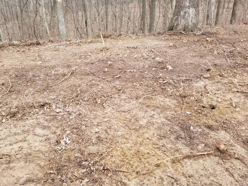

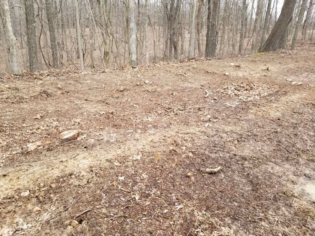

Have M7040 with grapple. I can perhaps work them all out using that. For sure this okd man cut all of that with a chainsaw...and dang near killed me. That stooped over work doesn't work any more.
Thoughts on my option. About 500 foot with uncountable numbers from 6" down.View attachment 545823View attachment 545824
If the cut is still fresh you could spray (or paint) the tops of the stumps with 2,4D to kill the roots. The best is to paint each top with undiluted solution. This will kill the roots pretty quickly and by next season the little ones will be history. The larger (6”) will be much easier to pop out with whatever you use. The secret is killing the roots as quickly as possible after cutting to prevent re-sprouting and continued growth.
Good luck.
