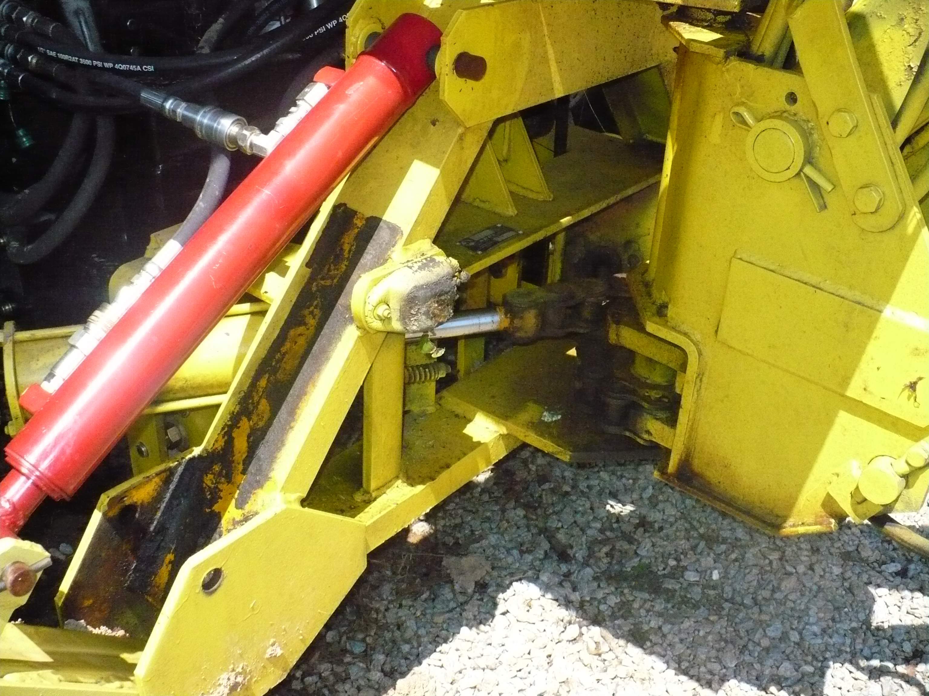

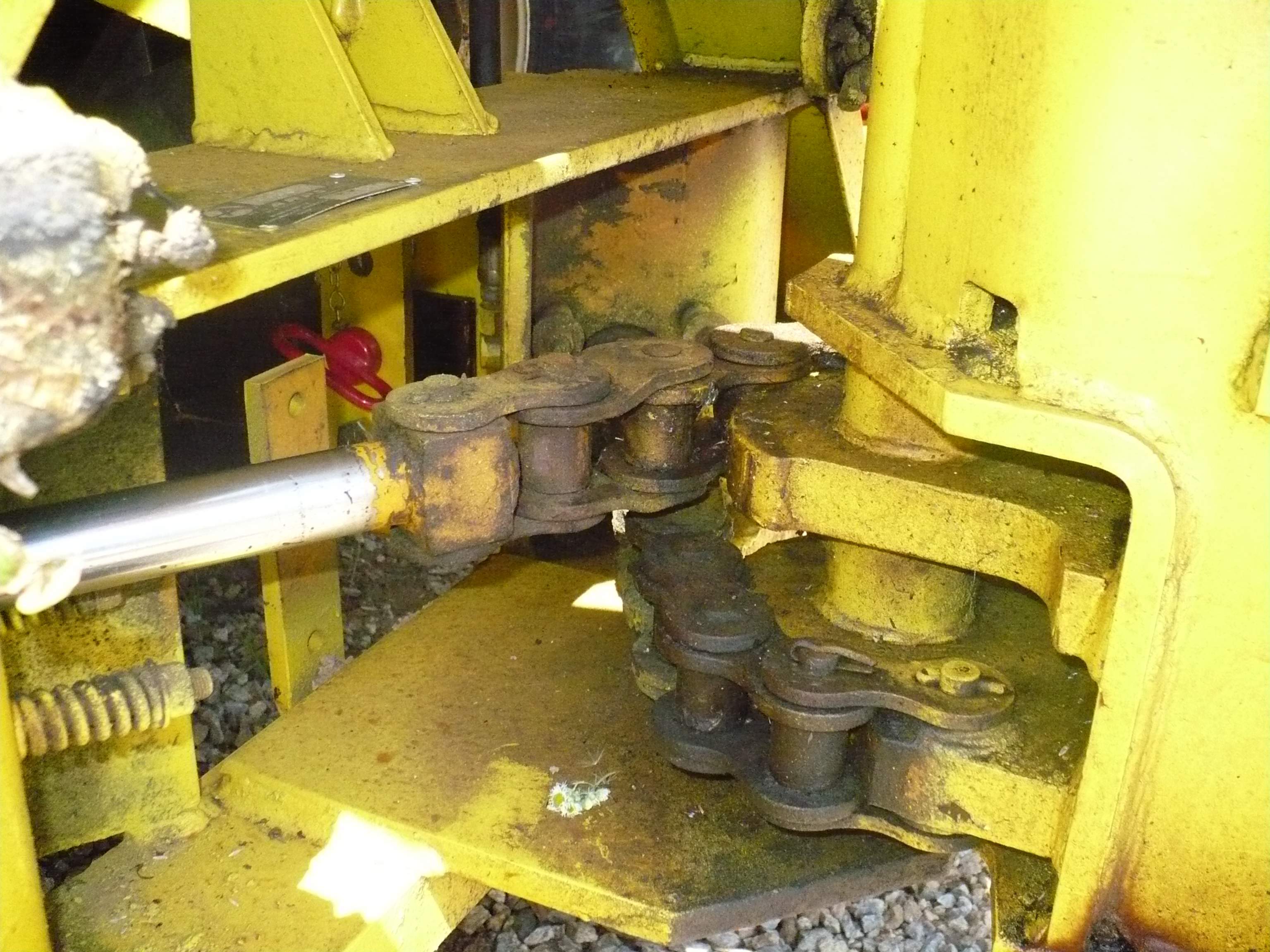

On my old ARPS 730 there are two 2" pitch chains connected to single acting cylinders that pull in opposite directions. They are plumbed just like opposite ends of a dual-acting cylinder. I think the advantage of this setup is constant velocity in both directions.

"I think the advantage of this setup is constant velocity in both directions. "
Brad, I don't notice any change in swing speed through its range with my Case, although I've not actually measured it - it's just not enough to cause me to think about it.
From your pic, I'd say the main advantage to your swing setup is simpler geometry while still getting enough rotation - the design gets much easier if the last foot or so of each "rod" can wrap around like your chains - and even though this means you only have the LESSER of the two forces for any given cylinder (the retract force) that method wouldn't work if the cylinders tried to PUSH as well (ever tried to push a wet noodle somewhere it didn't wanna go?? :D ... Steve

Tho da cylinders with one pushing and the other pulling are also equal speed. And they are both needed indeed in my experience.
My old ford 5500 has dual 4" for a total force of 44k or so as noted above. But that's only a 20" or so stroke cylinder. My how has a reach of about 22' and can swing 185 degrees. Without having a calc handy, that's somewhere around 70' of movement. If the cylinders had a 24" stroke, that's a 35:1 ratio. So now that 44k of swing force is only like 1300-1400 at full reach.
Dads 4500 has a swing chain. So it has dual cylinders that pull only. Cause its hard to push a chain. But it also has a shorter reach.
