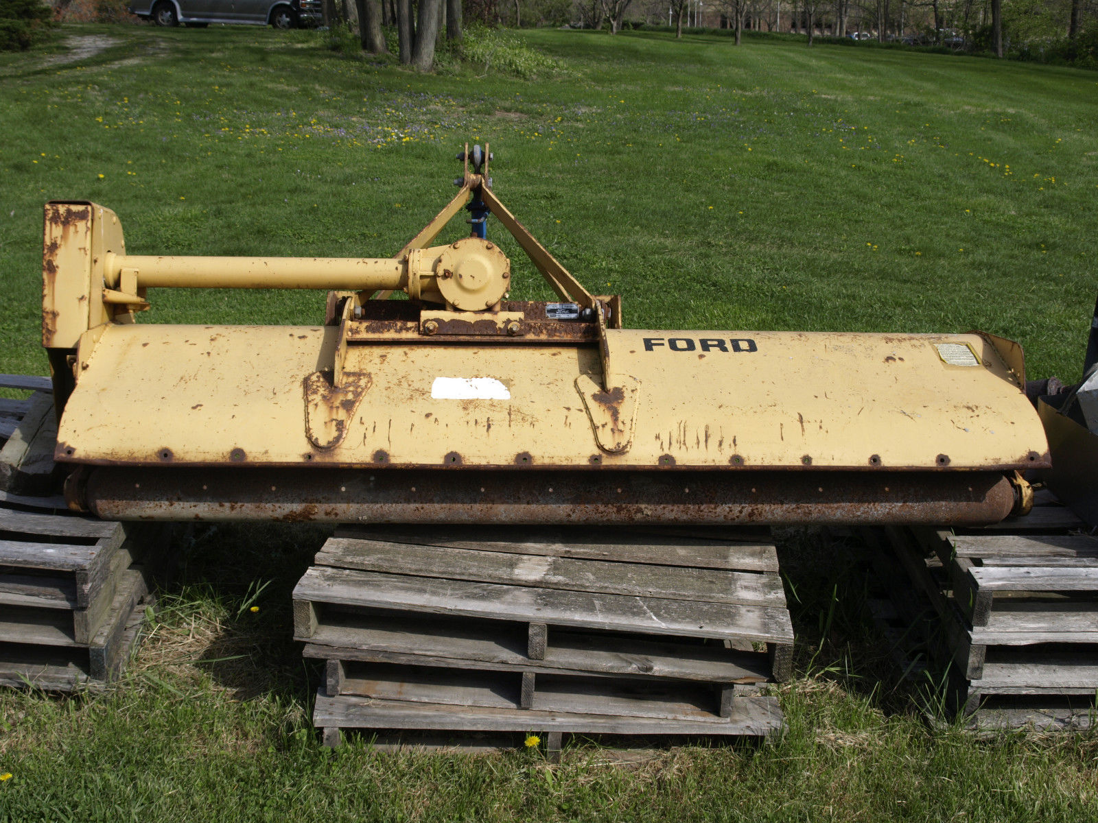

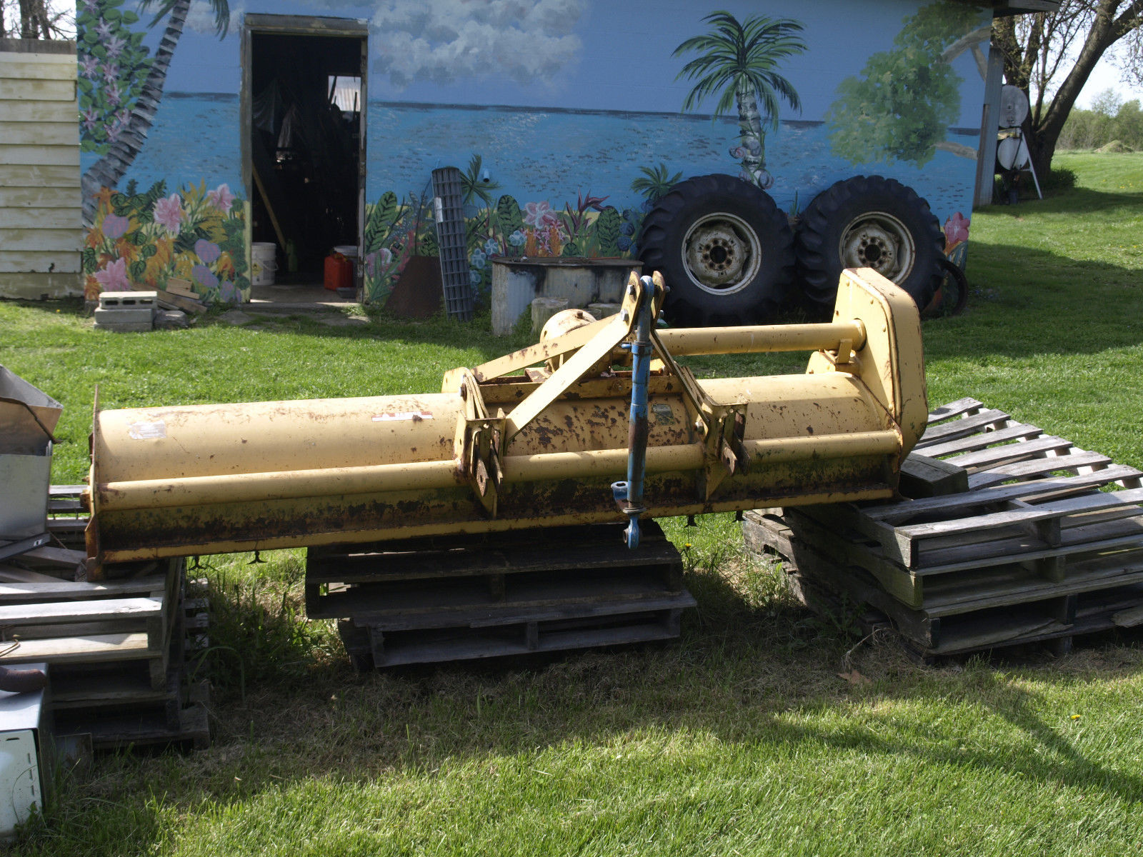

I've read through dozen, nay hundreds of pages on these forums regarding flail mowers. I think I'm ready for one. I see the Caroni is pretty popular on these forums - and it would probably be heavy duty enough for what I need -- but I don't like the 6' width. I've got 40 PTO HP and think I could manage one of the 7 to 7.5 foot ones fine. However, that really pushes the price, since I would need to look at Alamo, Land Pride, New Holland, Phoenix, etc -- all north of $4000.
This mower on ebay is just over 2 hours from me. Close enough that I could go get it, but not close enough to just drive to look at it. It's an old Ford 917H. 88" width. It looks like the rear rubber? skirt is missing. Comes with new teeth. Anything jump out at you regarding problems with this mower in particular or that model in general? I emailed asking about the PTO shaft, waiting to hear. Starting bid is just $350.

You might just have a gem there or a carcass with lots
of good spare parts you could sell.
It is a tough call unless you are willing to drive and spin the
rotor with the belt off and then smalls the shroud at the
welds to see if they either come back with a solid vibration
or a dull thud which tells you the welds are rusted.
You could always sell it for what you paid for it as we have
a large number of 917 owners on the forum.
The thing is the the rotor is not exposed for a photo
so thats a real negative.
If you want a used unit for your mule you should look at
tractor house as there are a lot of good used units
for sale by "owners" and new units for sale by many dealers.
I dont want sound like an ***** hat and pee on your wanting a flail mower its just
50-50 proposition.
OH dont worry about the PTO shaft as chances are he or she has it on another mower.
The rubber flap is easy to replace or buy new too.

Actually what you're missing is the entire rear metal deflector. You shouldn't be able to see the roller from that camera angle. The deflector is what directs the clippings downward from the knives. Otherwise they're at the mercy of the winds. A rubber or composite shield then attaches to the metal shroud. I operate mine without the rubber, no problem. But without the metal deflector, the stuff flies every where. I took my deflector off as an experiment to see if I could cut with faster ground speed, and put it right back on within the hour. I had to hose off a significant amount of clippings from all five sides of my tractor cab. It would be misery to try this on an open station tractor. Get the deflector, or pass on the deal.

Thanks for the photo, saved me from going out to the pasture with my camera. Three things are missing from the OP mower; the most critical being that quarter round deflector shield that bolts to the main housing. To that then attaches a full length strip of angle iron, and then the rubber curtain fastens to the angle. You can get by without the angle and the curtain, but definitely don't want one without the quarter round deflector shield. Unfortunately I don't thing you can actually buy the quarter round section by itself. Pretty sure it's considered part of the main frame. You could have one fabricated, but it would be pricey.
Again, I'd pass on this machine unless you're a metal fabricator. FWIW, I originally got mine at a farm auction for $150, and it included the quarter round deflector. No angle, no curtain, but I eventually concluded I didn't need them. Broken welds and torn metal on one end of the quarter round though, vibration was only going to make it worse. Had a new end cap fabricated for $75. After that it was new knives/hangers/brackets/belts/PTO shaft. Eventually I had an operational (and safe) 917H. Total investment ~$550

Thanks for the replies. Looks like it would be pretty pricey to replace the missing parts. I'll look for one more complete - and haven't ruled out new completely. (Just hate to spend the four grand.)
