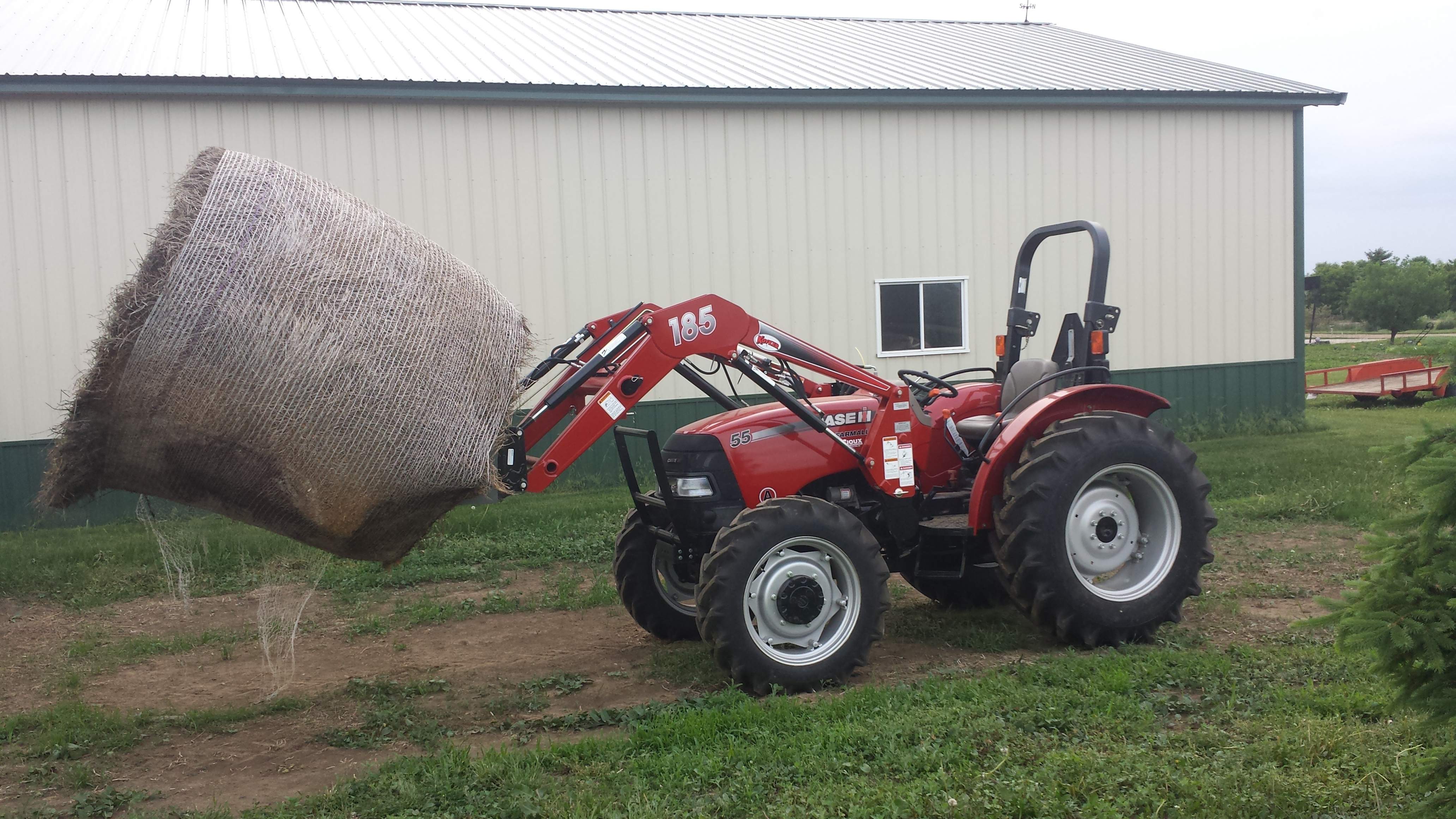

#16
Nice to have a fully functioning tractor again!!!
