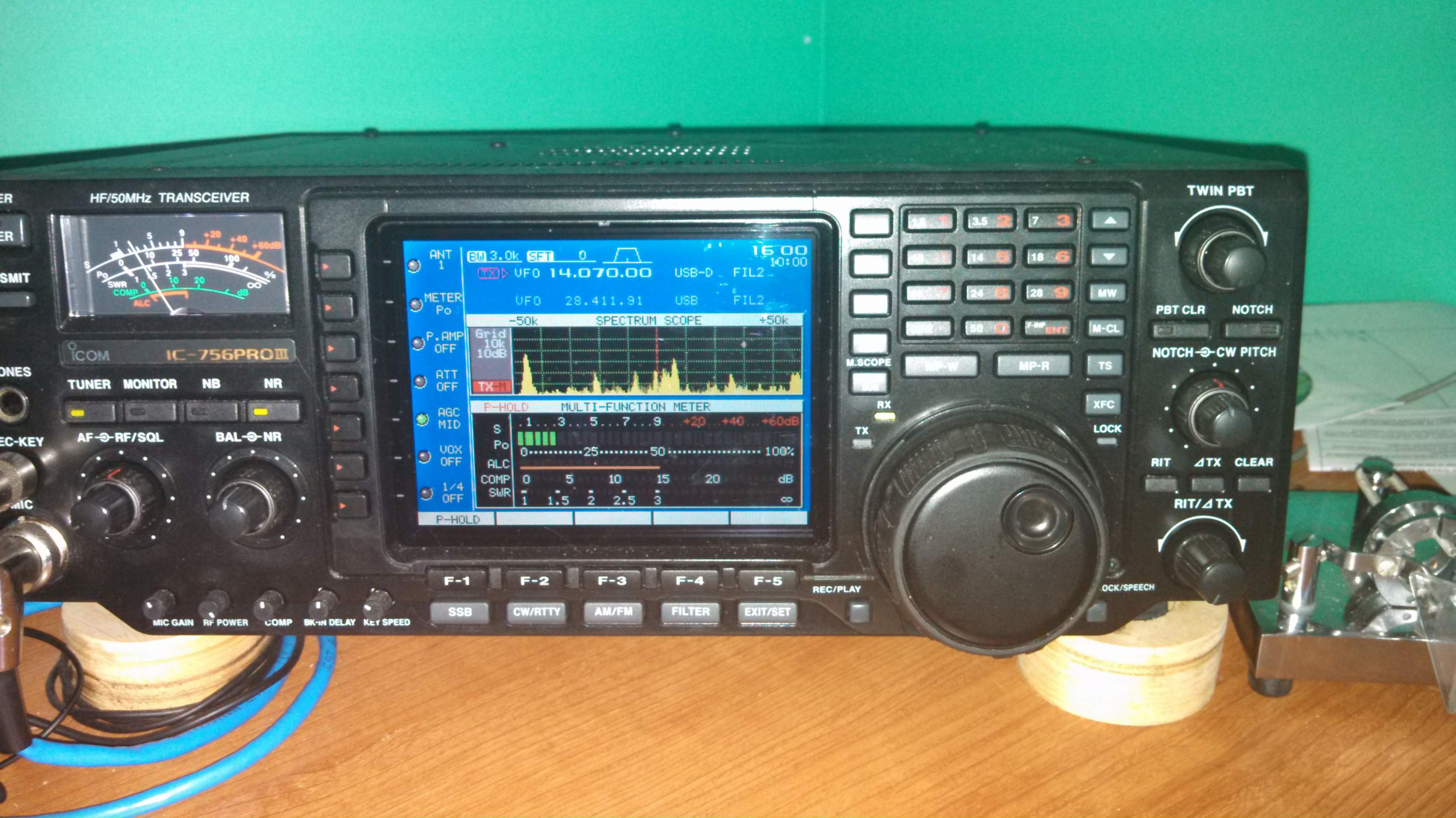

My Icom 756 PROiii with my OCFD outside wire antenna works very well on the AM broadcast band, (and many other bands:))
But seriously you cannot compare most simple AM tabletop radio's with a 3 inch ferrite loopstick antenna to the much more expensive and much better engineered mobile radios with tuned RF stages and an external antenna. Just like you cannot compare a car radio to my Icom 756 PROiii .
If you are serious about AM band long distance reception, you could get one of the many old fine Shortwave radios produced in the last 50 years and put up a good outside wire antenna. I am speaking about old Hammarlund, Hallicrafters and National receivers.
