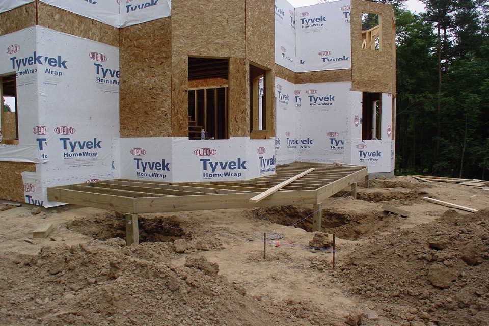

That's what I wondered at first too, but in the end it really doesn't matter so I did my thing with the porch deck after the framers did the roof and the mason will come later to brick up under it all. I plumbed my framing to the ceiling framing so it all lines up. I set the deck framing on temporary supports and leveled it all up where I wanted it. We established our final grade line today so I dug the footings and marked for the concrete height from the deck framing. I'll have the mason build the piers an inch shy then lower the deck down for a little pitch away from the house. He'll know exactly where to put the piers since the framing is already there /w3tcompact/icons/clever.gif It could have gone the other way too with him taking his plumb lines from the roof framing as well so I guess it's just a matter of scheduling/convenience /w3tcompact/icons/smile.gif

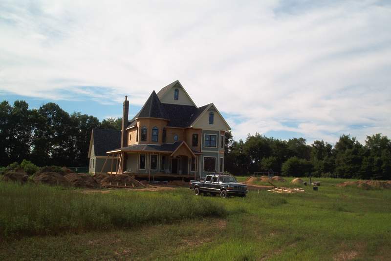

Heres the latest pics.

Here's the back with the garage done.

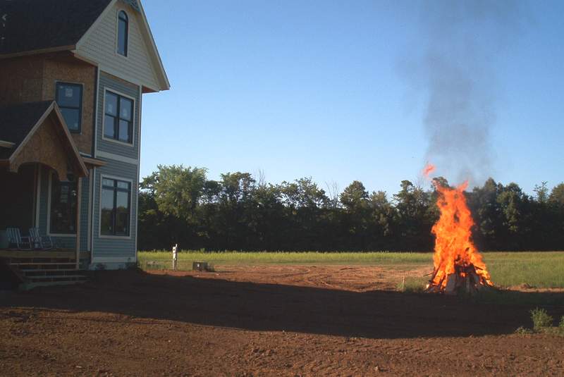

Are all guys pyros? My wife just doesn't understand. Here's my last big burn of scrap from the construction. Our burn pile sits where the drive will be going through so any day now this will no longer exist. I celebrated with one of my biggest fires yet /w3tcompact/icons/smile.gif

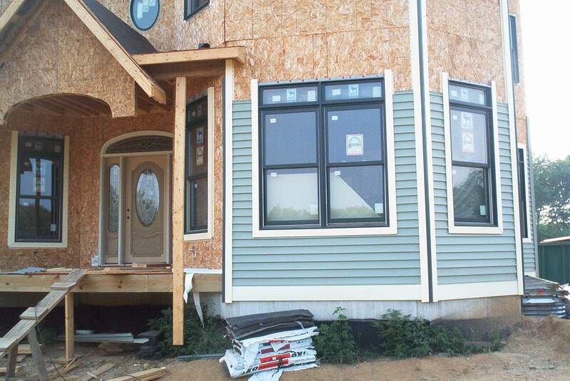

I took som pics of the porch area for you. We have a stack of cinderblock since they will be putting a cast stone surrond on it so add the "look" we wanted. But I tell you we are real close in style but yours is allot bigger than mine.

Ok here are the pics, forgot to resize before posting.
