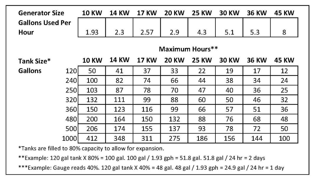

Upfront: I would do the math on how much power you need for your generator, and I would look at your meter during some cold days in January to see what your peak load is. I would then check to see how the house is wired, to see what you would give up if you only backup one panel. Finally, remember that the 500 gallon propane tank won't supply a large generator and won't supply your 24kW for that long either.

A site with some good information and a simple chart for fuel consumption of propane generators.
CES | Backup Generators | Combined Energy Services
So a full 250 gallon tank would be good for 3-4 days possibly 5 for many people, rationing the run hours would lengthen that considerably.
