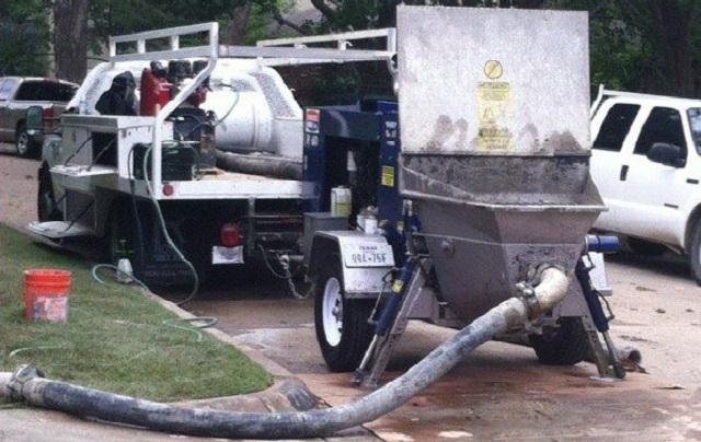

   / House Build #5
Here's a picture of what I was referring to in my post above. You should try contacting a rental yard or some of the concrete or masonry contractors to see what they can do.

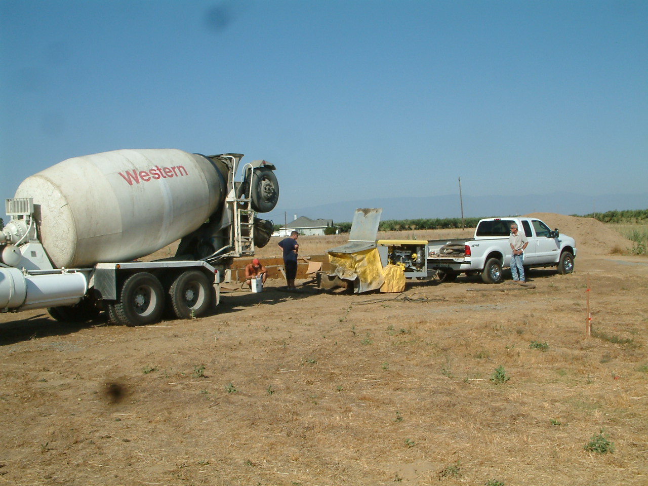

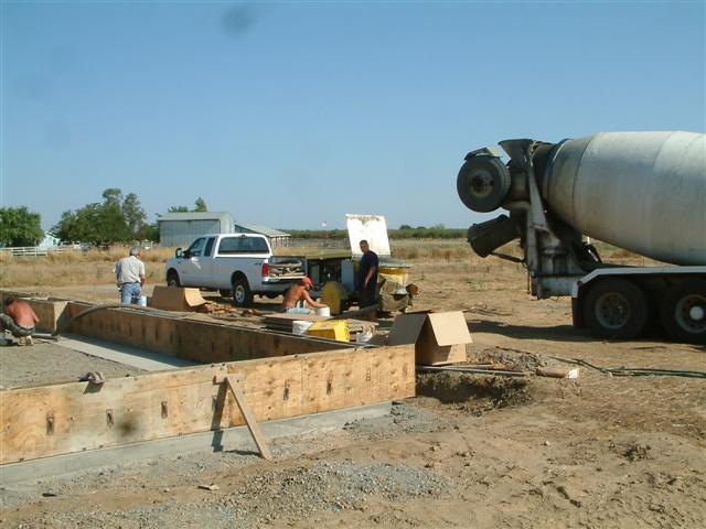

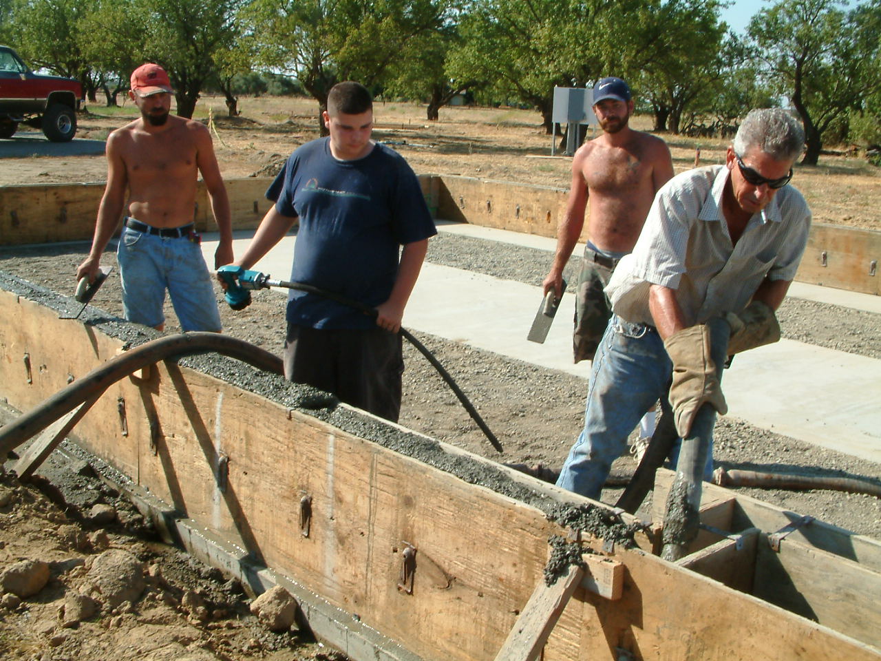

Here's how the stem walls were poured for the foundation of my manufactured home in 2005.
The contractor used an trailer mounted concrete pump. Worked like a charm. Took about 2 hours to make the pour.
