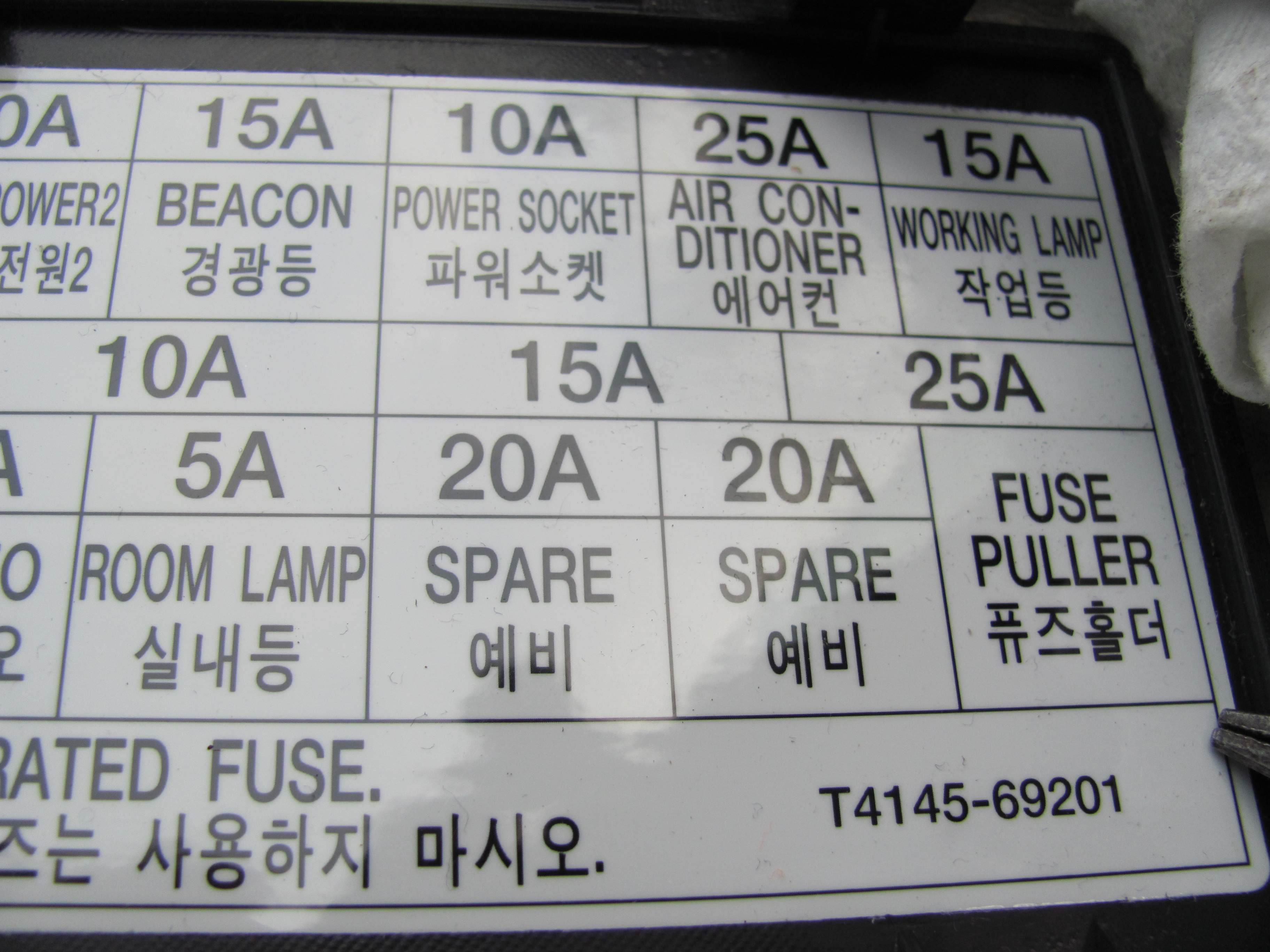

Could someone please tell me how to get wires connected to the back of the spare fuse slots.
DK45SE. Thanks
/ Hot wire for add on work lights? #10
DK45SE. Thanks
There is a difference between an unused fuse and the 'spare' fuses (usually two) in the fuse block.
The two 'spare' fuses really are just that. They do not and cannot connect to anything, they are just to be handy when a fuse needs replacing.
May have read your question wrong, my apologies if so. :thumbsup:
/ Hot wire for add on work lights? #11
There are spare fuses but also two spare positions with the lugs in place. I need to get the lugs free to attach wire IMG_1450.jpgIMG_1451.jpgIMG_1454.jpgIMG_1455.jpg
/ Hot wire for add on work lights? #12
There are spare fuses but also two spare positions with the lugs in place. I need to get the lugs free to attach wireView attachment 368795

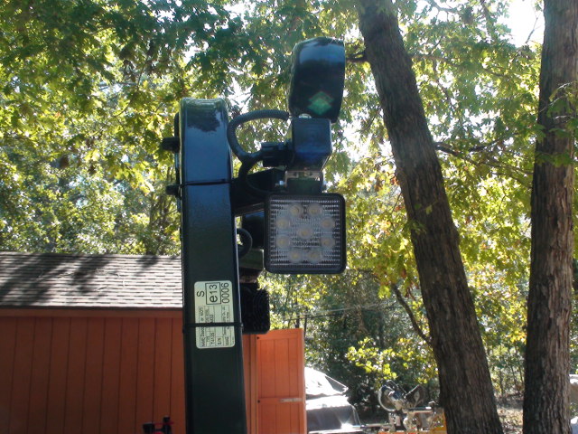

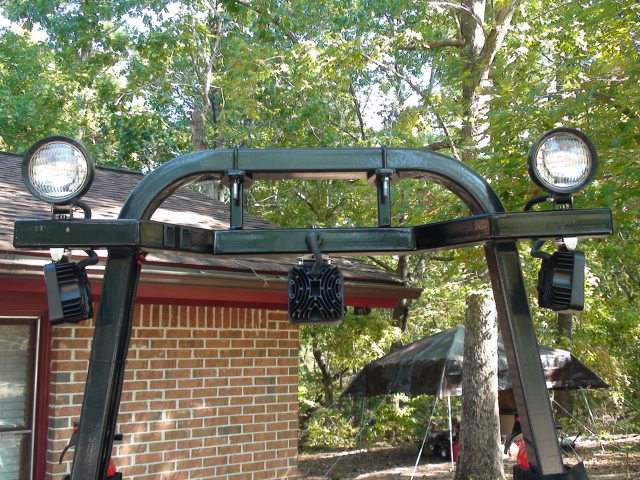

This thread is getting a bit old but I wanted to respond. The work light wire on my DK45HSE is only about 18 gauge and due to voltage drop is not enough to power any lights to capacity other than some low current LEDs. I run all of my wiring for anything directly to the battery, connections soldered and fused.
When I installed the MIE light bar and added 27 watt LEDs along with the standard incandescents, I ran a new 12 gauge wire directly from the battery to the light bar and also rewired the light bar (with 14 gauge parallel, if memory serves) as I did not want the voltage drop of the smaller stock wiring. I also added the 12VDC power receptacle to support ~20 - 25 amps with 10 gauge wiring and a good quality marine outlet.
/ Hot wire for add on work lights? #13
I agree with sdef; I'd run the power directly from the battery with good gauge wire and use a relay tied to the ignition or the auxiliary plugs to switch the lights. This way you get full power and don't risk overheating wires causing melted wires. a short or a fire.
