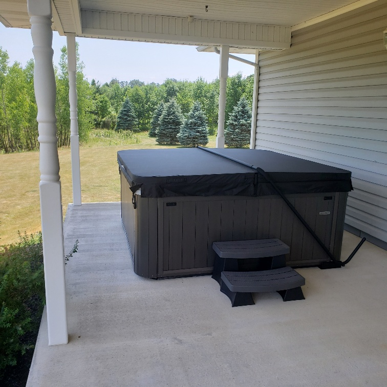

Thanks Dodgeman. I have put the numbers out to an engineer/builder at this time as well. Hopefully, he can run the numbers and tell me if it is good or if I should start considering plan B.

Apparently, the engineer said that based on the drawings it would be just fine. So now I need to find a hot tub that won't require my left kidney to purchase. Looked at Jacuzzi so far as that was my closest dealer.

I was very fortunate that a family member happens to work closely with a builder/engineer who builds owns a company that can design/build pretty much anything when it comes to buildings. It probably did save me a ton of money which I'm very happy about.

Having worked at an engineering firm for 37 years and with some structural engineers, a lot of them wouldn’t want to mess with a job like that. If they did, they would qualify there results. You know, assuming the original plans were what was built, assuming there is no corrosion in the rebar, assuming the concrete is really 3000 psi etc. From a calculation stand point I think it’s a fairly simple problem. Enjoy the hot tub!

Follow-up: Ran all the numbers by the engineer again for the final tub specs since we ended up with a 400-gallon hot tub. Even after being given the green light, I was nervous, but it has been filled and tested. About $1K to wire it up per specs for a 60 amp/240 line so we can use both pumps and heat at the same time if needed. Took about 6+ months which seems the new norm around here, or at least for hot tubs and tractor implements.

Four hundred gallons of water is about 3200#. Add say 800# for the tub or 4000# total. The pic of the tub looks to be about 8’x8’ or 64 SF. That results in about 64# per SF of bearing area. That is not much of a load.
A party with a bunch of people on that deck could exceed that.
