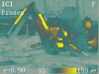

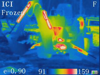

Took an IR photo of my tractor after digging about 30' of trench. By "digging" I mean wedging your BH under rocks and roots, listening to your relief valve sing and flopping the FEL against the ground. I was flailing.
It was a little over 90 here and the cylinders are about 160 deg. No telling how hot the innards of the HST get. The rule of thumb that the hydraulic fluid runs about 100 above ambient looks pretty valid at this point.

Very interesting photos...Thanks for sharing!

Thats cool, what kind of camera are you using? Something like that would be excellent for electrical panels.
/ Hot Dog
ICI toughcam. Yeah, if you dial it in close enough (minimum span), ALL electrical panels look scary. :)

Cool photos :cool: , thanks.
