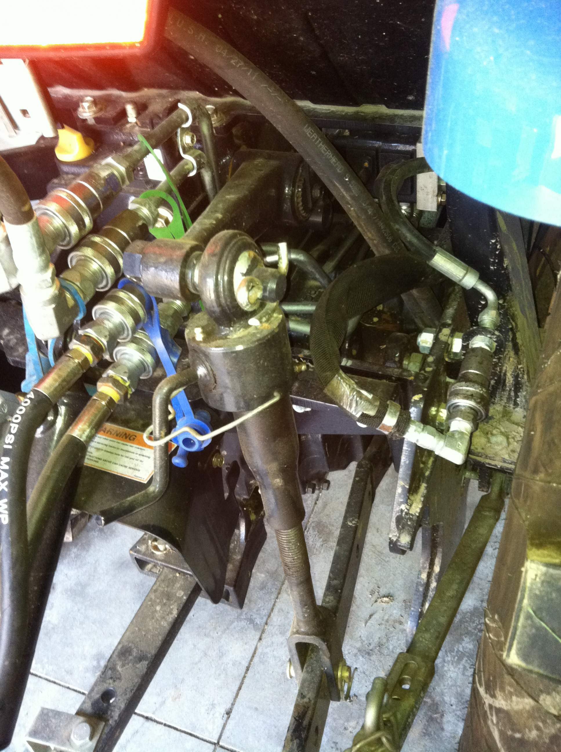

Make any difference what size hose I use?
Cat II 3pt. 3" cylinder. As short as these hoses will be cost is not the deciding factor.
So 1/4", 3'8" or 1/2" ?

Mine are 3/8" and I should of used 1/4". I'm putting a needle valve on it to slow it down.
