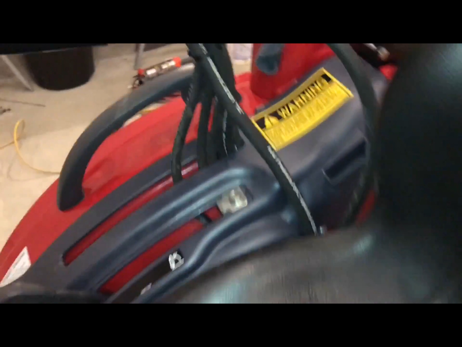

Ok thank you for the input. I've posted a few 2' videos that I won't bore you with here but I did snap a few stills of some areas of concern.
This shows an area along the frame where hoses have been added for the 3rd function. I have zip tied them away from all moving parts but they are touching the frame etc.
This shows the lines coming off the top and tilt controls. Is this an issue or in need of protection?
This shows the two lines that go to the 3rd function. I can run these inside the loader arm like the rest of the lines. Note the factory lines are in the nylon sleeve for protection. I could add the nylon sleeve prior to running them down the frame. Is that needed?
Thank you for the advice.

Any area where hose encounters a sharp edge needs a heavy duty hose protector if you cant route it to avoid these areas. Hoses flex and move with applied pressurization so any rub area will wear thru the hose pretty fast. An old water hose or other thick rubber is excellent protection for these areas but even those need to be checked from time to time to make sure that they aren't worn thru.

Ok thanks for the input. Sounds like I should do a bit more to protect some of the lines.
