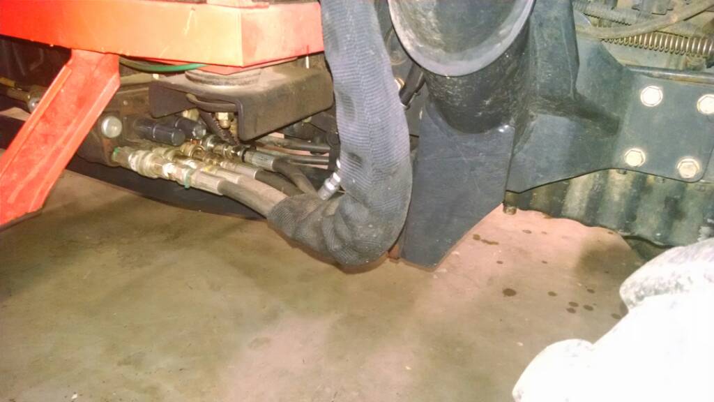

Anybody have any loader hose protector fabrication to share. I hate seeing those hoses and fittings so exposed. My father in law knocked one off one day and I've been determined to make some protector ever since. Any ideas uploadfromtaptalk1456888524422.jpg

There appears to be a steel bracket above the hoses. It shouldn't be hard to build a box around them.
   / Hose protector #3
Discarded fire hose from fire station.
   / Hose protector #4

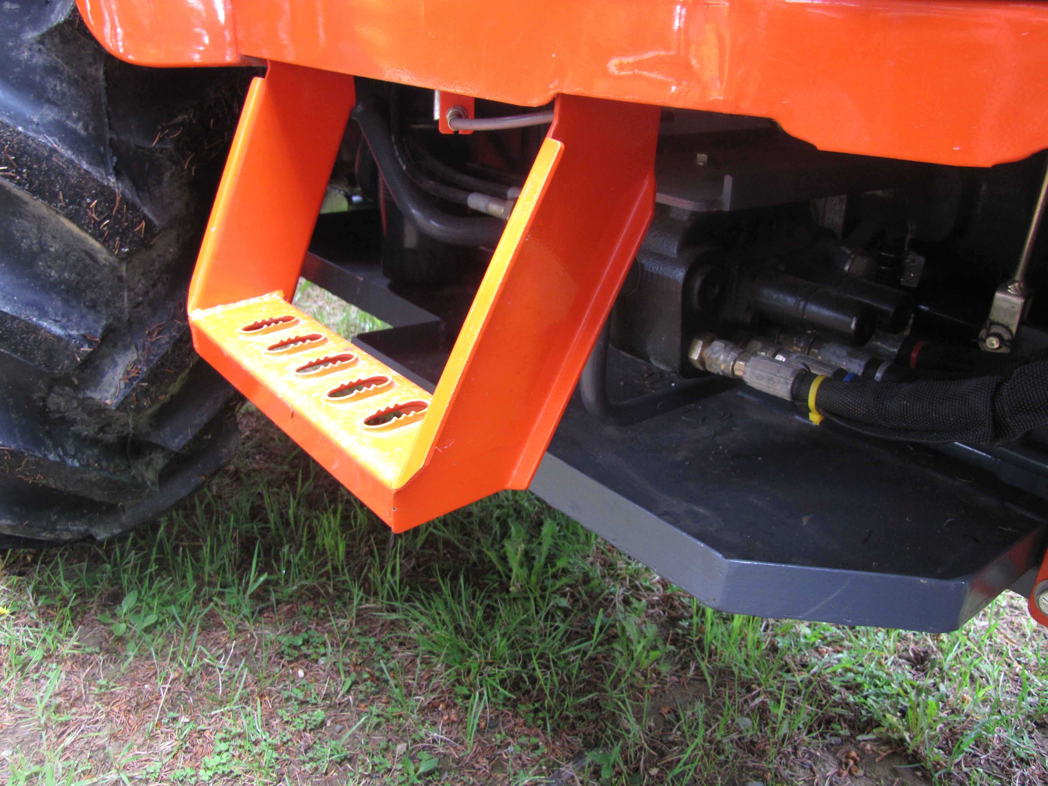

At that location on my Kubota there is a skid plate under all the hoses/connections with an upturned portion on the front that extends up about 6-8 inches. Its probably there to do exactly what you are talking about.
   / Hose protector #5
fire hose. and for single 1/4" hose. You can get hose called patrol hose, Its like a garden hose that lays flat..

i made this little skid plate for my CK35 and protect good so far even in wood
   / Hose protector #7
Nice looking skid plate. Are you able to mount and remove the backhoe with this plate installed?
I am very interested, could you possibly take some more pics showing how you attached this plate.
   / Hose protector
X 2. That skid plate looks very nice. More pics would be greatly appreciated
   / Hose protector #9
Not only does that skid plate look very nice .... that looks to be one clean tractor!
   / Hose protector #10
What is the extra wrapping on the hose?
